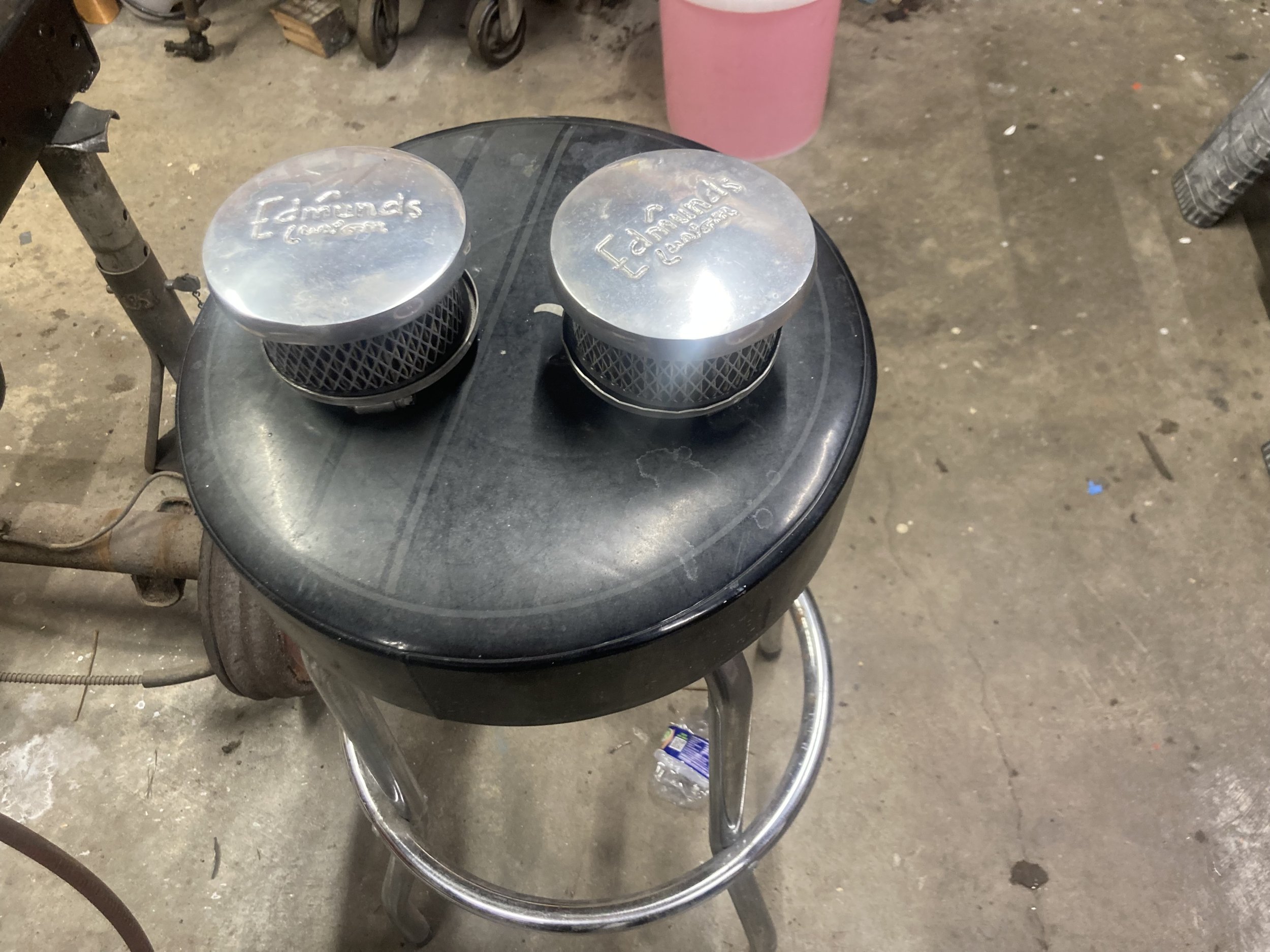

    After reading Larry Kirwans thread about Big 97 Stromberg help and the thread about air filters for the 97s.
    It got me thinking that my air filters may be contributing to the engine running rich
    Im running two Edmonds customs
    not sure how restrictive they are, but at least maybe replace the inserts with KnN foam filters
    What do yinz guys think

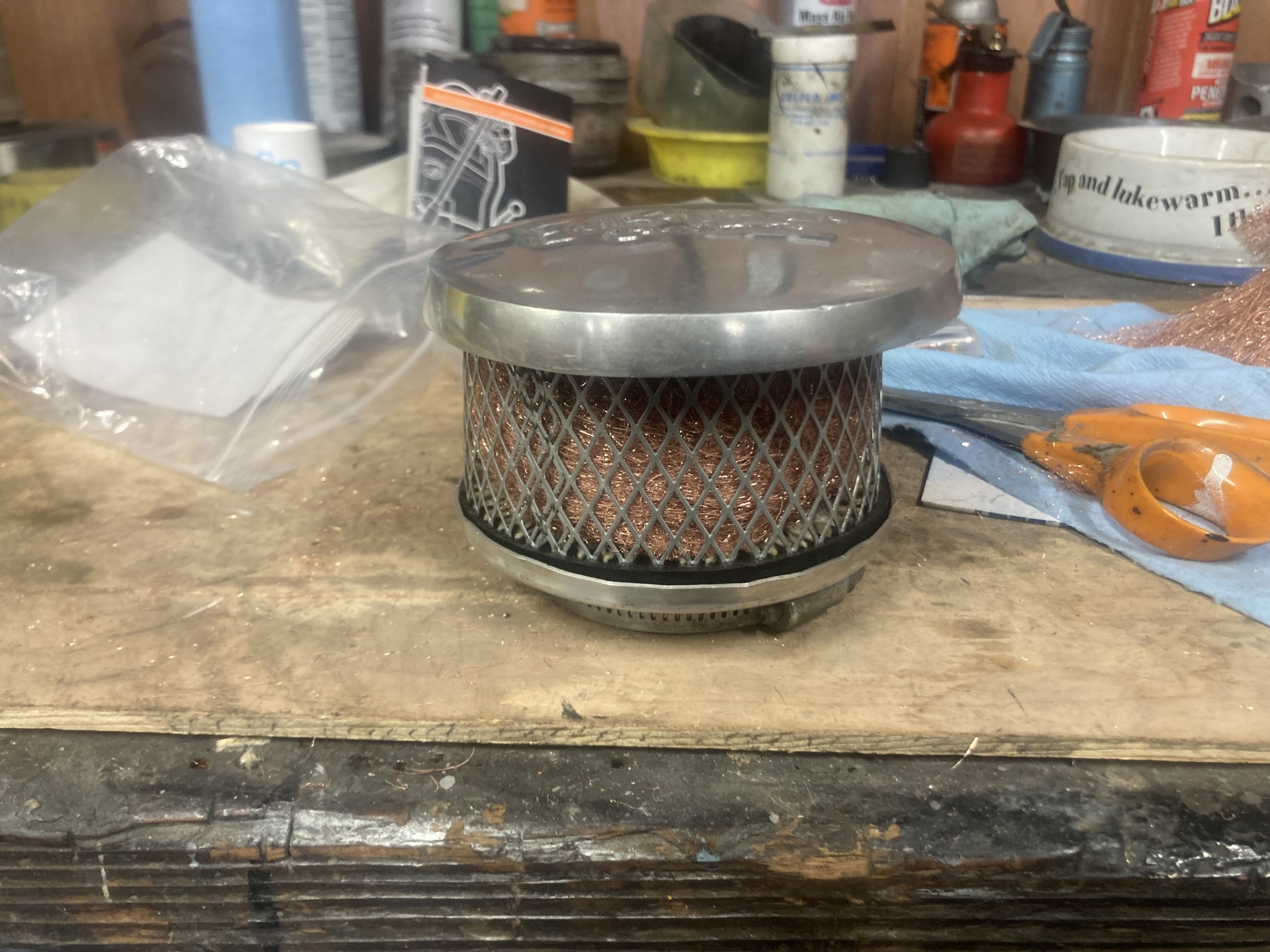

    They make an overall difference. I final-set the carbs on these oldies after it's on, sometimes it's a huge difference. Copper wool, maybe 2 layers, light oil once or twice a year.
    And I think it looks kool...;)

    I like the idea
    I’m looking into putting the copper wool into frog style scoops with wire mesh in the inlet to the carb and another in the inlet of the scoops
  16. CSPIDY
    Joined: Nov 15, 2020
    Posts: 968
    CSPIDY
    theHIGHLANDER likes this.
