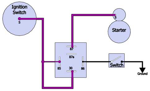

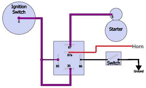

    Can you guys confirm for me if this is the correct and safe way for me to wire in a kill switch to my starter? I see so many variations, some of which include fuses even with the relay. I am REALLY green when it comes to electrical, so appreciate your help. Also, I'm not trying to start a debate or discussion around the merits of kill switches or which systems are wired to kill. Just want to make sure I'd be doing it safely. The Ignition is a GM and I assume if following this diagram I'd be cutting the purple wire coming off the starter? Also, assuming this wiring is right, if I wired in the wire going to my horn to 87a, would that cause the horn to sound upon trying to start the car when the kill switch was open?

    Hi. Assuming that the #85 - 86 terminals are across the relay coil & that the #30 - 87 terminals are the relay contacts that will do it. Jimmie
  4. That will be good.
    The horn is triggered off a completing to ground. So the 87a prong won't do that.
    87a is closed to 30 until the relay is triggered

    Wired directly to the horn it would and you could probably crank your car by closing the extra switch and honking horn, LOL. Would'nt recommend that last part though, might be more than the horn relay could handle.

    I agree that your diagram should work for starting security, but not for an alerting alarm.

    Make sure that relay can carry 400 amps for the starter.
  11. Pretty sure that's just for the purple wire. At least that's what I get from the S terminal on the starter and reading the post

    Yes I just want to place the relay inline to the purple wire coming off the starter. What capacity relay is needed for that?
    On the horn, I thought it would be cool to get the horn to blare if someone tried to start the car when the kill switch was open.
    I don't want to use the coil wire.
  14. You could add another horn and it's own relay do it.
    Turn ignition to start without closing extra switch it's gonna honk the horn, only question would be current capacity of the ignition switch but since OP mentioned a Gm switch it should be fine.

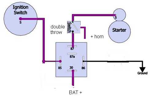

    24's idea will honk the horn but prolly also fry the ignition switch start position without another relay. Horn's generally take 30+ amps. Another possibility is to get a 30amp double-throw kill switch (or lesser amp cap with another relay) and wire it up like this. Jack E/NJ switch.jpg
  18. That don't really show how it triggers the existing horn relay does it?
    You'd need to add another horn and relay or redesign the entire existing horn circuit
  19. Jack E/NJ
    Joined: Mar 5, 2011
    Posts: 959
    Jack E/NJ
    from NJ
    31V>>>You'd need to add another horn and relay or redesign the entire existing horn circuit>>>
    I think the horn relay is bypassed and connected directly to the horny hot. Prolly not a good idea without another relay. I agree a separate horn would be simplest. Or maybe disconnect and dedicate one of the two horns to the theft circuit. Leave the other horn alone. I'd like to see the vehicle he's trying to protect. 8^)

  20. 24riverview
    Joined: Jan 13, 2008
    Posts: 1,117
    24riverview
    You'll notice I mentioned that the current capacity of the GM switch would be the only question.
    Horns do not require a relay to operate IF the switch can handle the load but nothing has been designed that way for decades.
    I assumed (dangerous I know) that the OP probably had a aftermarket harness using GM components and wiring sizes, generally 12 gauge on the start circuit and 14 gauge to the horn(s). I just went out in the cold to do a little testing on the only GM I could access the wiring easily. Results- 15 amp draw on the start circuit (with a slightly higher spike at first), 4 amp on a single horn. Obviously the best thing the OP could do is check the amperage difference on his own system first.

  24. Your initial idea wont work.
    Guys,with all electronics you need to have the schemetic to understand the order.
    With that said heres the breakdown of the relays terminal assignment
    30 = Battery terminal
    85 = Ground terminal
    86 = Ignition Terminal (Trigger)
    87 = Solenoid Terminal (Hot while engaged)
    87A = Hot at Rest (Generally not used)
    So as one can see tieing 85 and 30 together would NOT be a good thing.
    Its a low amperage relay. I would guess about 10 amps
    Personally I would go with the flow and install an on off toggle switch on the purple wire and hide it.
    Hope this helps.
