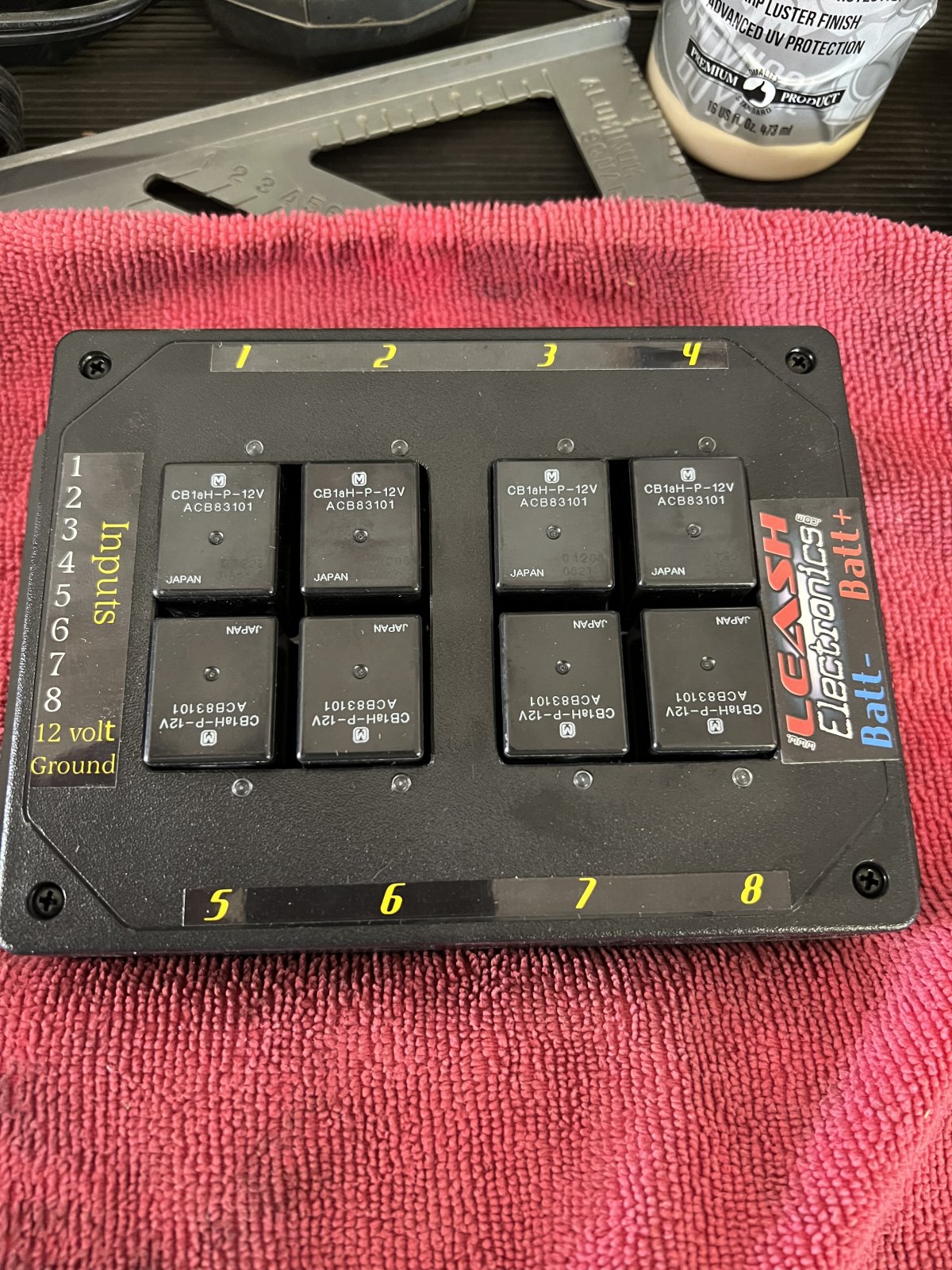

    I got a relay board from Leash Electronics to make wiring a little easier. One hot from the battery and a ground from the battery. Fuse it to the amperage you need for what you are running.

    How do you like this one?
  27. Jkmar73
    Joined: Dec 1, 2013
    Posts: 158
    Jkmar73
    from Tulare, CA
    It worked out really well and I would use this setup again. Relays and fuses are in one spot. Don’t have to hide them in some out of the way place. The board is really well built.
