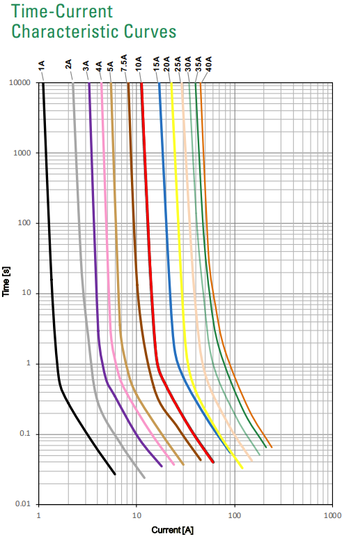

    Well... Fuses also have a "delay", it takes time for them to heat up to their melting point, and it varies with how far above the rating the current is. Looking at this data about the common bladed fuses found in many modern cars they can last >10 000 seconds (~three hours) slightly over the rated current, but at double the rated current they are supposed to blow in tenths of a second.
    Different fuses have different caracteristics, some are available in different types from slow blow to very fast. You are quite right that such data can be very important when designing a system, as the wrong type may blow before a electric motor has reached normal operating rpm, or not blow at all despite there is a fault.

    Yeah! Such an archaic design. Why can't they just trip at a fixed limit? No matter the timing? Makes a lot of sense. Welcome smart switches :)

  11. Such overcurrent devices exist, but they're far more expensive than pennies per unit. Fusible link-style (AKA fuses) overcurrent devices are prevalent because for the cost, they're by far the least -expensive option. As well as being the most reliable and generally the most accurate. The more complex the mechanism, the more opportunities for failure/malfunction exist.
    That graph also represents the ideal and to the uninitiated who isn't aware of all the other factors at play may lead some to wrong conclusions. These are mass-produced bits, so manufacturing tolerances also apply. This is one reason almost all overcurrent devices have their actual connected load lowered to 80% of the overcurrent device rating. Virtually every circuit (not just motor circuits) has current inrush, that 'slope' is what prevents nuisance tripping. Even a single 1157 brake light that draws about 2.2 amps will have inrush of over double that amount.

    It’s just an older way of dealing with a problem. Technology advances. The slew rate of that fuse plot is not by design, but by the materials property. It’s a nice consequence, for sure.
    To your point, automotive-store bought fuses are relatively inaccurate, unpredictable in their behavior around the failure point and expensive for what they are — all because they are mass-produced, batch tested and sold in limited quantities to the consumer. This is all in comparison, obviously.
