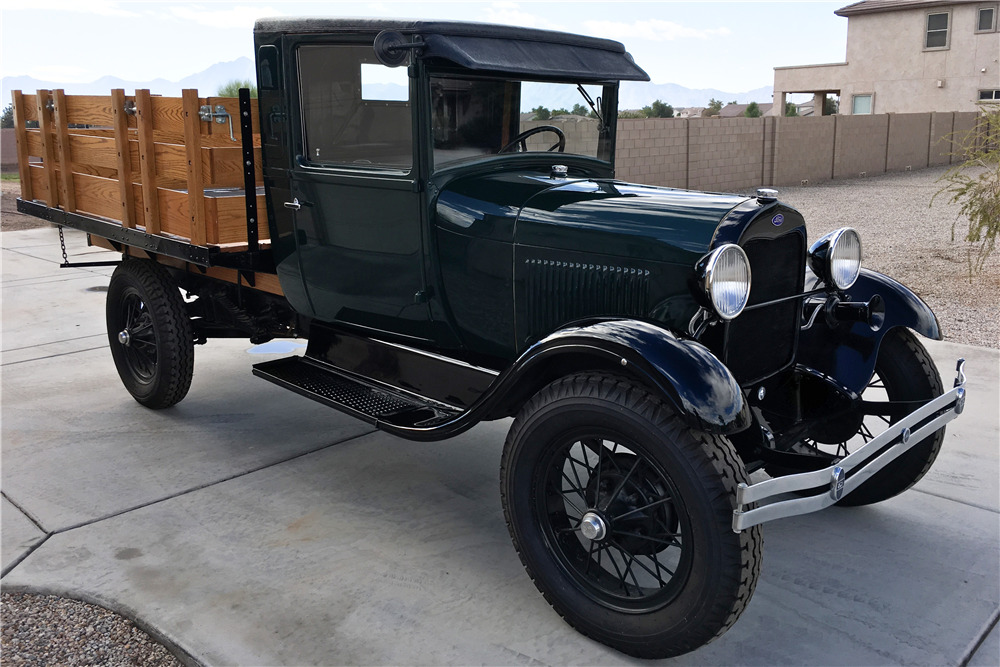

    Some of the early 28 Model A's had split rim wire wheels with the 5 on 5 1/2 pattern, they went to Budd wheels during the year.

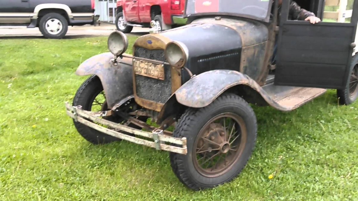

    M A G : I have an EARLY '28 AA truck that came with the split rim 20" wire wheels. Your pictures(especially the 2nd one) show that they have the same large bolt pattern(roughly 5 X 7") as the later Budd wheels on all 4 corners. 5 x 5-1/2 were on the cars.
