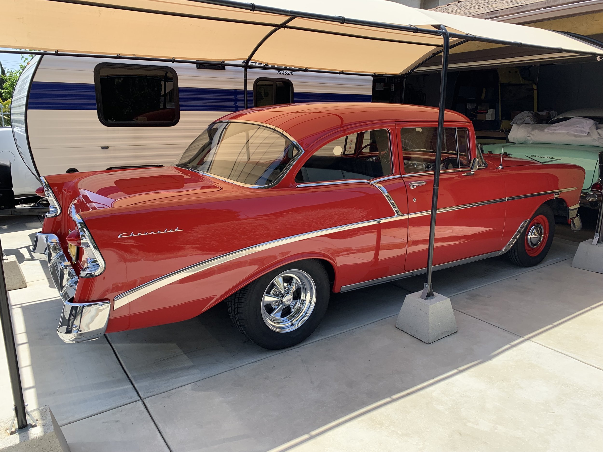

    The Cragars that didn’t fit well on the 57 is what I’m referring to. I did have them sold (sorta). See my long time friend from Jr. High days wanted them and he had the money however they wouldn’t fit his vehicle as well. Which brings me to an idea I had all the while but sat on it until now. Another pair of 15 4 1/2’s are on the way. IMG_4100.jpeg

    Posts: 38,035

    Why would they fit a 56 and not a 57??

    20mm is all. 56 had/has 255’s vs the 275’s I put on the 57. IMG_1360.jpeg

    It was tire width and backspacing that bit me on the 57. Started with 4 1/4” back space with 275’s and the tire was an rch from the quarter panel. The 56 has a 255 tire. That makes for a strong 3/8” of clearance using the same 4 1/4” backspace wheel.

    So to clarify, just a backspace issue with wider tires, right?
    Sharpone and Johnny Gee like this.
  19. Johnny Gee
    Joined: Dec 3, 2009
    Posts: 14,447
    Johnny Gee
    from Downey, Ca
    Yes

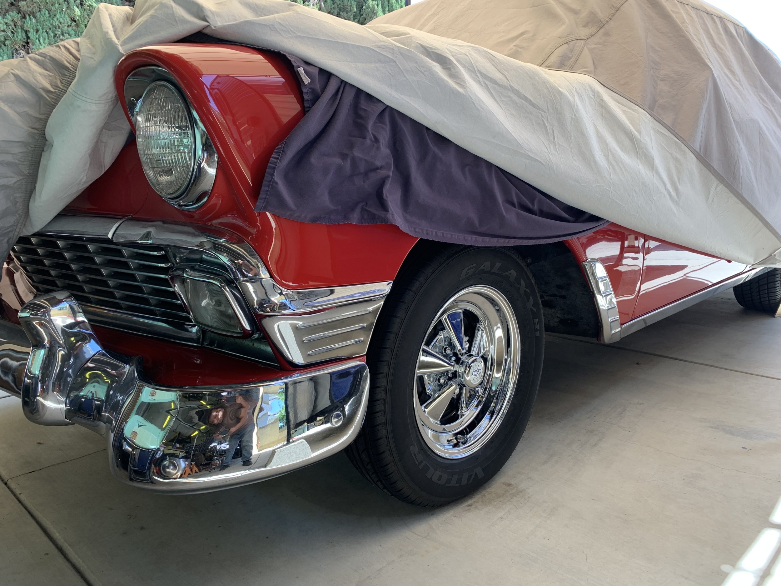

    Finally got the front wheels. Long story about back order bs via a vendor a lot of people like to ***** about here. I dropped the order with them. Then sourced these about 30 minutes from the house.
    Sneak peek. 185/80/15 look petty neat on 15 4 1/2’s. IMG_4197.jpeg

    Cragars were made for these cars! Don't just lift her skirt up, show it all!
  23. Johnny Gee
    Joined: Dec 3, 2009
    Posts: 14,447
    Johnny Gee
    from Downey, Ca
    Patience. She’s hitting the cruz in later today.
