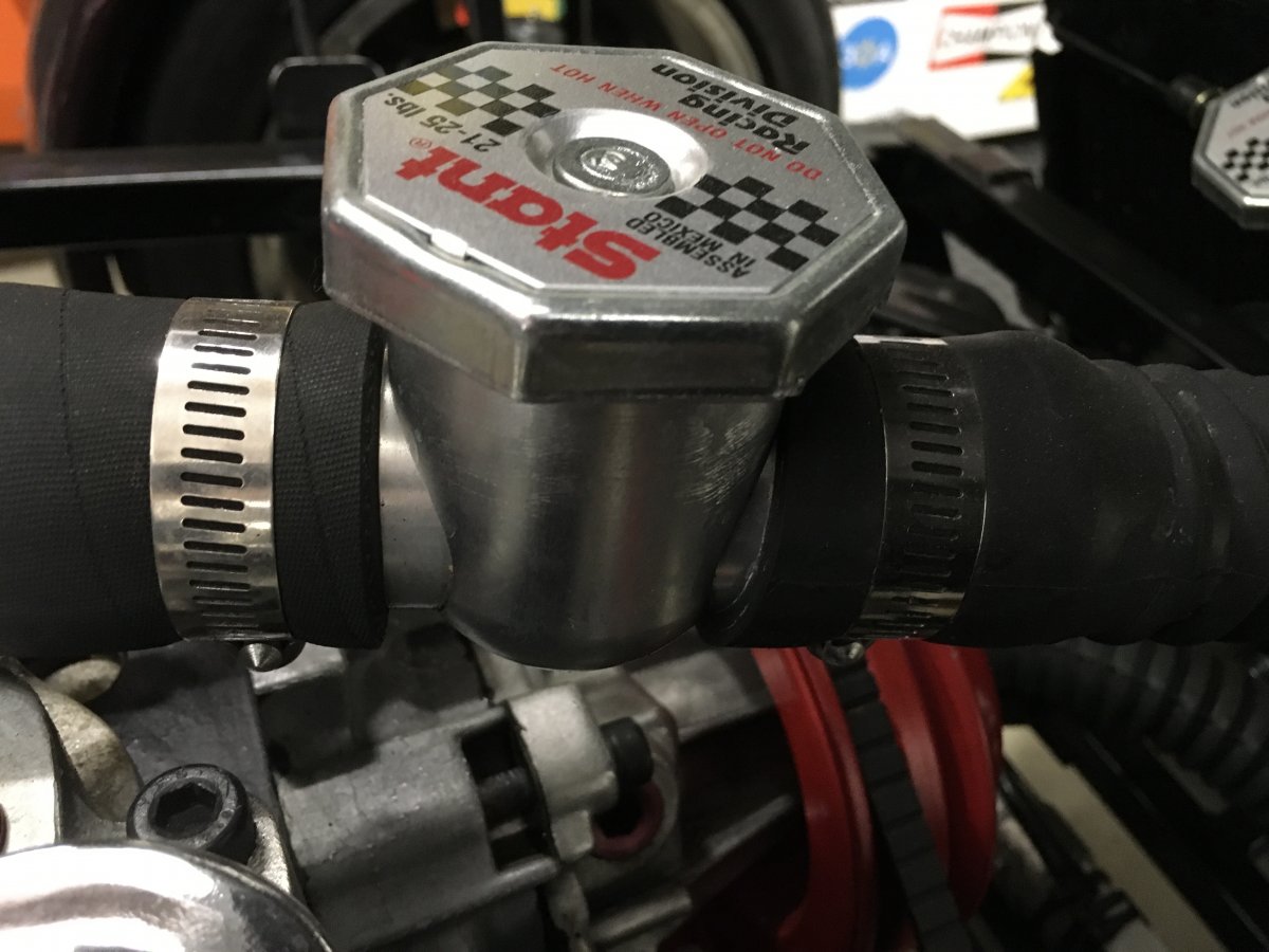

    Wanted to see how people were handling a radiator mounted low with cap below the engine level. A remote fill is needed to purge air. Ive seen the inline radiator caps, this thread refers to Ford FE remote fill tanks.
    https://www.jalopyjournal.com/forum/threads/filler-cap-in-radiator-hose.136137/
    The inline caps seem to work well, but Im not crazy about how they look.
    Any good remote tanks (with cap) out there? Good mounting and hose routing ideas?

    The radiator on my car angles back and the fill cap is below the thermostat housing I did two things that seem to work. I installed a inline radiator cap housing you can find cast or billet models pretty easily. The other thing I did was drill and tap the thermostat housing for 1/4” NPTand installed a radiator pet/drain ****. When I’m confident I have air out of the cooling system with the engine running I can crack open the pet/drain **** to let last bit of air out.

    I paid $20 for an aluminum in hose radiator filler with a cap from Jeg's early last year. It had a hose ****** included, so I did add a recovery system as well. I did have to get a couple of hose clamps though.
    I guess if you need an upper hose, that one listed above may be worth the money. Gene

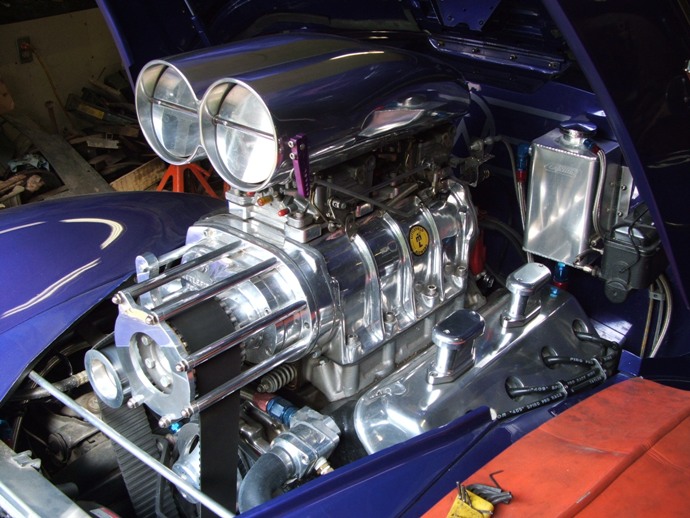

  7. 24riverview
    Joined: Jan 13, 2008
    Posts: 1,120
    24riverview
    indyjps likes this.
