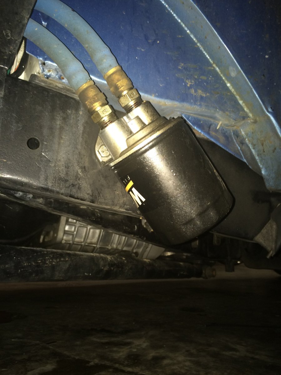

    Olscrounger turned me on to this set up on 40's. It works great, although mines got an SBCin it instead of an SBF, it would be similar. Mounts inside of left front fender to frame rail. Make sure to use good blue push lok hose or equivalent. image.jpg Edit: Man she's dirty under there.

    I can see advantages to both setups, and the same for disadvantages.
    Unfortunately life interfered today and I didn't even make it to the shop today. Maybe tomorrow I can get over and take a looksee.
    Will the angle type work both to left and right, space permitting?
    Thx for the info. .I just don't like that damn "peanut" filter.
