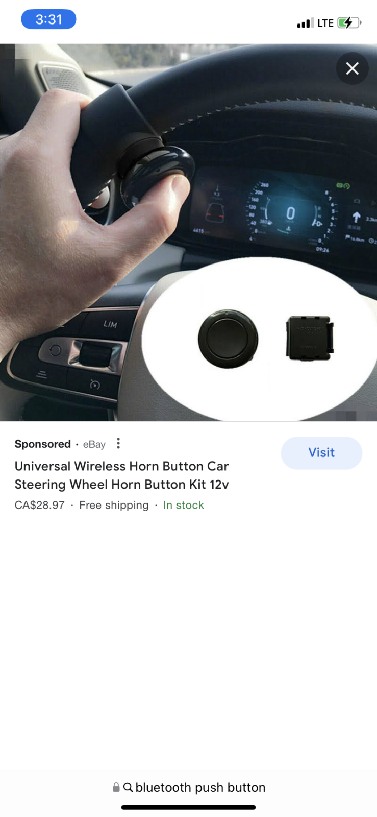

    did a quick google search
    this poped up.
    lots of Bluetooth push ****ons but they all look “modern”
    maybe you can retrofit an old horn ****on with the Bluetooth ****on underneath ?

  7. Bert Kollar
    Joined: Jan 10, 2007
    Posts: 1,261
    Bert Kollar
    I want to try this, I have a little room, but I dont think the signal likes being enclosed by the metal.
