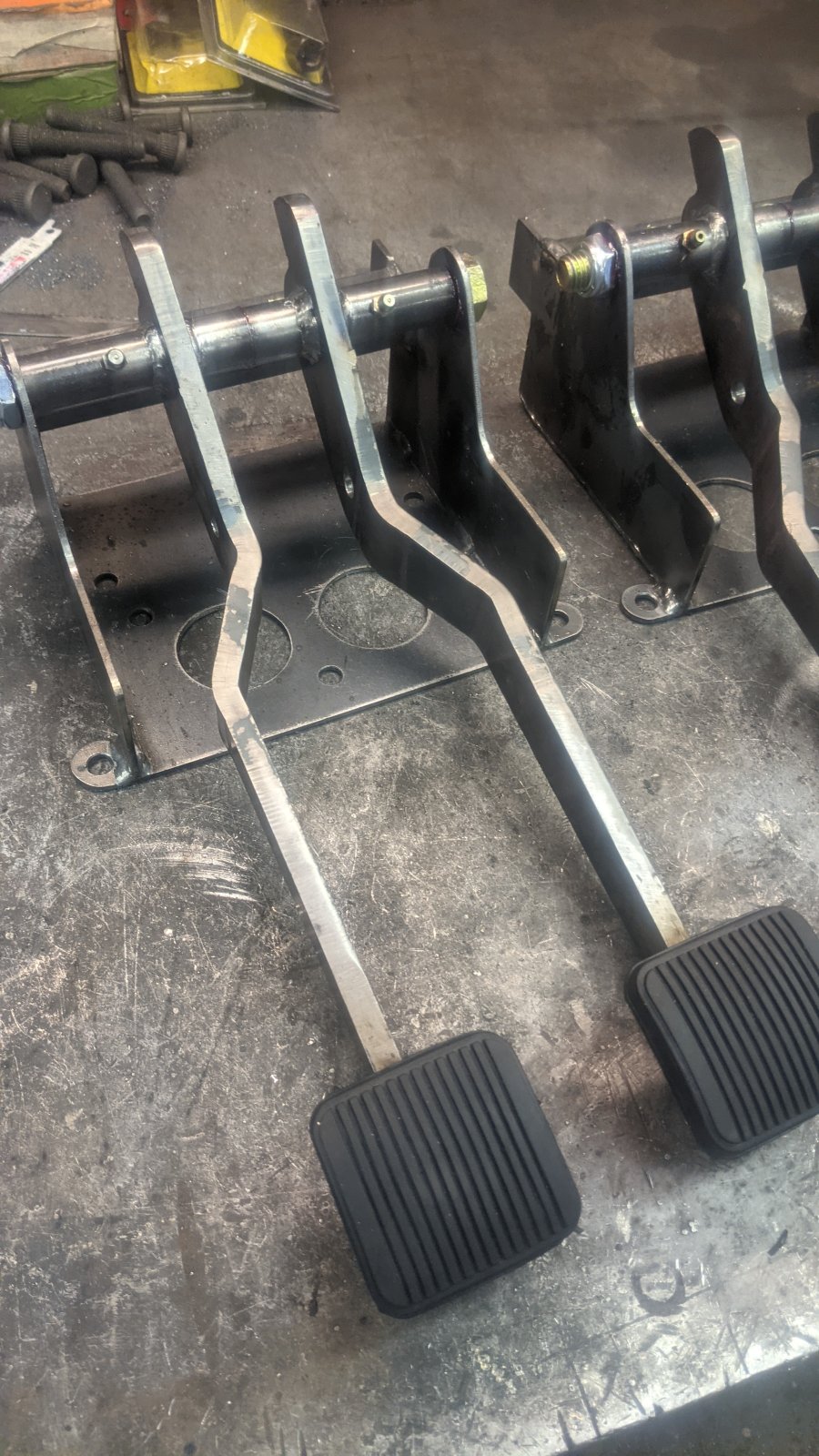

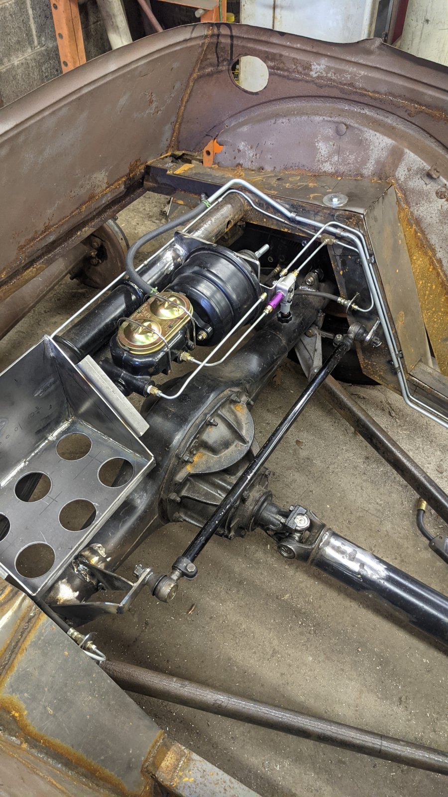

    Weird but working out.

    Hard to tell from the picture, but it looks like the left side axle tube could get too personal with the proportioning valve knob.
    You could flip it up, without modifying anything.

    Good observation there. Pic is deceptive however and everything clears nicely through full suspension travel. The proportioning valve is readily accessible while safe from road damage and not requiring the services of a contortionist.
    My greatest concern is having too sensitive brakes. The primary circuit is fairly adjustable as to both pedal ratio and stroke from 4-1, a typical power brake ratio, and 6-1 a more typical manual brake ratio. As I mentioned above this setup is somewhat new to me so there is a bit of a learning curve here.
    I've gone to a 1960 dual GM pickup MC and matching slaves for both brake primary and clutch actuation, The MC looks right at home on the firewall and with the D-Russ style front brake covers it will not be too obvious the car is running some serious brakes when you p*** me at 80 in dim light. Just waiting for a few parts to arrive to finish up and give it a try. A few progress pics.

    Looks like it should work, but the safety factor of a dual master is lost on the front half of the system.
    Kerrynzl likes this.
  15. Koz
    Joined: May 5, 2008
    Posts: 2,787
    Koz
    That was the one thing I thought about. I've used these single cylinders in dozens of cars and to be honest I never had even one fail. I can't say the same about the Corvette style dual cylinders. I've actually gone through several of those already.
