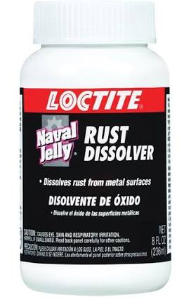

  13. 41rodderz
    Joined: Sep 27, 2010
    Posts: 6,540
    41rodderz
    from Oregon
    Google naval jelly . Go ahead :)
  14. Johnny Gee
    Joined: Dec 3, 2009
    Posts: 14,401
    Johnny Gee
    from Downey, Ca
    ^^^^^ Don't forget the "e" if you expect to find anything. :D
    Posts: 6,540
    41rodderz
    from Oregon
  17. 41rodderz
    Posts: 6,540
    41rodderz
    from Oregon
    Mmmmmmm..... I will tell Loc***e right away . They are not going to be happy having to change labels , stationery etc. I will tell them Johnny says so. :D
