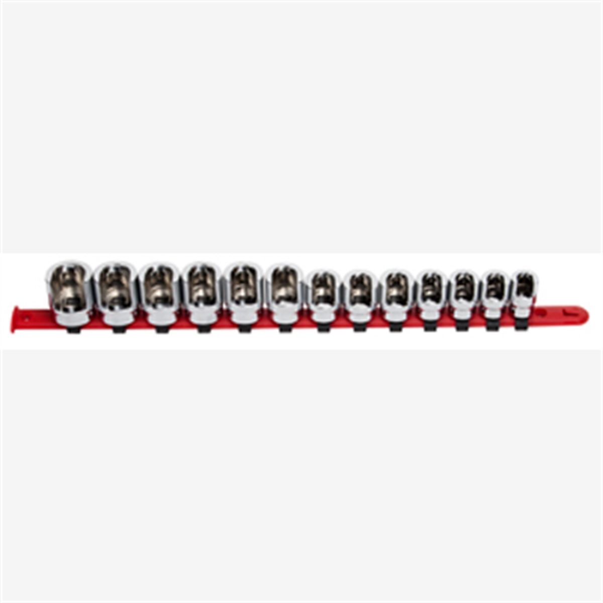

    One of these sockets would take it out. It works great for things like this.
    Good luck!

    Buy a pipe plug socket , bought this set for something stupid I was working on. Does me well on those lonely nights at sea !
    if you do snap the head off a drill bit with grease on it and drive it slowly into the br*** will drill it out real easy and the shavings will stick to the grease
