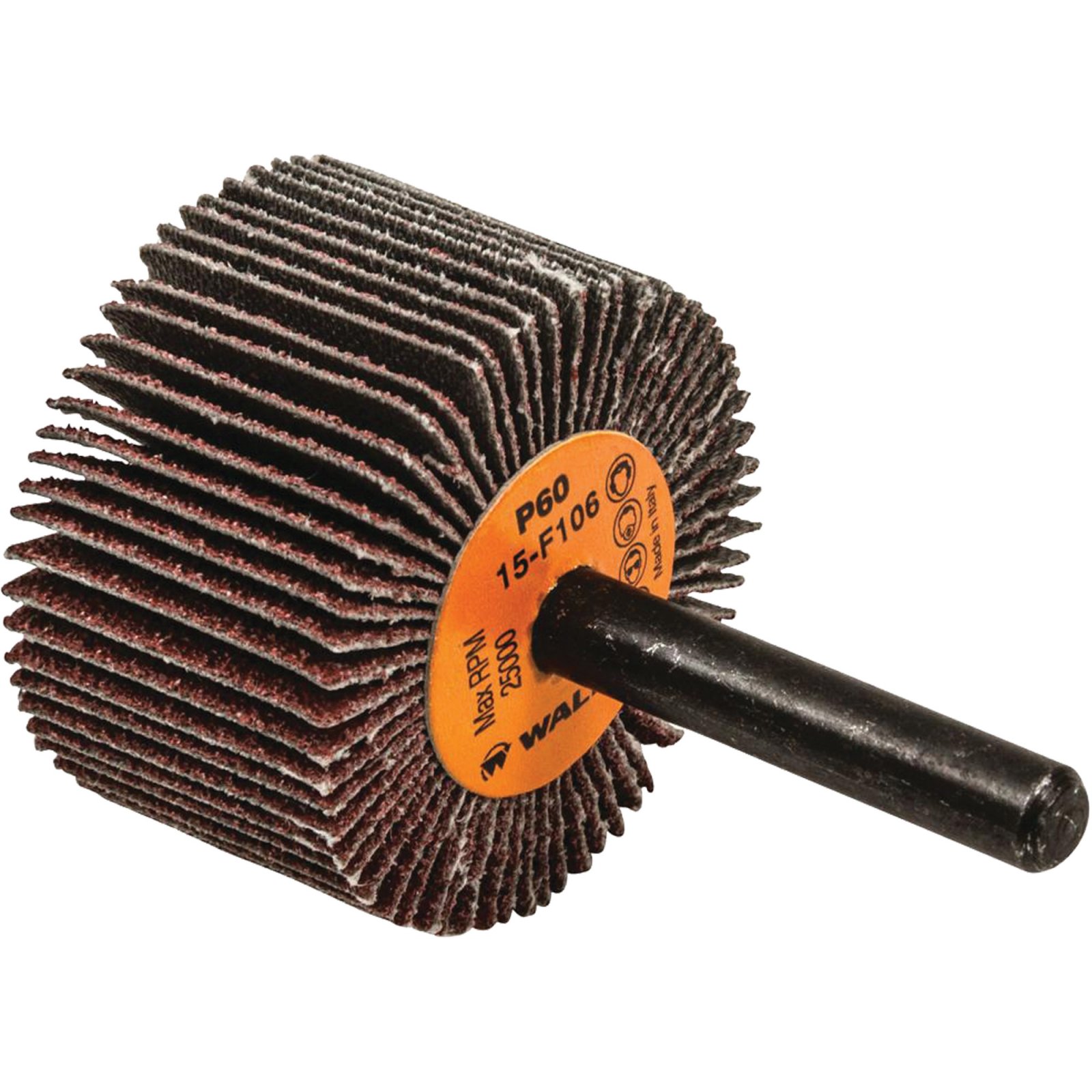

    I tried all the suggestions on my 55’s heavily bondo’d door. Really didn’t have much luck with angle grinders (stripping discs, sanding discs, flap disc, etc) or the torch method.
    What I found that worked like ****er were these on a die grinder. Probably be similar to the contour. The flaps kept the metal cool and stripped it so quick.
