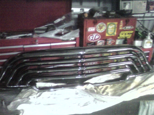

    I had sent my chrome grill parts over to my sandblaster and he tried to clean them up, but as soon as he started the parts started to warp. He isn't set up for baking soda, so what else can I do to remove chrome?

    Nothing that I know of if you want a smooth clean ,unplated surface. Baking soda will not do it.
    Your best bet is having a chrome plater reverse the process, basically a chemical -electrical strip.

    yeah I don't have a plater close by that's why I'm looking for different options. I am painting my grill anyway so I expect to do a little smoothing and body work.
