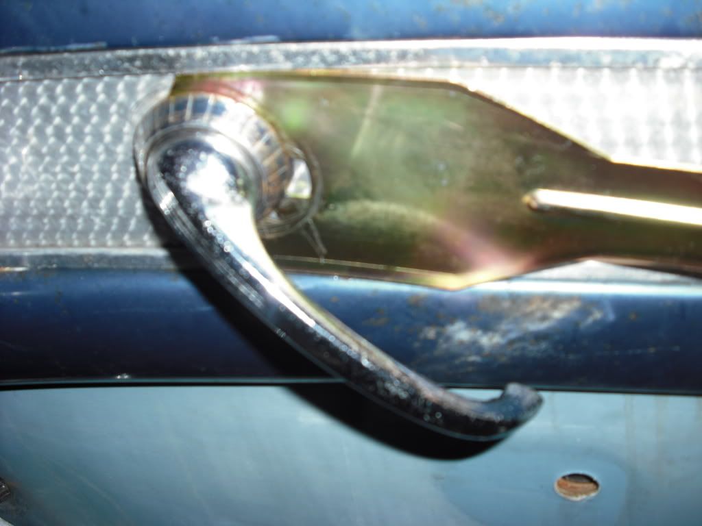

    Makes sense to me. I just want to show these pics to make sure I'm on the right path...
    Here's what I'm dealing with
    This is where I was putting it

    You need to be between the metal escusion and the handle, not the escusion and panel.

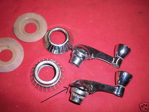

  11. Move the tool out, in front of the trim ring.

    ...finally got the pic to upload... the arrow pionts to where the clip should be, like those guys mentioned between the trim ring and handle..
