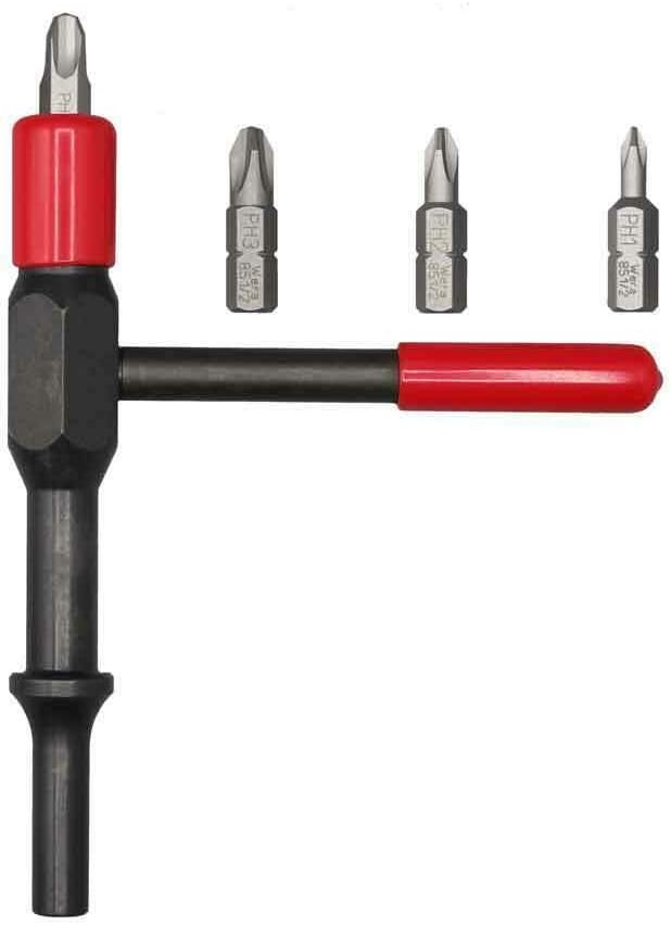

    For the hinge screws, LOTS of heat. I mean LOTS, and not with a propane torch. You need HEAT.
    Also, make yourself a "shake 'n break" like this one (see image below). Use the shank from an air chisel bit, weld a 1/4 inch impact socket on the end, and a handle on the side to turn it. Chuck it up in your air hammer, slip a Phillips bit into it, lean on the air hammer and pull the trigger. While it's banging away put some pressure on the handle to back the screw out. I made one of these in the previous century when I was addicted to metric motorcycles. They work slicker than owl shit on a green hickory limb.
    For the hinge pins, after your drilling fails, weld a nut on top of the pin (hope you didn't drill the button off the top of the pin). Heat the hinge, a little wax sucked into the hinge joint, and wiggle the nut a little bit at a time. Once the pin starts to rotate, put a vise grip on the nut and wiggle back and forth while lifting up.

  21. I just took the doors of a '40 Chrysler today! Had a couple stubborn screws. I use this hammer-twist tool. But first I heat the screw to almost melting temp and hold it there for a minute or so, so the threaded shaft gets plenty hot. Then I quench the bolt and give it a few whacks with the tool. Then I use a large Phillips screwdriver with a hex near the handle with a crescent wrench. Heating and quenching stubborn bolts works every time.
    https://www.harborfreight.com/6-bit...m=social&utm_campaign=shortener&cid=go_social
  22. I made one of these a few years ago. You may be right about the owl shit but I have never used that product. But the tool works like a champ!
