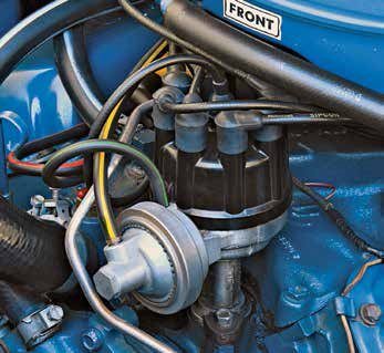

    A SBF engine can be dis***embled without removing the distributor as far as I know? Is there something I don't know that makes people want to pull the distributor when doing intake and heads?

    Makes the intake much easier to R&R. I've never tried to do it without removing the dist.

    Label your plug wires with a Sharpie and masking tape as you remove them. Makes it easier to get them back on the right plug. Draw a diagram of what you think #1, #2 etc are. There is a theoretical or factory #1 plug, but as long as you are consistent on what wire came off what plug, you can label them what you want. Same on the rockers/parts that are embedded in the beer box... label as per your engine sketch.
    Take the dizzy cap off, and take a photo of how the rotor points. When you refit the dizzy, that's how the rotor needs to point again. Very easy to be "off by one tooth", and a photo helps to show you better.
