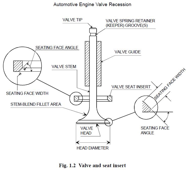

    IF it's too tight, it can be fixed with removing the valve cover and adjusting.
    Since it's been running a bit with the miss (***umption) the valve and seat are probably no longer seating properly.
    This will require removing the head. At that point, inspect the seat and valve. repair or replace as needed. If it is a small mismatch, lapping can be done.
    www.youtube.com/watch?v=pVp04atZoc0
    You can lap just one or all on that head, or both heads. Good to replace the oil seals too. They are usually included in a head gasket set.
    Next up is checking and perhaps repairing the guide clearance. By this time, you are getting into the area where a set of rebuilt heads are often cheaper than rebuilding your originals. Price out a local rebuild including new valves, seat grinding and guide repair. Compare this to a set of rebuilt heads.
