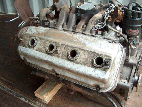

    i just tried to remove the valve covers on my desoto hemi, looks to me like i have to pull the spark plug tubes first, does anyone have a trick for pulling them there in there preetty good.

    MR. FORD just went through this. Had to yank em hard. I believe one guy made a tool somewhat like a bicycle stem that wedges in there and you can whack it out.
    Oh and I'm not sayin nuthin but they wont come out unless you pull the plugs. Once again, I'm know I'm just stating the obvious but you never know....

    Remove the spark plugs first!! Thats the only thing holding them in.

    Mine were stubborn as well. Take the spark plugs and valve cover bolts out. Wiggle the cover and tubes loose as one piece, seperate later.

    so i pulled the plugs and the tubes came right out, i'm in the process of cleaning the tubes and reinstalling them, looks like carbon on the tube bottoms and i bet oil was getting by, maybe the old girl will stop smoking.

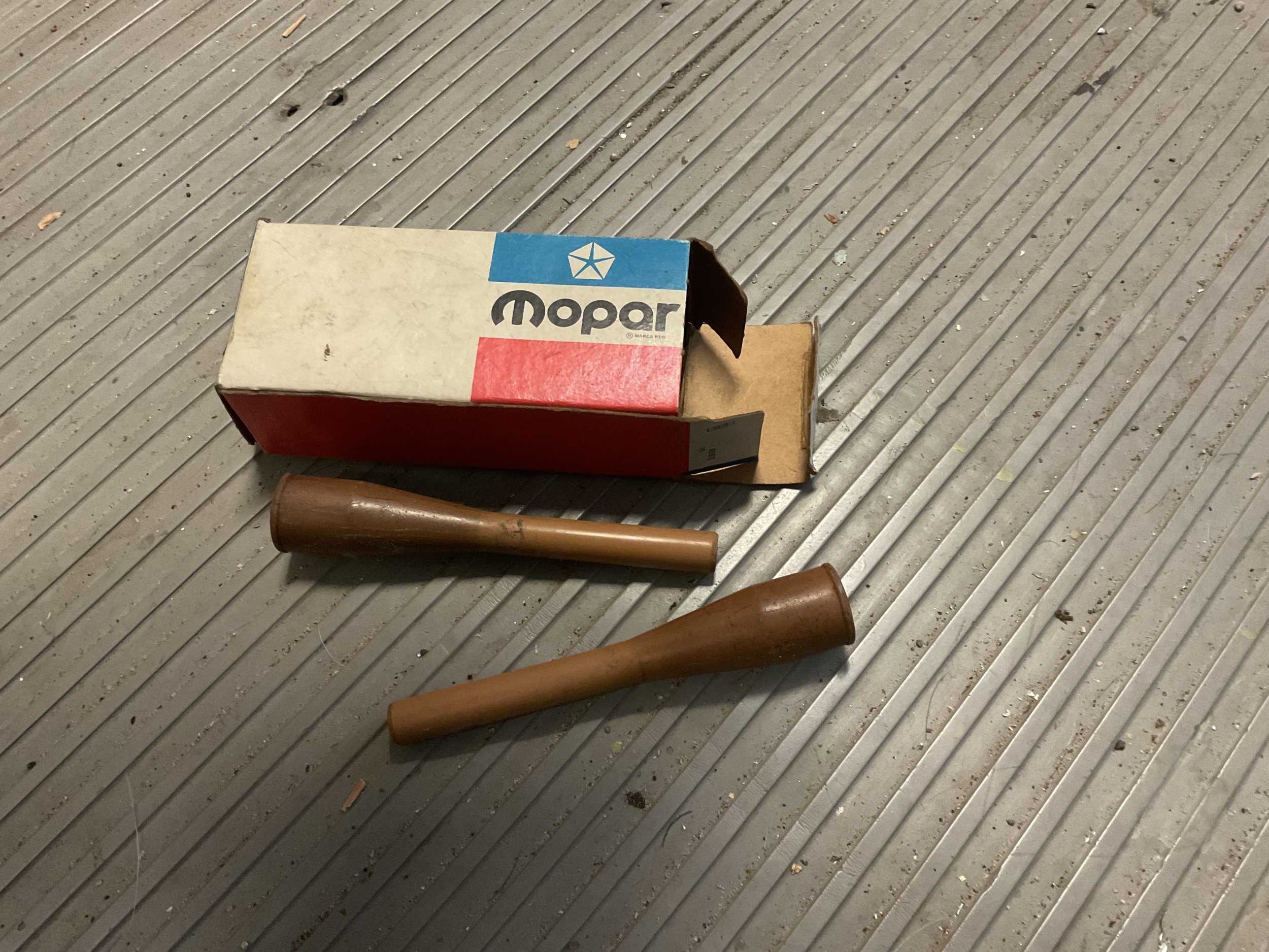

    Do the early Hemis have the tan coloured Bakelite insulators? Or just long rubber spark plug wire boots?

    Most have the tan Bakelite insulators. In dozens of early hemi's, they are all I've every seen. There are white ceramic insulators available as well. Maybe someone else has an insight on those.

    Found these in a stash I had to go through. Seems I bought these as a replacement a long time ago for the broken ones in a Boss 429 engine. IMG_1748.jpeg
