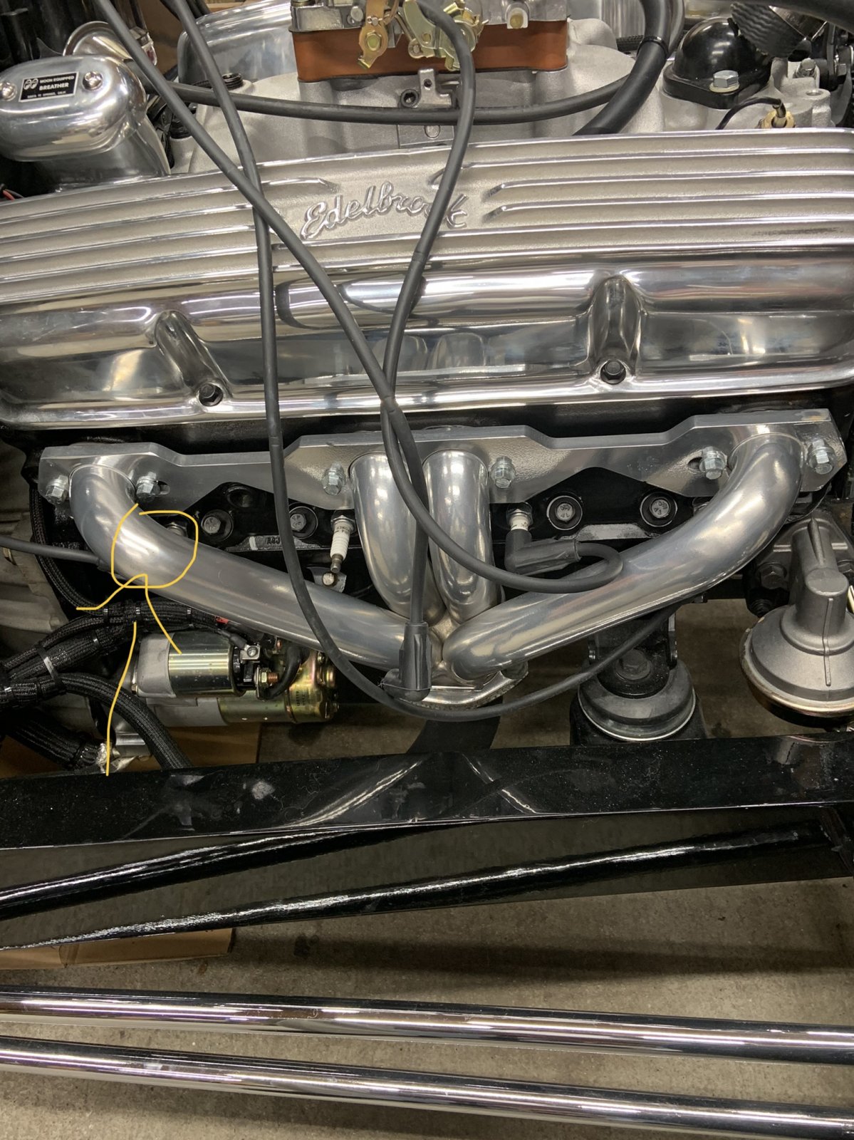

    Here’s a pic I just took, any eagle eyes out there that can tell where it was ? Still, better than a black blob.
    :eek::rolleyes::) 57AD2479-5131-442D-B0A3-489050D282AB.jpeg

  19. Knew it! Good job!
    lothiandon1940 and Dino 64 like this.
  20. Dino 64
    Joined: Jul 13, 2012
    Posts: 2,553
    Dino 64
    from Virginia
    Thanks, so you knew where it was ? A guess it looks a little shinier than the other.
    But you said I was screwed !!:eek::eek::rolleyes::D:D
    lothiandon1940 likes this.
  21. It depends on the condition of your ceramic, yours looks pretty good to start. I have seen more fails than successes! You done well, and yes, that location was my guess. Not that it stands out

  22. seb fontana
    Joined: Sep 1, 2005
    Posts: 9,299
    seb fontana
    from ct
    I picked there too but a few degrees towards the outside.. Just a guess.
