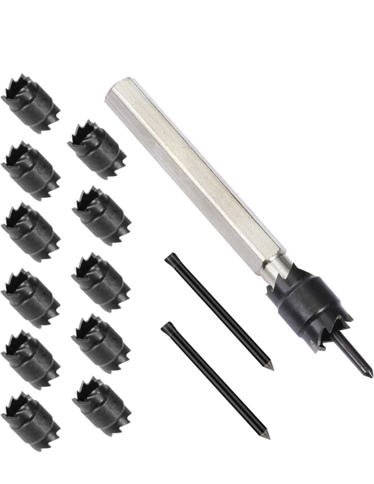

  3. Rehpotsirhcj
    Joined: May 7, 2006
    Posts: 1,587
    Rehpotsirhcj
  4. Rehpotsirhcj
    Joined: May 7, 2006
    Posts: 1,587
    Rehpotsirhcj
    Sorry, those were for the 8000 spot welds on a model A. Yes, thin disk as was mentioned
