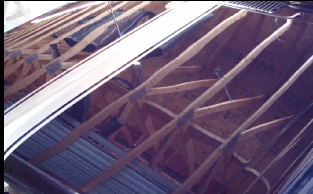

    I did an abrasive strip on this and the original Formula S stripe didn't ghost thru.
    Oh wait, never mind. It got a new one. Carry on...:p

    ^^^^No insulation in your garage? :cool: That is a tight polish job.
