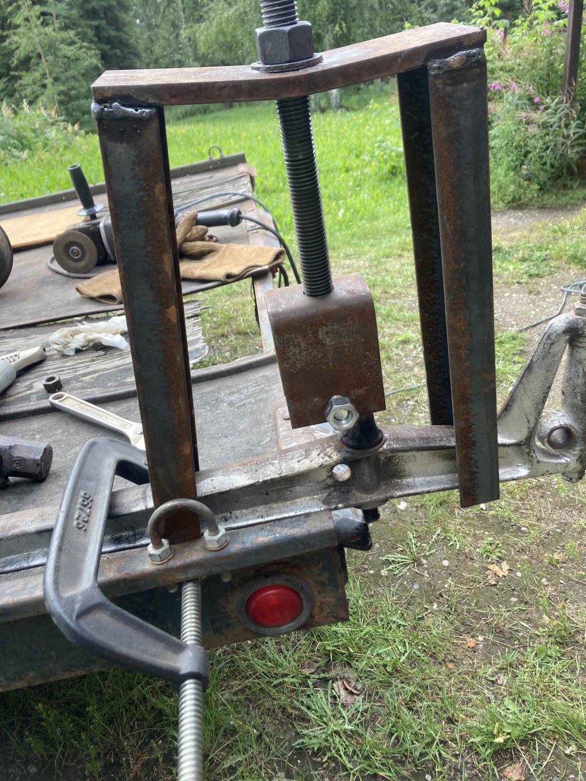

    What I have done is, get it in the press, soak it with Kroil, or another penetrating fluid. Put some pressure on and start heating it with a torch. You should hear it coming loose, add more pressure, and heat until starts to move again, continue that method until it is free.

    Thanks for posting that link, it looks like that will be pretty easy to fabricate and this model T axle is flat on the bottom so it will be even easier. I was concerned about pulling off Center but reading that original thread it doesn’t seem like it would make a big difference.

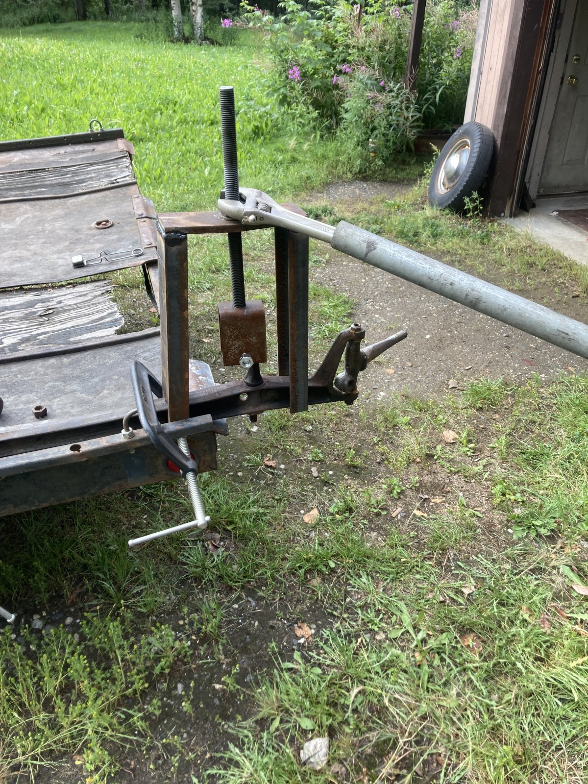

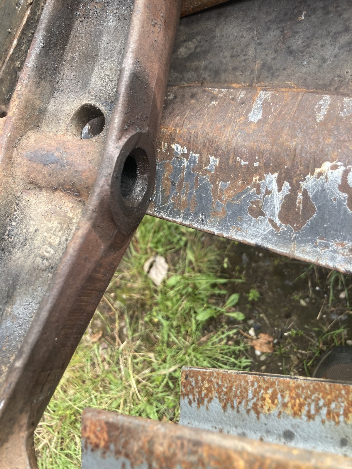

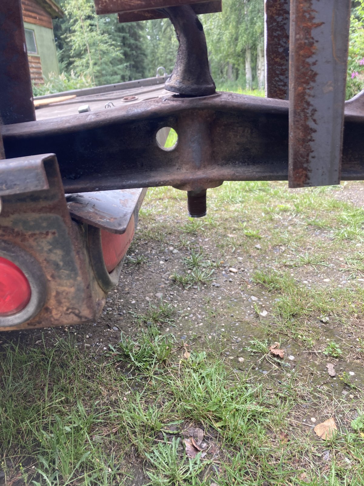

    Well, these things are being a little tough after 100 years. I have a piece of half-inch plate for the top and it is bending. I’ve tried heat a little bit of hammer. It’s moving some but really really tight with a 2 foot cheater pipe it’s making my entire trailer move.

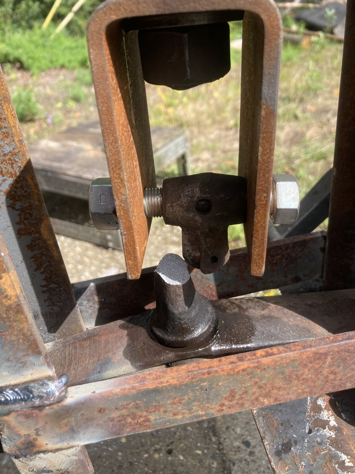

    Adding this, well, I got the first one out, but the second one is actually bending the legs on the puller.
    I think I’m gonna have to weld a brace along the bottom of it, but this will prevent getting a torch in there to get it heated up real good.
    IF I can get it straightened out without having to start all over again.

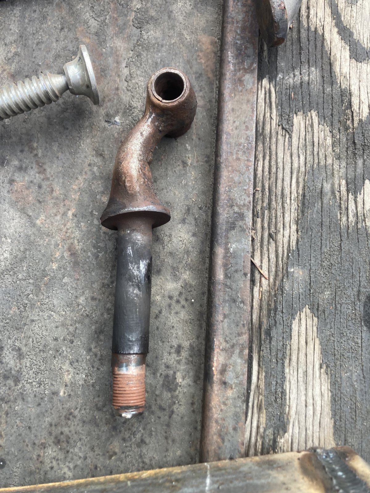

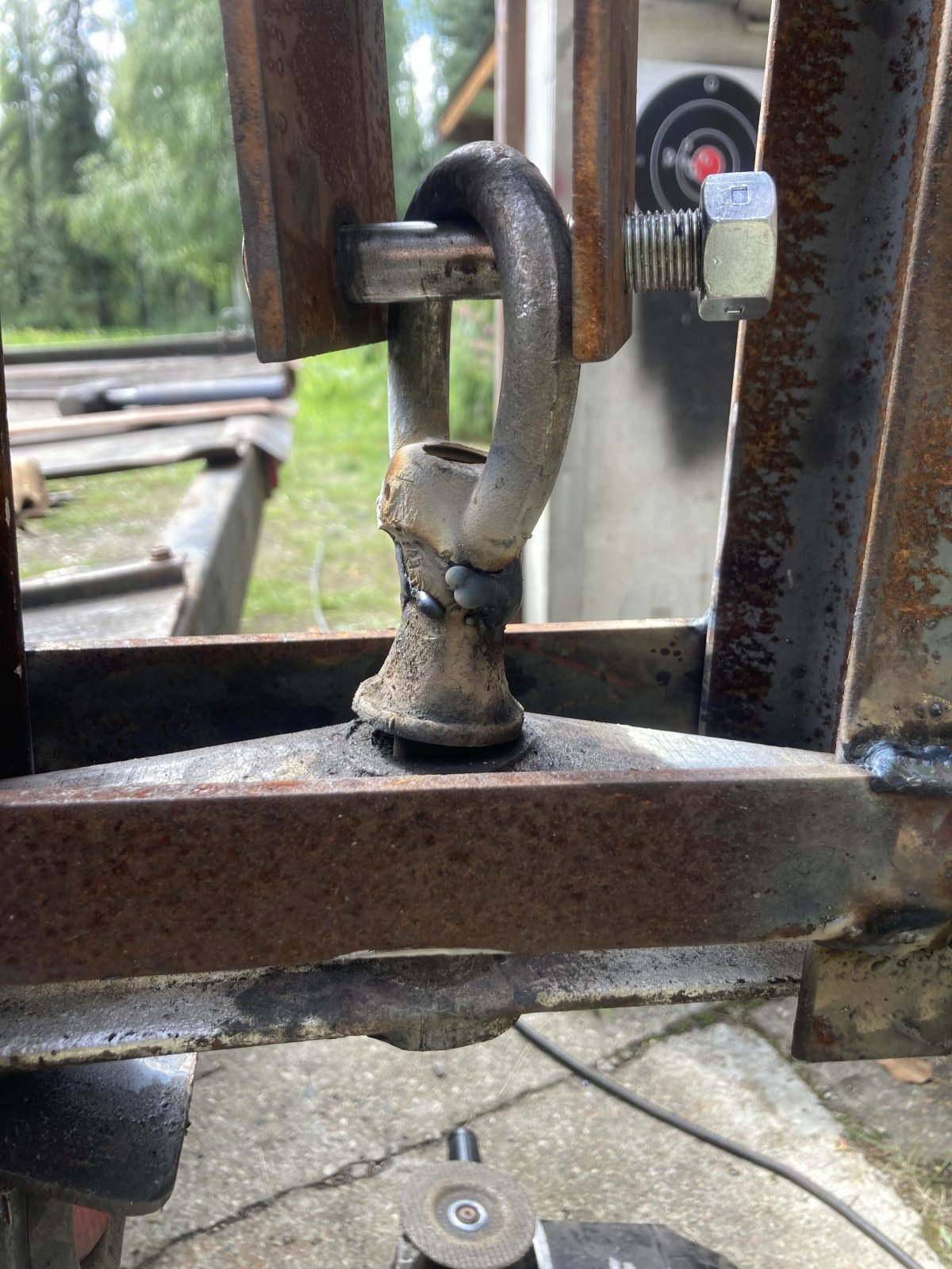

    The second one was a little bit tougher than the first. Ended up breaking the perch pin in half. I guess that was what happens when you reinforce the tool. I was able to weld an eye bolt on the top of it. At least I got a straight line pull this time. And it did eventually come out.
