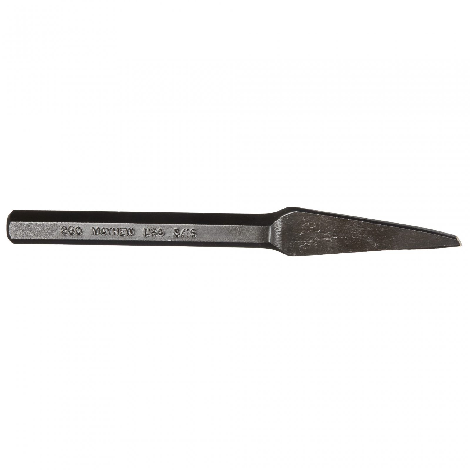

    Bearing chisel , good to simply “blow up the bronze bushing into bits “

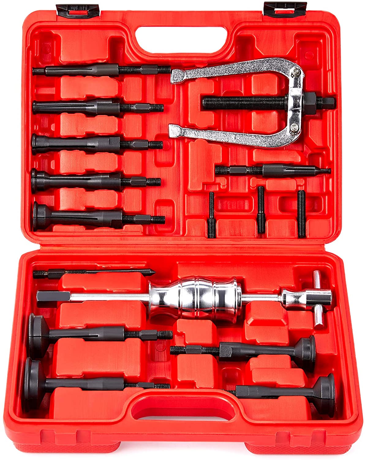

    pilot bearing puller , works great .
    blind hole bearing puller used with a slide hammer works really well
    pilot bearing puller for a slide hammer .
