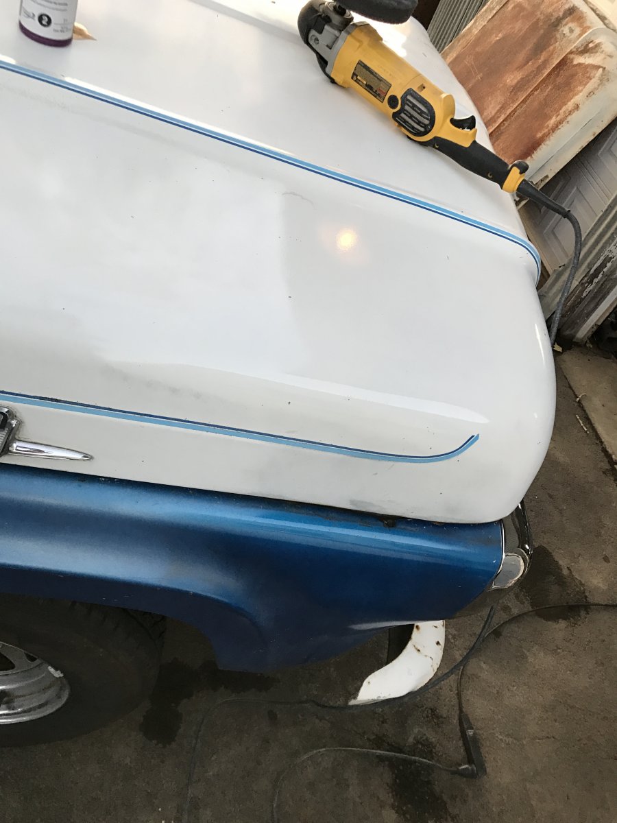

    What about pin stripe tape? Heat gun? I just bought a 59 F-100 with 80's pin stripe tape on it and I want to remove it. It's been on there a while! I will live with ghost stripes as opposed to the bayliner tape :D

    Heat gun, and plastic razor blade , rustoleum makes a decal adhesive remover I never used it but if the sticky stiff is still there that should help get it off

    There is a tan rubber decal remover wheel that you chuck up in a drill available. It works great. I used to use them to remove decals and striping off old city trucks to prep them for auction. Probably get them at any auto body supply store.

    3M makes them.

    They work great . We used them at the shop to remove truck lettering a lot. Napa sells them . "goof off" gets rid of any left over sticky stuff.

    Napa sells an eraser wheel for stripe tape. Mounts to a drill. Won't hurt the paint.
