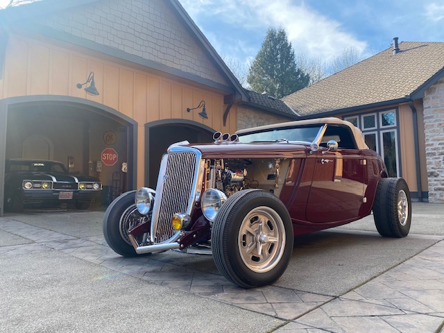

    I did this to my 34 ford. When I was designing my hood, I noticed it was "running uphill" to the radiator, no bueno! I already had the radiator built, lowering the radiator made lower hoses (flathead) impossible as they interfered with the crossmember, so I removed and lowered the front crossmember. This of course raised the stance of the car in front. To compensate I removed the top spring and the short one on top of the stack. I made a spacer out of a block of aluminum to fill the gap I created.
    The roadster has been on the road for 6 years and rides nice even with two guys in the car. I run a couple of Bilstein tube shocks up front, hairpins, typical hot rod setup. All steel car, Blown Flathead, is not light.
    In retrospect it would have been easier to cut the radiator core down but why do things easy?

    @wstory what do you have to lose to try it? Remove a few, give it a whirl, put 'em back in if it doesn't work to your satisfaction. Mine is a super slide spring with reversed eyes. If you haven't reversed your eyes, start there.
    Yes it has. 2019 Portland Roadster Show. It has become a pretty nice road car, but I am still making adjustments. They are never done! Long live the flathead!

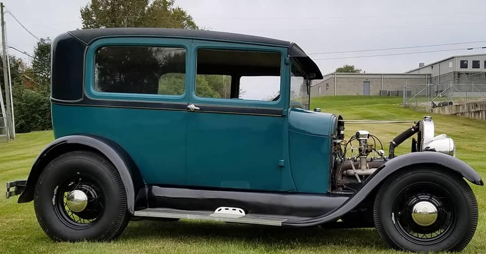

  9. When I built my A, I used a stock frame with a '30/'31 front crossmember. I used a '35 front axle, reversed eye model A top spring, '32 spindles and removed #2 and #3 springs from my A front spring pack. This is how it ended up sitting... 117.jpg
  10. skooch
    Joined: Feb 7, 2007
    Posts: 780
    skooch
    That’s a really nice blue.
