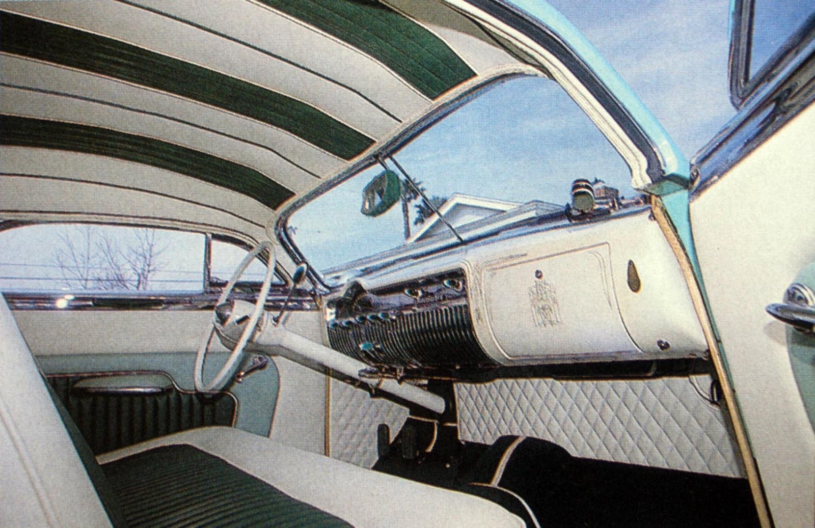

    The Hirohata and the flamed one you posted have the door tops welded to the roof. The other two have the door tops removed as well as the tops of the rear windows. When you do it that way you have to make a new piece to frame the top of the window opening and you can fit a window gasket onto. The Hirohata has a gasket fitted in the window channel of the door tops that the window frame closes against. The 1/4 window slides into a channel on the bottom and I think are fixed at the top against the same gasket.
    Here’s a pic of the Hirohata’s. So far as the b pillar, yes, I think most are just removed and capped, but as Tman says….some extra bracing might not be a bad idea.
