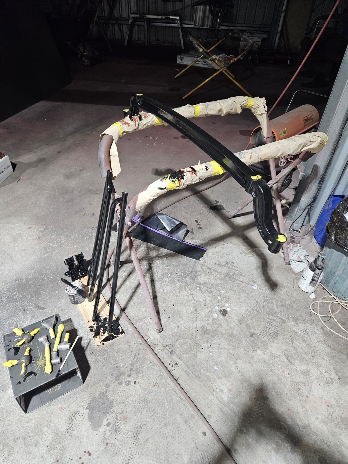

    Took my Cleveland powered shop ute, to pick up the new to me front end.
    Purchased from a local rodder who decided to go ifs.
    Cleaned up the casting a little. Without getting to carried away. 20240520_141453.jpg
    Added a coat of ch***is coater black paint, to keep the rust away while I'm setting it all up. 20240520_173734.jpg

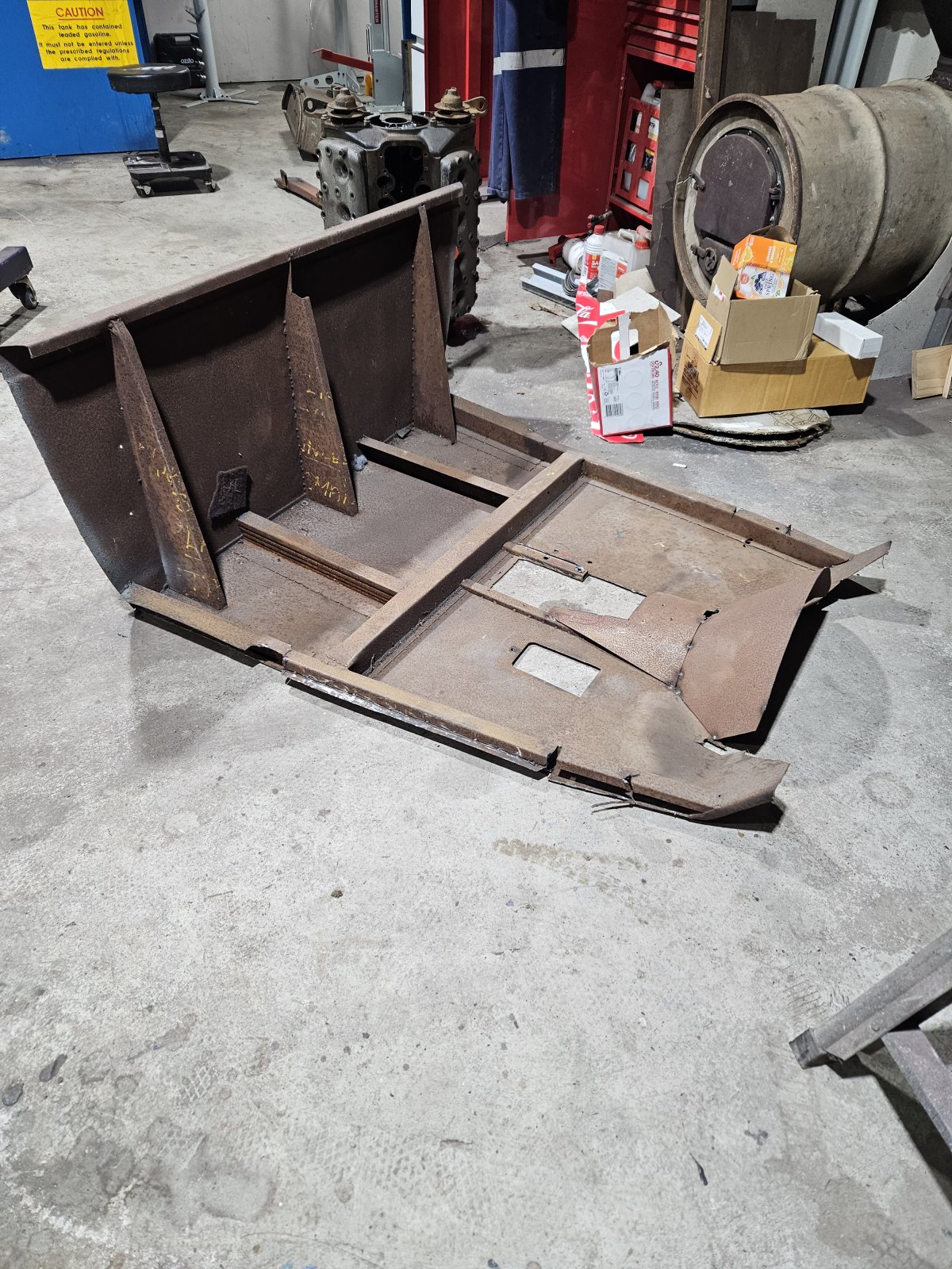

    Turned up a driving punch, to fit the bushes in the stub axles
    Dug out a block, some old heads and water pumps and put them together for a mock up engine. 20240521_174856.jpg
    Removed the booger welded 'tank' , then mocked the cowl together with the new tank and firewall. 20240520_173645.jpg 20240520_173658.jpg 20240521_183217.jpg

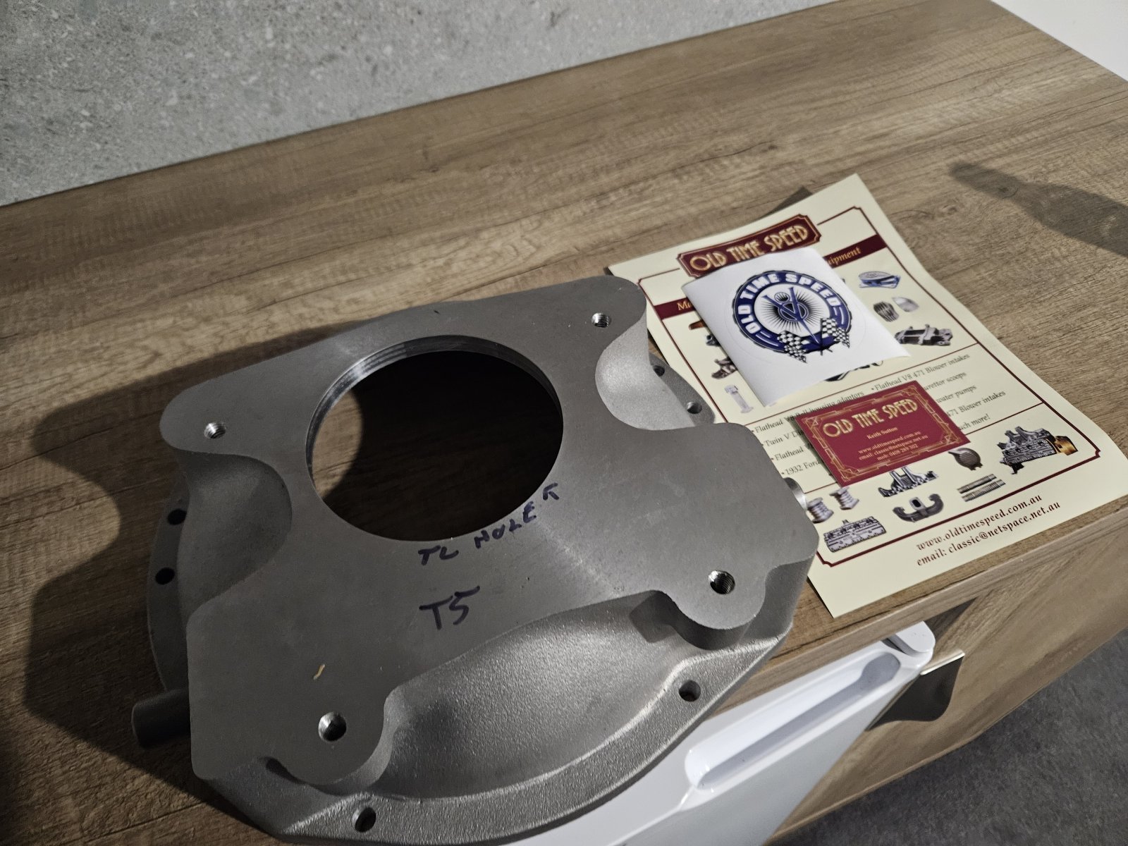

    Picked up my trans adaptor from 'Old Time Speed' here in Australia. Very happy with the service.
    Will allow me the option to run either a ford t5, or muscle car era top loader, behind the flathead. 20240603_191356.jpg 20240603_191333.jpg

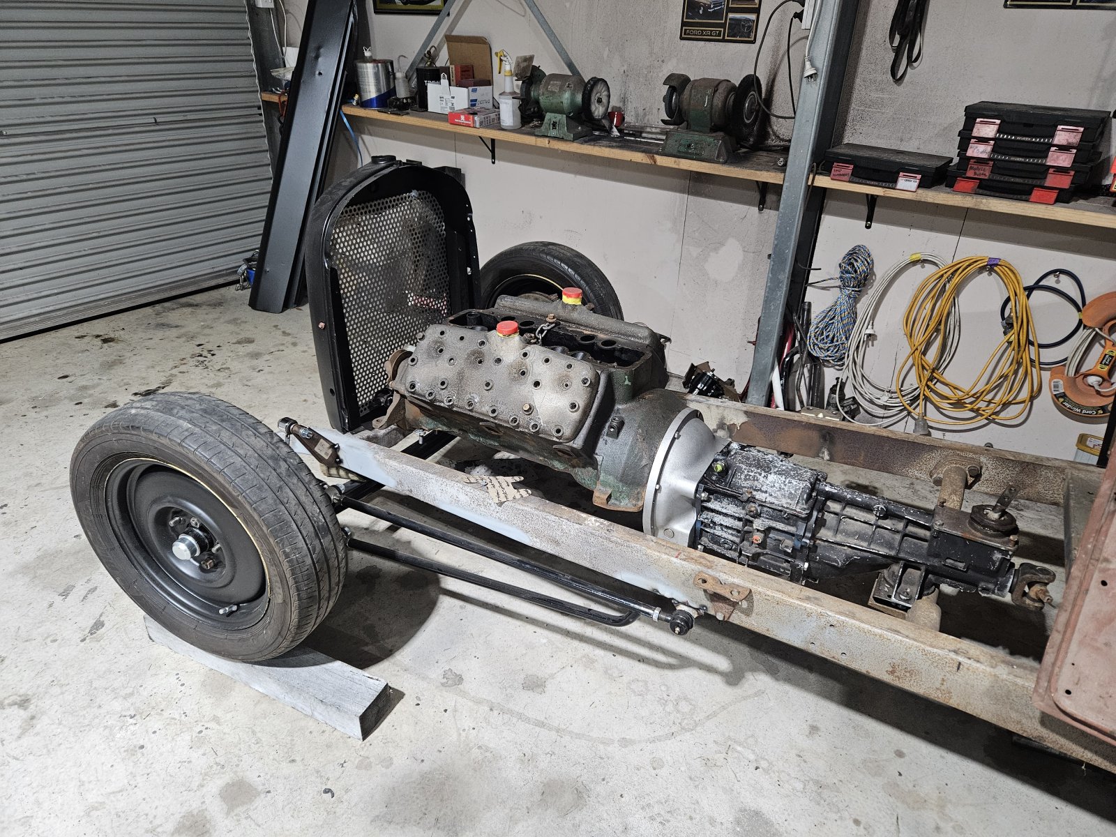

    ***embled The front axle, stubs, brakes. Got it sitting in the right spot, then tacked the shock mounts and hairpin mounts in place.
    Mounted my t5 to the flattie block and started to mock up for fabricating mounts.
    Sitting on the trans cross member from the clevo/ c4 combo, I was around 20mm forward. Redrilled an old trans mount by 20mm, and the engine location now looks pretty good. 20240822_181446.jpg

    Trans is a T5 from a 90's Australian 6cyl falcon. They share the front end dimensions, like input shaft length etc. with the muscle era top loader. Shifter location is a little far rearward, but that's not too painful to remedy. 20240822_181512.jpg

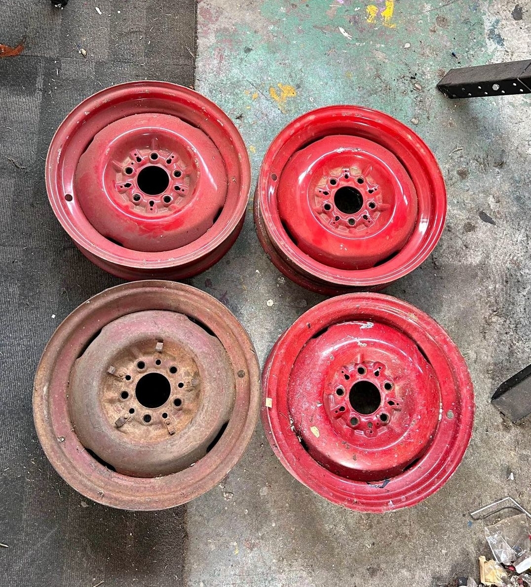

    Was happy to come across these market place today.
    Set of 16x4 dodge wheels, should fit the build nicely being a decent early wheel with 5x4.5" pattern Screenshot_20240901_115843_Facebook.jpg
  26. Outback
    Joined: Mar 4, 2005
    Posts: 3,447
    Outback
    from NE Vic, Oz
    Nice work, they are a good looking wheel
    GTHOtrod likes this.

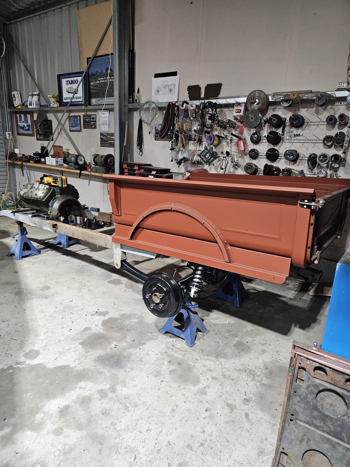

    Needed to add a clutch pedal, now I've changed to a manual trans. I got lucky and picked up this pedal box for not much money. It was well worth the price just for the pedal rubbers alone. If I can use the pedals or pedal box also, then even better.
