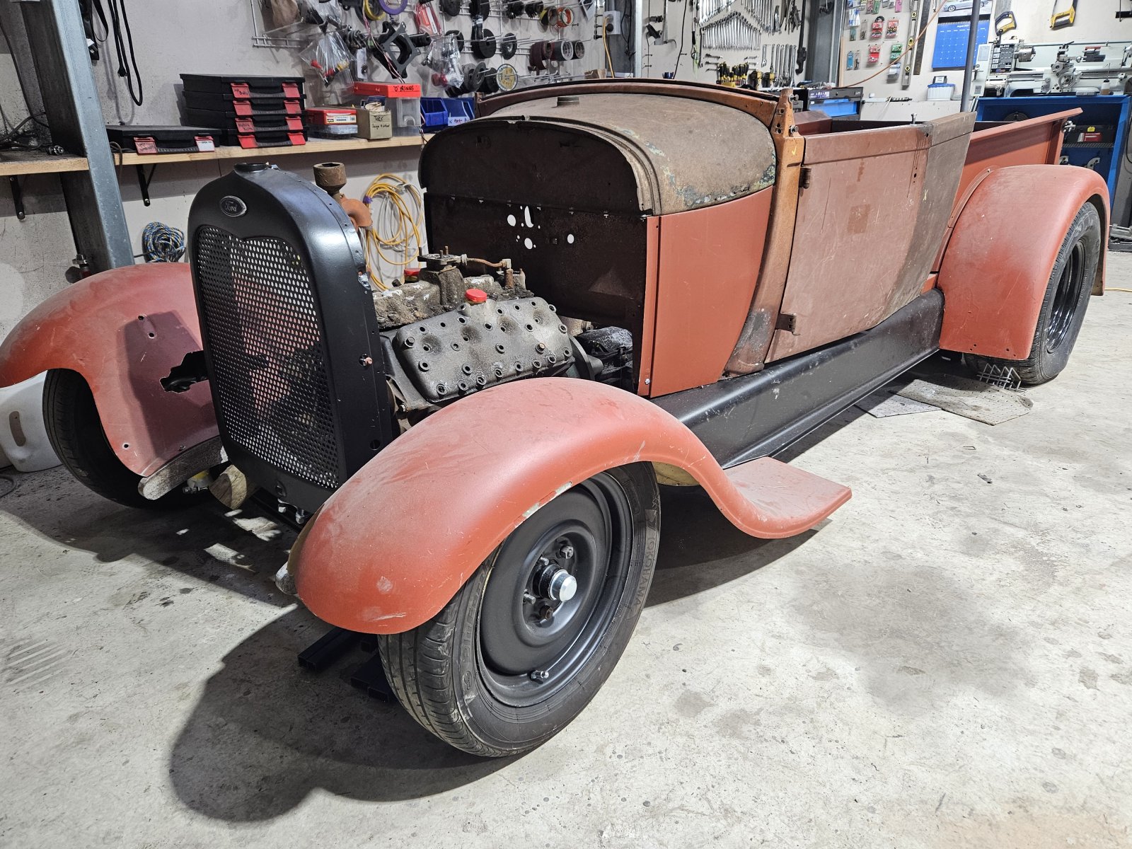

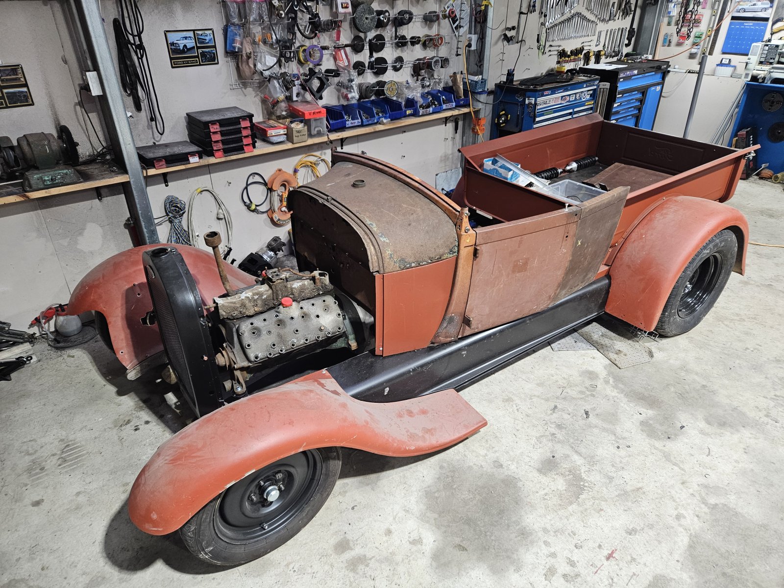

    Currently, fronts are 175 65 15s on 15x4s, rear's are 275 60 15s on 15x8s.
    Planning to change over to 16x4s all round.

    I bet it will look great with the 16's too. It has a nice hot rod rake right now.

  7. Have you checked to make sure the 16s will clear the front fenders?
  8. Outback
    Joined: Mar 4, 2005
    Posts: 3,374
    Outback
    from NE Vic
    With a 4.50 it orta go close?
  9. Id be more worried about height. New wheels and tires definitely look a good bit taller
  10. GTHOtrod
    Joined: Apr 30, 2018
    Posts: 45
    GTHOtrod
    Ride height isn't locked in as yet. Can raise it to aid tyre clearance.
    Definitely looking at a 4.50 16 up front for big rake
  11. 05snopro440
    Joined: Mar 15, 2011
    Posts: 2,995
    05snopro440
    That's about 2" taller than your current front tire (1" per side). So it'll bring the car up an inch and the tire will be 1" closer to the fender.
    GTHOtrod likes this.

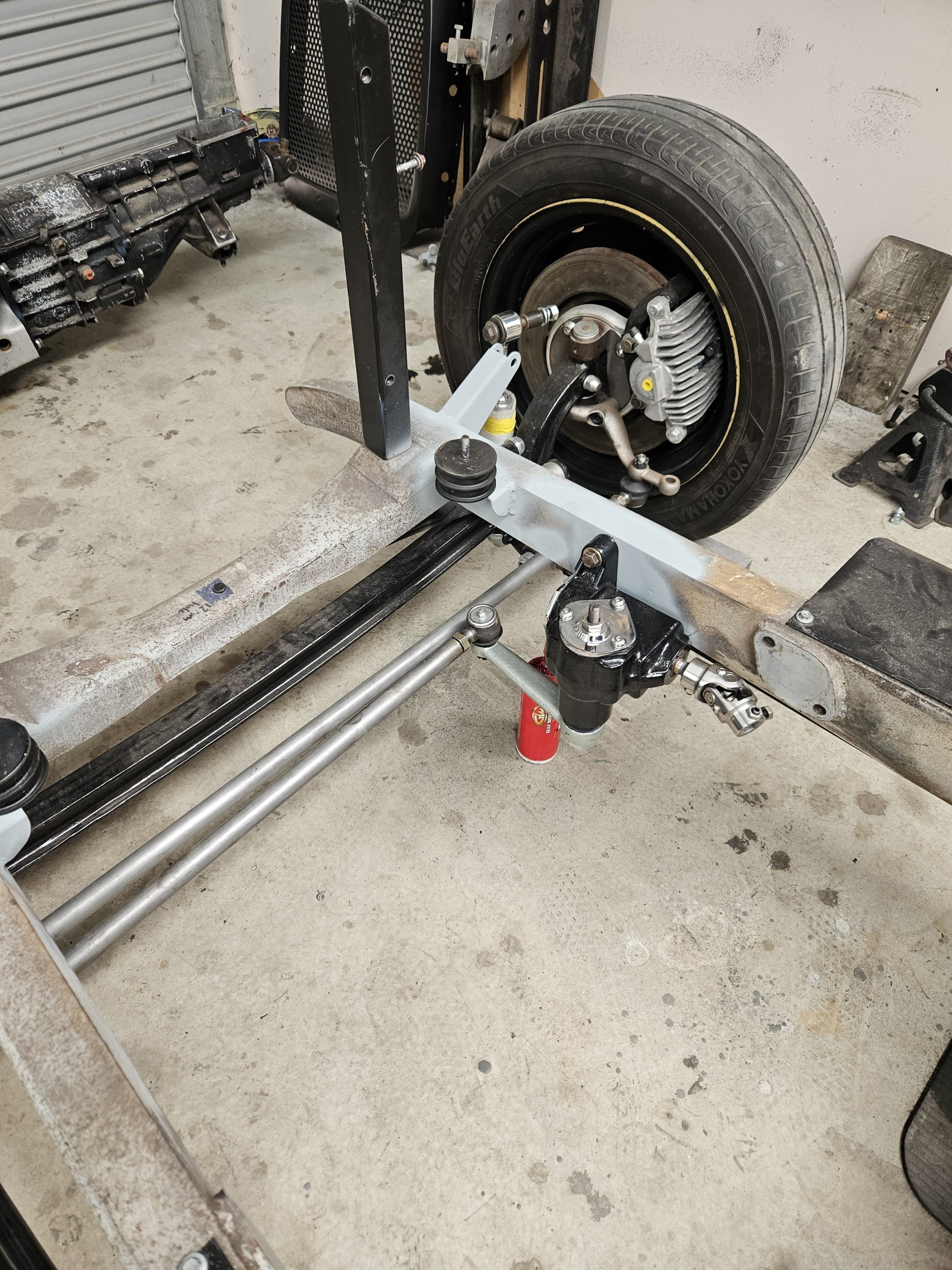

    Had an interstate trip for work this week, and had the opportunity to pick up a front spring the steering arms while i was there. With a little creative packing, they made the trip home on the plane as luggage.
    With the spring and arms installed, I can progress with mounting the steering box. 20240926_111120.jpg

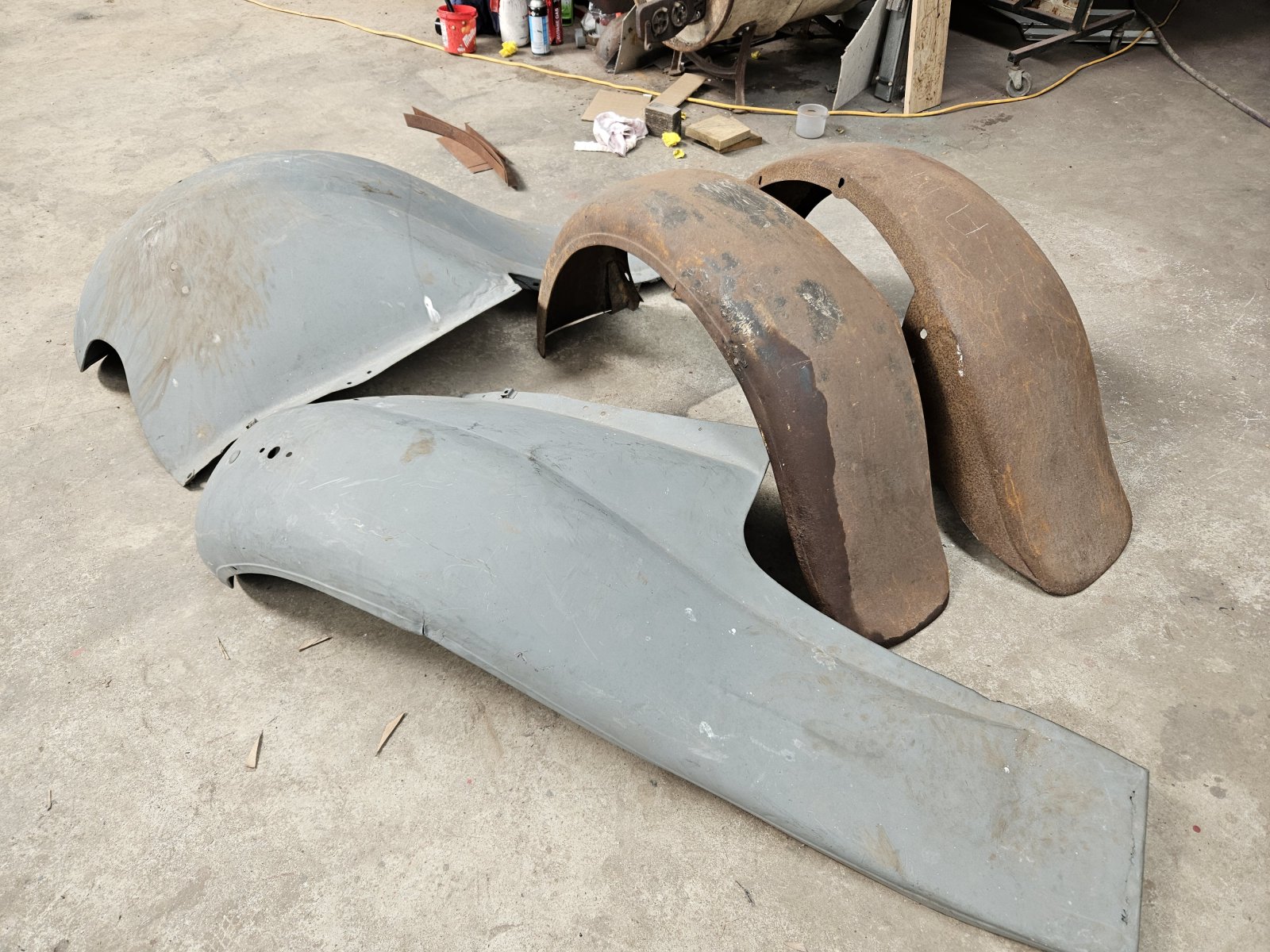

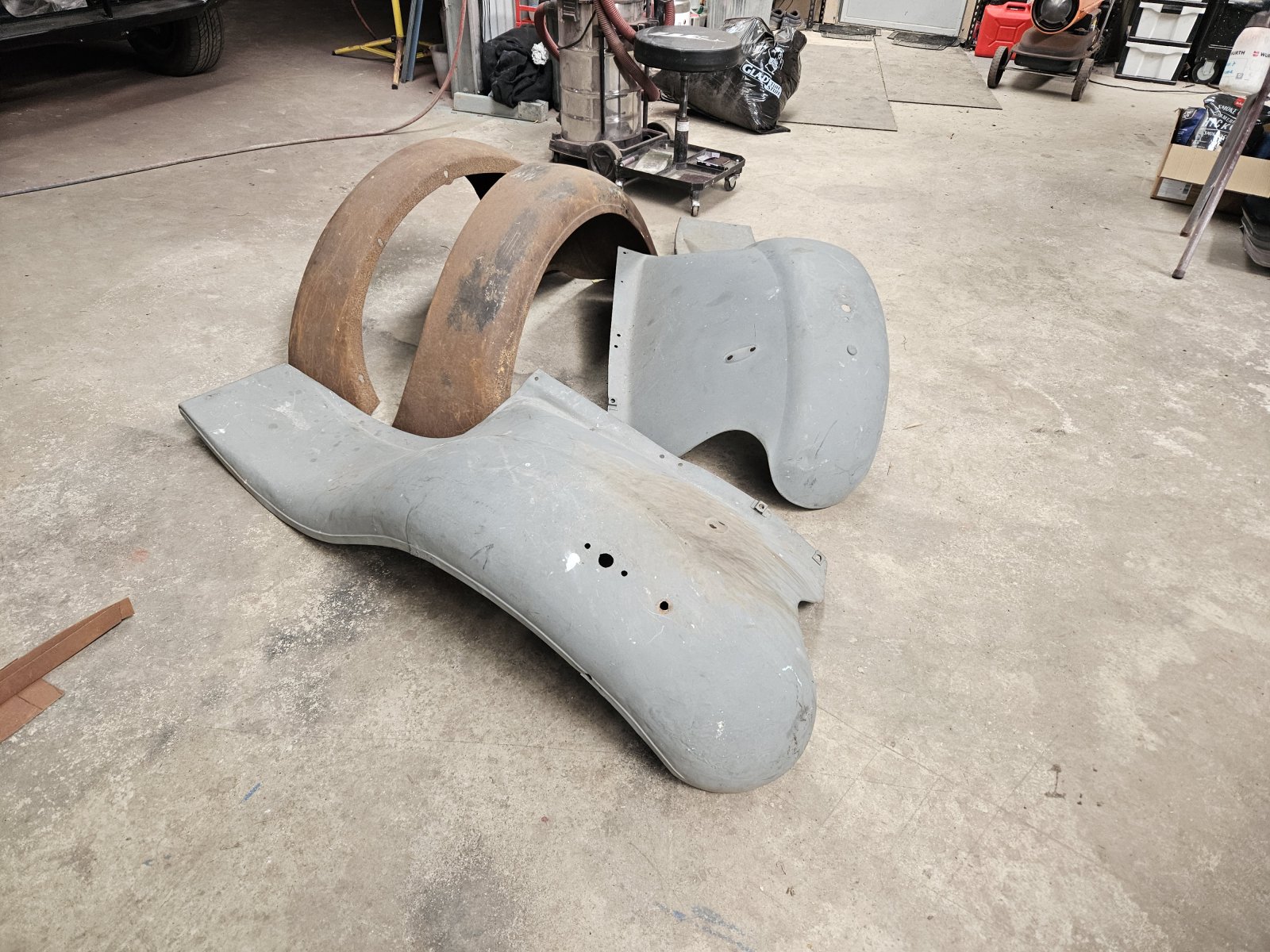

    Picked up a set of steel fenders this week. Need plenty of work, but hard to come by in this part of the world. 20241003_134253.jpg 20241003_134259.jpg

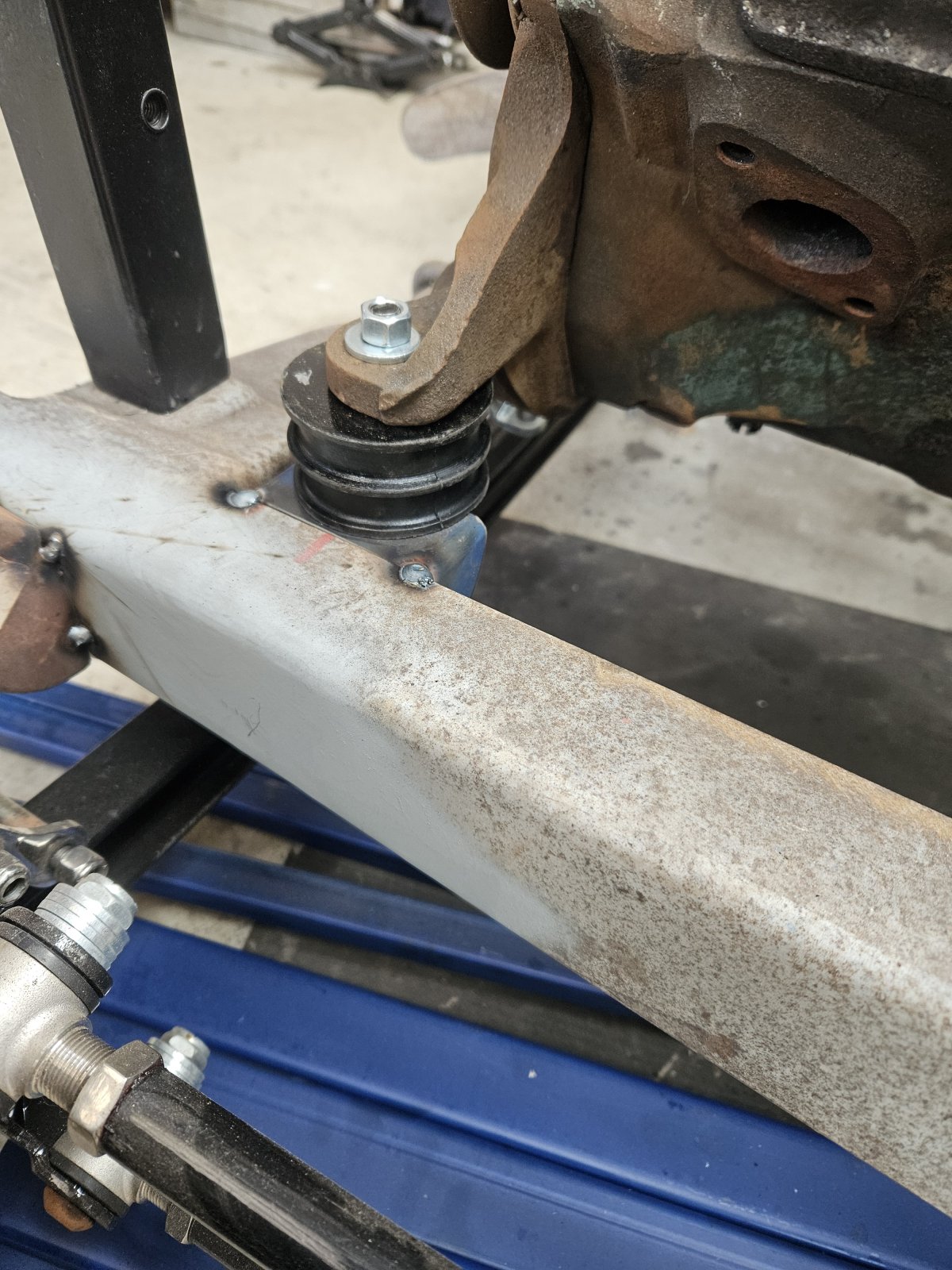

  14. GTHOtrod
    Posts: 45
    GTHOtrod

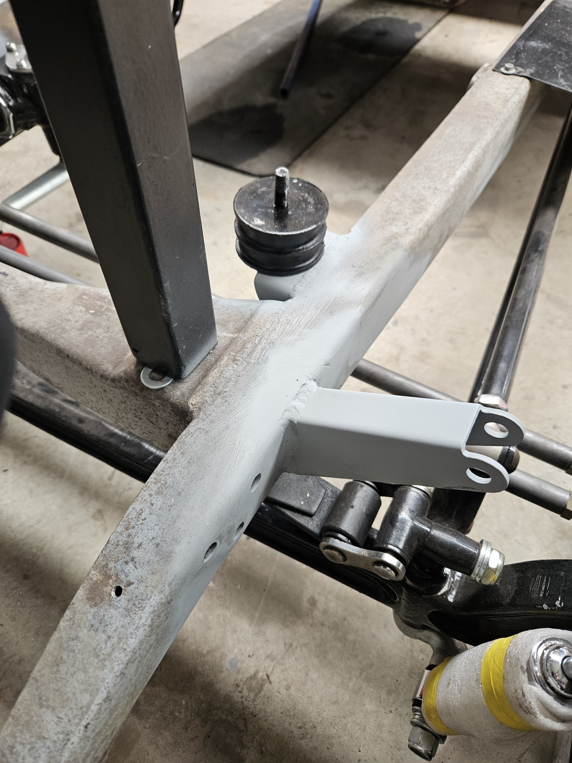

    Got some time today to get the shock mounts, engine mounts and steering box plate welded in.

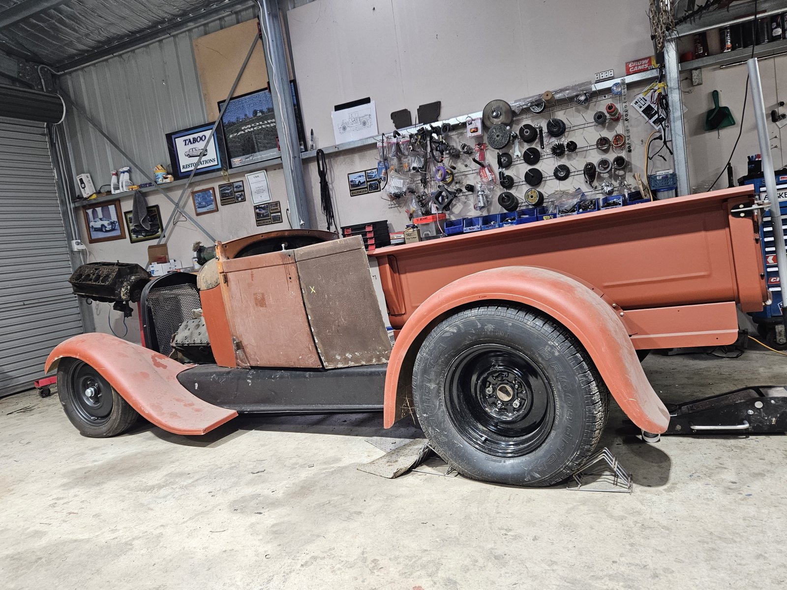

  15. 51 mercules
    Joined: Nov 29, 2008
    Posts: 4,418
    51 mercules
    Look like sedan rear fenders?
    guthriesmith likes this.

  17. GTHOtrod
    Posts: 45
    GTHOtrod
    Yes they are. I'll have to add a new flange for the pickup bed, and add a little width at the same time
