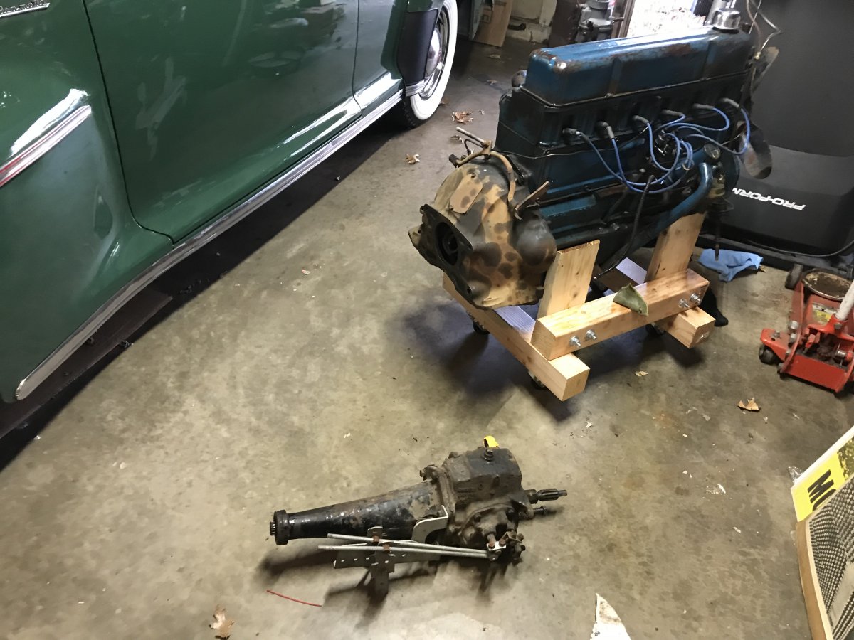

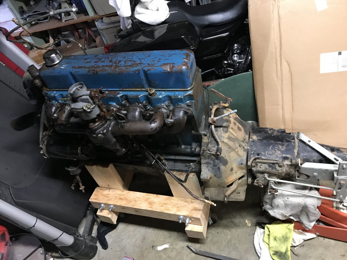

    I recently picked up a 1956 235 engine and it came with the transmission hooked up. I have no need for the transmission and would like to remove it from the bellhousing but seem to be struggling. I have unbolted the ****** and pried it out a little bit but it is not budging. Any insight into what I am doing wrong or pointers that will help for an easier removal? I’ve attached a couple pics for reference.

    I suspect you need to keep trying with a large screwdriver or other bar until it pops. Looks like it may be a little ****ed holding it up. Get a pry bar underneath it to even out the removal. Your almost there.

    It should come off that way. Maybe stuck in the disc, through out bearing, or pilot bushing.

    Probably stuck in the disk. Try pressing on the release fork (will need BIG cheater) and it may "pop".

    two big*** pry bars, one on each side.
    But first, make sure both bottom bolts have been removed, they thread in from the front on those truck bellhousings.

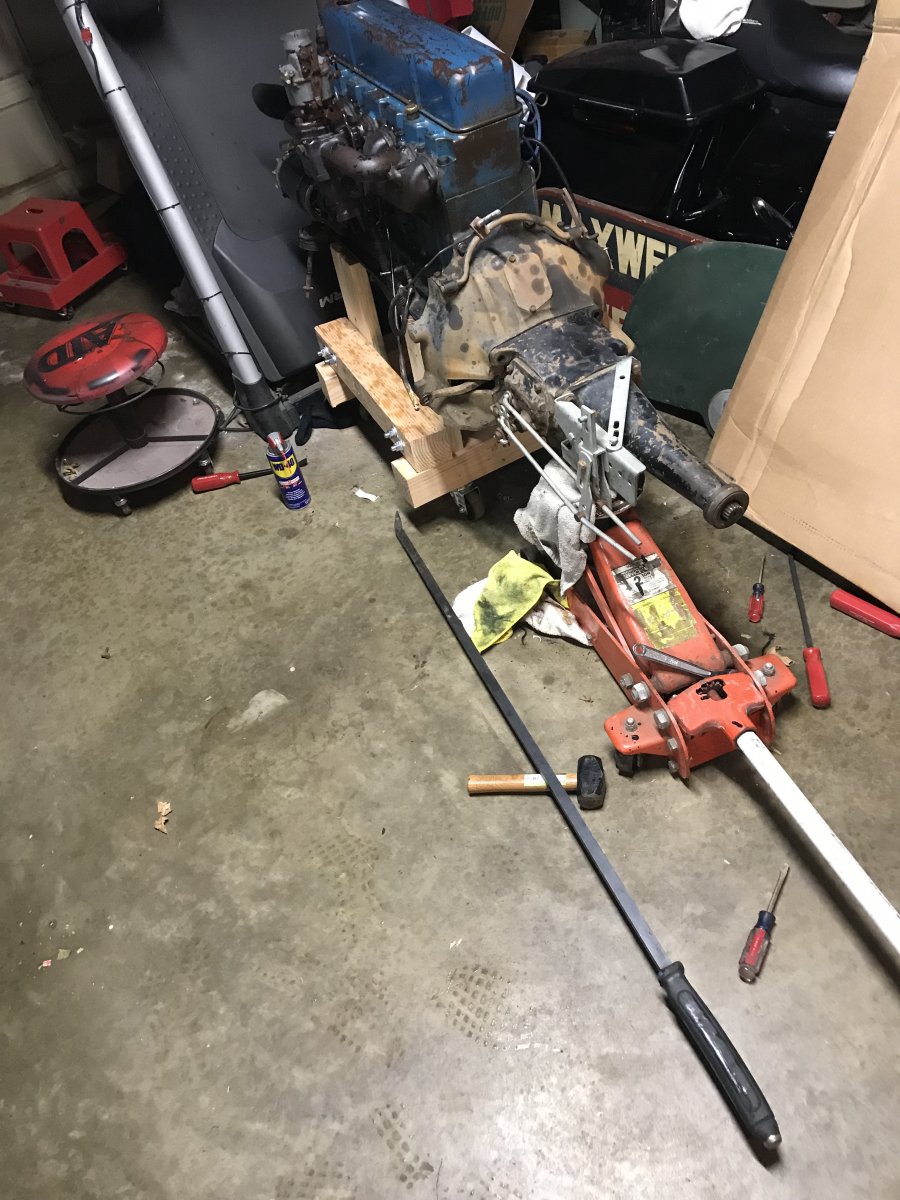

    Went out and fiddled around with it a little more this evening. The bottom right bolt head was broke off when I got the engine & ****** and I think that may be causing my problems as the bolt threads are still threaded (somewhat) into the transmission & not allowing ****** to move. (See pics). I think I might try and run a thin cutting wheel between the transmission and bell housing and cut the bolt off at its base and see if that gives me more room to wiggle my pry bar in & start prying away!

    like I said,the lower two bolts go in from the FRONT. That means, you will find the head of the bolt inside the bellhousing.

    What squirrel is trying to tell you is that your bottom bolt is not missing it’s head. It just that it’s hiding on the other end.

    Be very careful not to apply uneven pressure or that ear will surely snap off the trans. Even though you may n0t need it, it could be sold to someone who does. I always hate to see a good part ruined.

    There is probably some rust or crud on the splines that were sticking out causing it to hang up in the disk when you pull the splines through the disk.
    Big ******** pry bars and a buddy to hold up the end of the tail shaft to keep the input shaft from binding in the disk.
    As Reman said, don't pry on the ears and break one, even though the trans may not have any value to you it might be worth enough for a good burger and a couple of good brews to someone else.

    And we have success! Thanks Squirrel for the insight. I was able to remove the “inside” bolt and with a little prying the ****** slid right out. Next question, anybody want the transmission?
