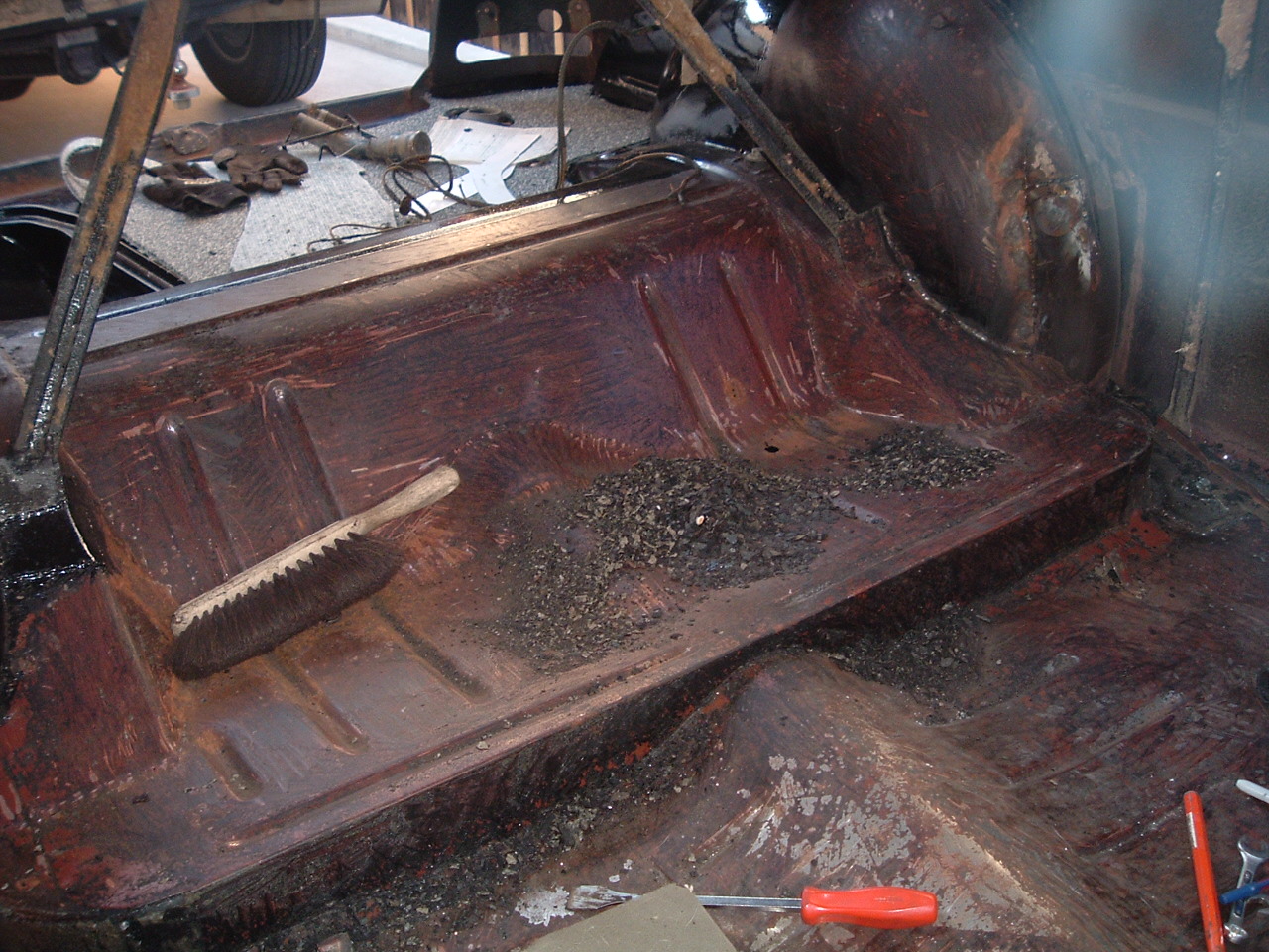

    I did both my 57's.. Thee worst job ever...... I used heat, s****ers, scuff pads, wire wheels, etc,etc..but the best tool was a needle scaler..... (in my case anyhow)
    Man.... everyday I looked like a coal miner.
    Wear eye protection and a VERY VERY good breathing mask.

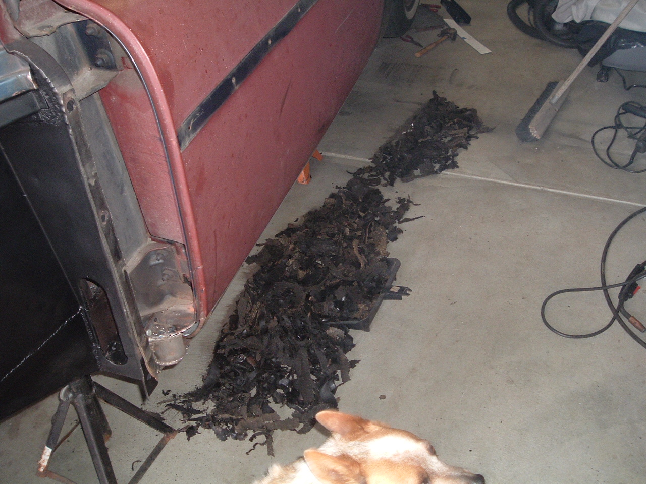

    I would try it dry first, might get lucky and it'll peel off in sheets
    Bandit Billy likes this.
