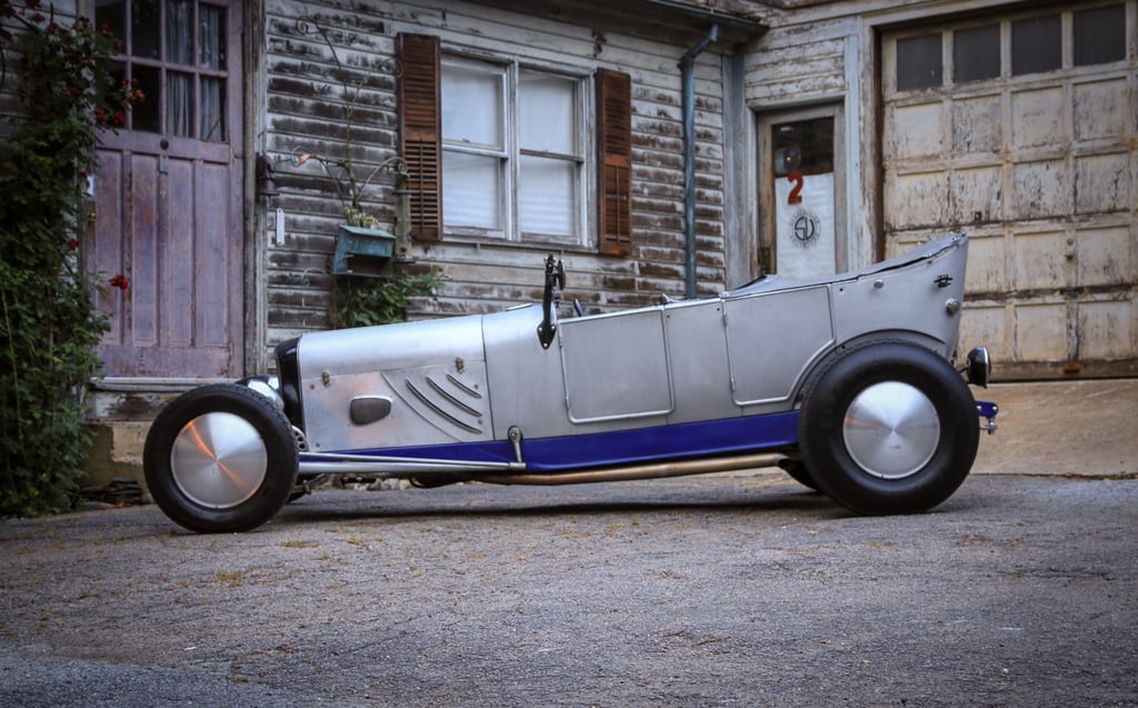

    Well, the frame is painted this intense blue so I was gonna match that. Hope I’m not ‘prettyfying it’ too much. We’re also having the bomber seats reupholstered just so it’s a little less messy. [​IMG]
