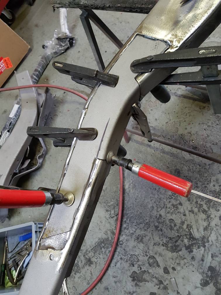

    Next I turned my attention to the original 1932 Ford rail. Almost the entire kickup had to be cut out. I only cut out the rusted and distorted metal but that was almost the whole lot.
    Here I have a scary big hole.
    And here's the piece which failed probably in the 1930s.
    So next up I slipped in the reinforcement piece and welded it firmly in place. Normally if fitted to good rails or ASC rails these just need spot welding in. In this case it got welded in properly.
    After it was welded in I made a paper pattern and found the replacement metal in the 1946 kickup I was holding back. Cut to shape here it is fitted.
    I then welded in the replacement outer skin. After blending you can hardly tell it's new (er) metal. This is the inside reinforcement plate.

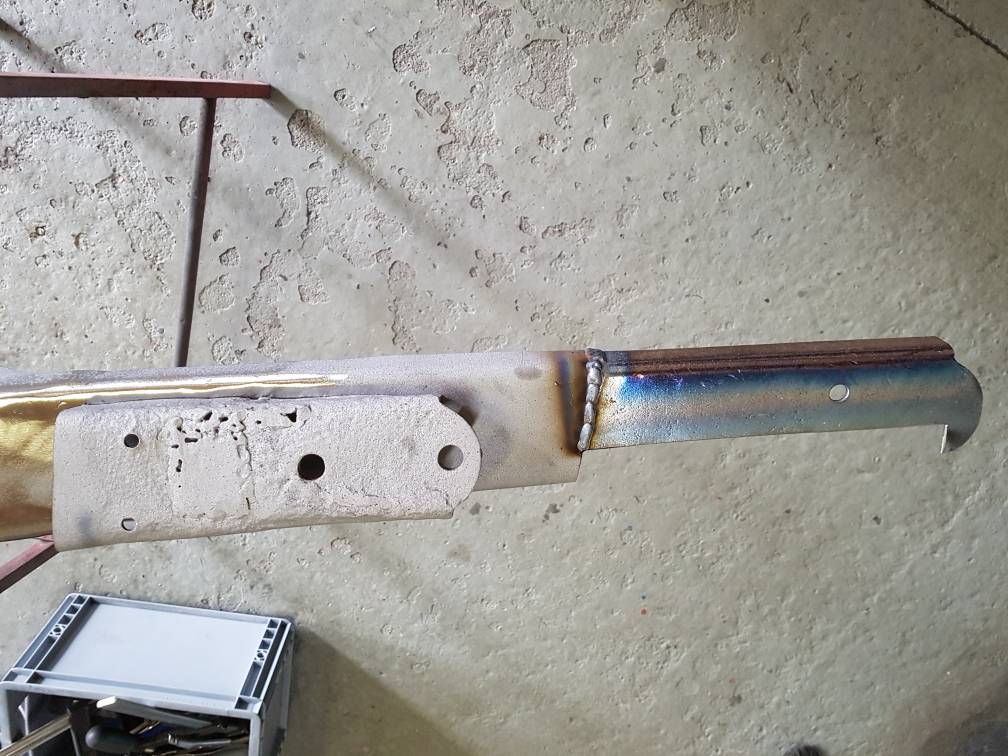

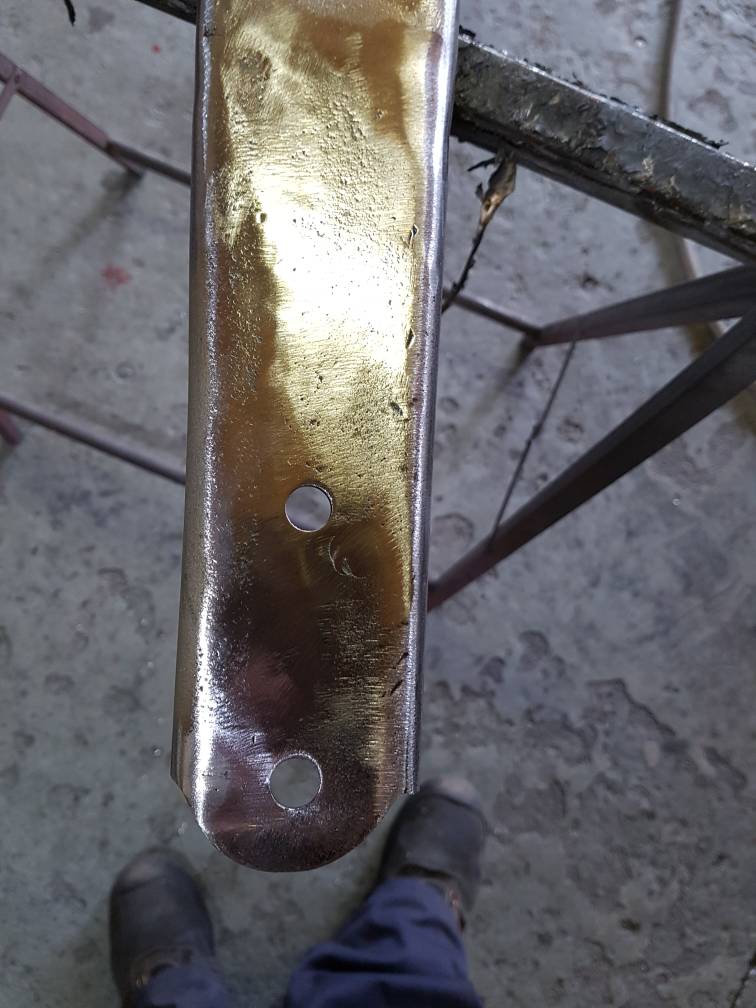

    As if that wasn't enough, the rear horn was toast too. Here it is lopped off, with its replacement taking shape.
    The horn was also made from the 1946 steel with a new spreader bar reinforcement plate welded in.
    And here's the repaired rail from the outside.
