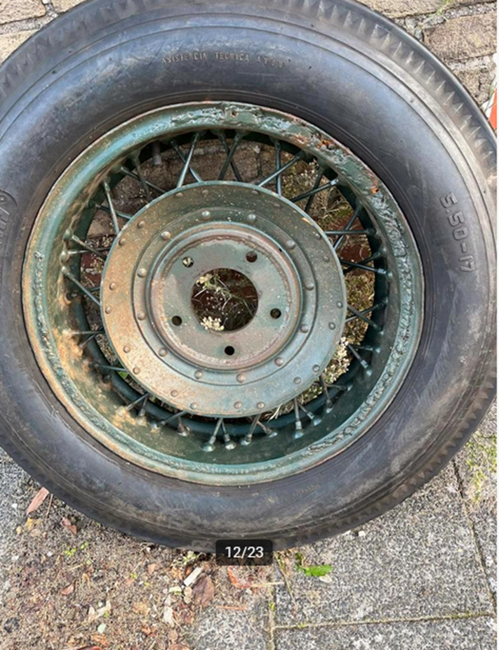

  27. Heres how it gets done in Uruguay. These were on a import project. Tires were new.
    Beanscoot, Squablow and Tumblin' Dice like this.
  28. clem
    Joined: Dec 20, 2006
    Posts: 4,596
    clem
    Pie crust tyres, awesome.
    I can’t help wondering if they were imported into a country that stipulates vehicle/ project vehicle must be on new tyres, as this is something that I came across recently ?
    No rules about the rims maybe ?
