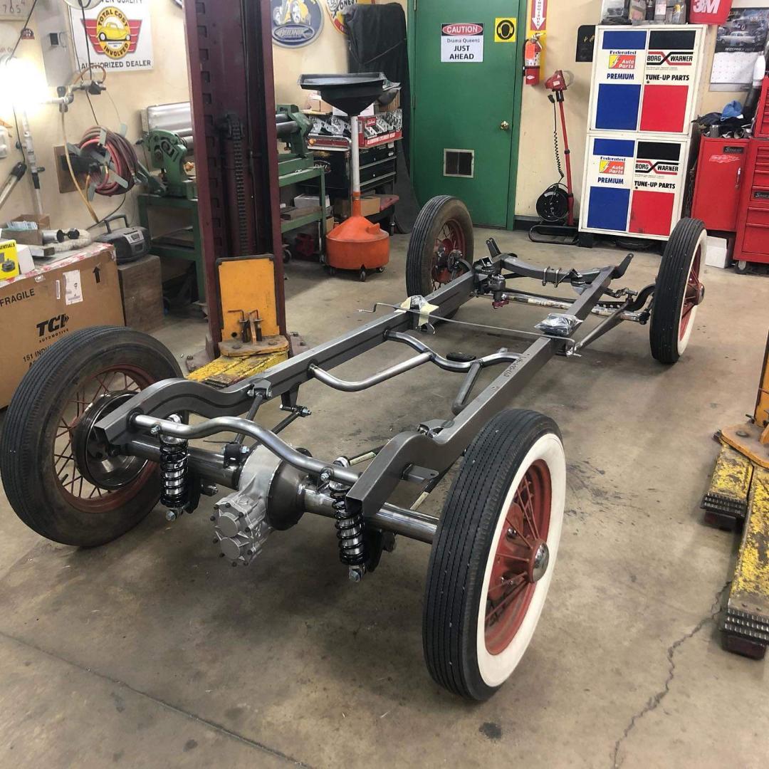

    Maybe one of these?
    pprather and Just Gary like this.

  19. RodStRace
    Joined: Dec 7, 2007
    Posts: 9,290
    RodStRace
    Terry, sounds like you've got it now. The first question sounded like you were a bit lost.

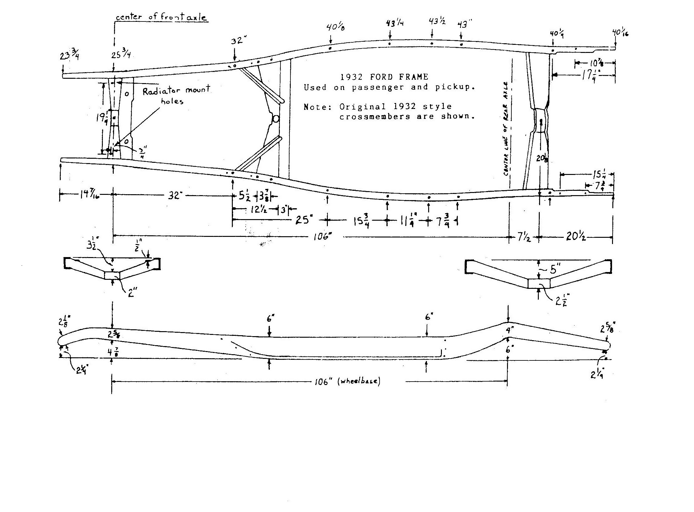

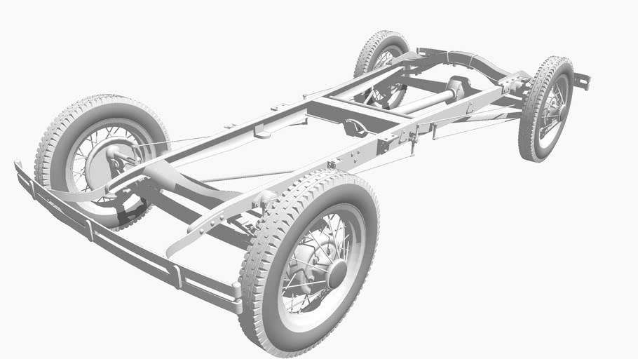

    See, the Model A ch***is fits all the usual mechanical bits and the body. The bottom of the body is flat, and a certain width and length. That means the A ch***is fits best. Later cars have ch***is that are curved, both vertically and side to side. They require so much work to make fit that it's easier to start with straight tubing to fit the flat bottom. The 32 frame was shown previously. Here's a 3d of the Model A. Later 33-up frames have even more curves and tend to be bigger.
    Terry Bjalme likes this.
