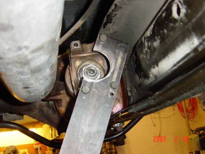

    put a rag between the ring and pinion gears. Or do it right...make a tool to hold the yoke still, just a long flat steel bar with holes to bolt to two of the U joint strap holes, and a cutout to let a socket fit on the nut.

    Sometimes just "zapping" it with an impact wrench will remove it without holding it. Besides the rag between the gears, I have also had success by putting two bolts in the yoke and holding it with a pry bar, or holding the yoke with a very large pipe wrench. The best way is to make a simple tool as Jim suggested.

    from at the gym
    pics
