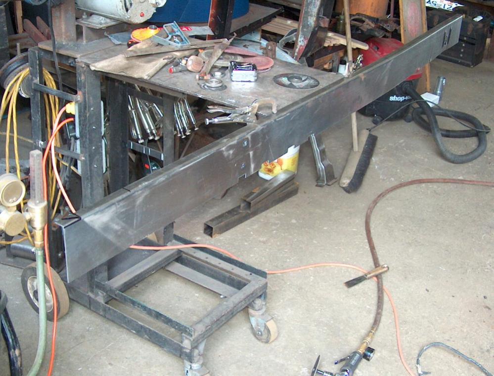

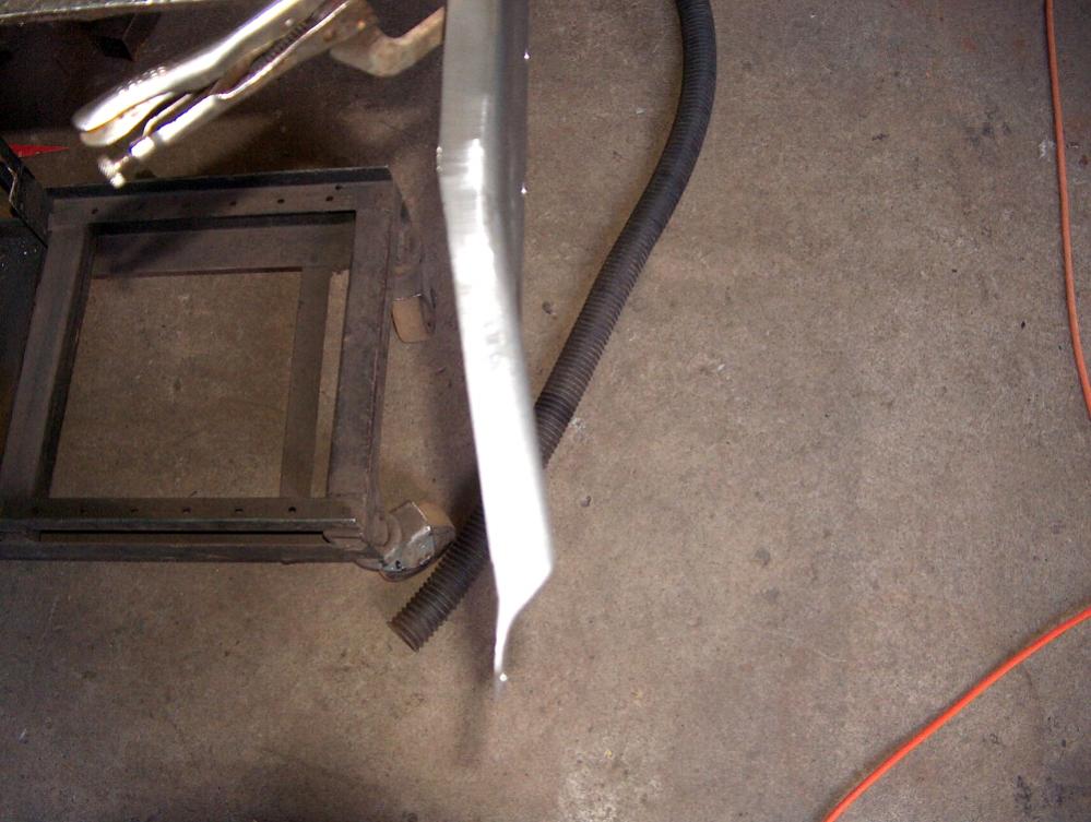

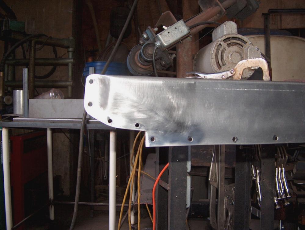

    i just replaced the p***engers inner rocker on a 64 last year, also part of the brace that goes under the seat front, heres a couple pics of the inner rocker the way it came and how i rebuilt it to fit. also as you can see there is and inner, middle and outer rocker, i only used the front half of the inner rocker, patched the inner rocker, cut the brace and only used what was needed and made the patch for the floor pan myself.

    Budd That is what I needed. So you did reuse your factory braces ? And are those bought or built rockers
