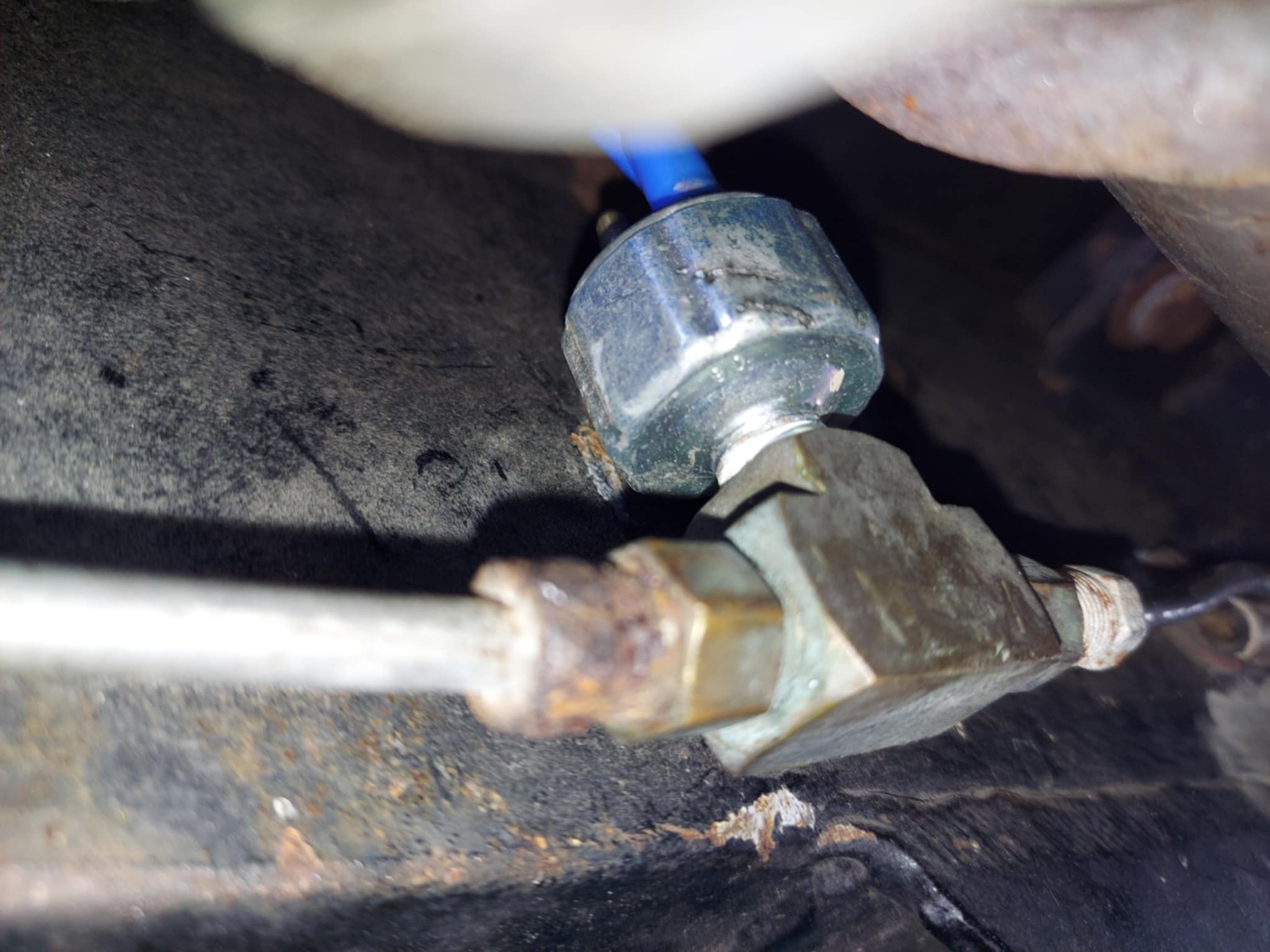

    Have to replace a faulty brake light switch. Not done one before. Have ordered up the Harley version I have seen mentioned in other posts on the HAMB.
    Am I right in understanding that if someone keeps pressure on the pedal I can replace it without having to bleed the brakes?
    Looks like the last time this was done thread tape was used. Presuming I do the same?

    No peddle pressure. Remove and replace, all should be fine.

    Just make sure when you pull the old one you have the new one right beside you and ready to go back in, do it quickly....

    It's a tapered pipe thread, so thread sealer might be useful...or the part might come with some already applied?
    or someone will mention that the tapered threads on brake parts are self sealing.

  7. Everyone above is spot on. I just did this a couple of weeks ago. Switched it quickly, used just a couple of wraps of Teflon tape, switch is about even with the master cylinder. No problems. The Harley-Davidson part number you'll want is 72023-51E. It is physically smaller than most on the market, but it works, which is also different than most on the market.

    Just did one one screw out screw in no pressure.

    No need to hold the pedal, just have the new switch ready to install with some thread sealant on it. Wham, bam, thank you ma'am.

    You don't want someone's foot on the pedal unless you like gettng brake fluid in your eyes. you do not want pressure on the system when you change it.
    As others said, it is best if when you unscrew the old one you have the new one in the other hand to screw back in.

    Have installed the new switch but alas still no brake lights.
    Switched the wires on the terminals and still no brake lights.
    Connected brake light wiring behind the switch to 12v and they work.
    Quick sanity check please. The wire to the switch should be powered when ignition is on?

    The wire to the switch should be powered all the time if it's an American car, or only when the switch is on if it's foreign. In other words, you can do whatever you feel is best for you.

  25. Power in power out when pressure is present on the switch (closing the contacts) or manually closing them without it hooked to the master. If you have power into one side (doesn't matter which side) and no power out with brakes applied, you have a bad switch. Jump both wires together off the switch and test the rest of the circuit. The old mechanical brake light switch from a Chevy truck works great (all my cars have been converted to these), but even these you need to find a good quality switch.

    Test with wire as Jim suggested. If that fixes issue, you're finished.
    If not, test switch as shown in video. If switch is good, it may have air bubble.
    Have your helper pump brake pedal and hold down. Loosen switch slightly, air and fluid will be released around threads. Tighten switch. Release brake pedal. (Same process as bleeding a wheel cylinders brake line).
