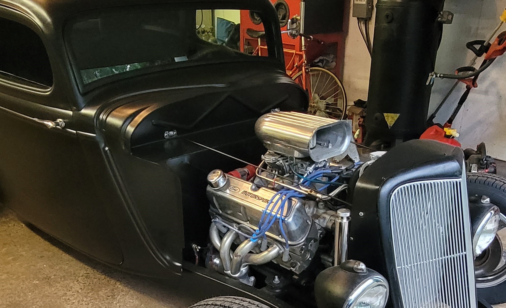

    A '34 project at my kid's place; SBC, short pump, fan close to the radiator, tried to get it in there but still needed to cut a little recess to fit the distributor (not cut at this point). The slant back of the radiator is the limiting factor.
    A CE kit worked good to replace the center of the X member. Also used a 9"
    on a Posies parallel leaf kit out back.
