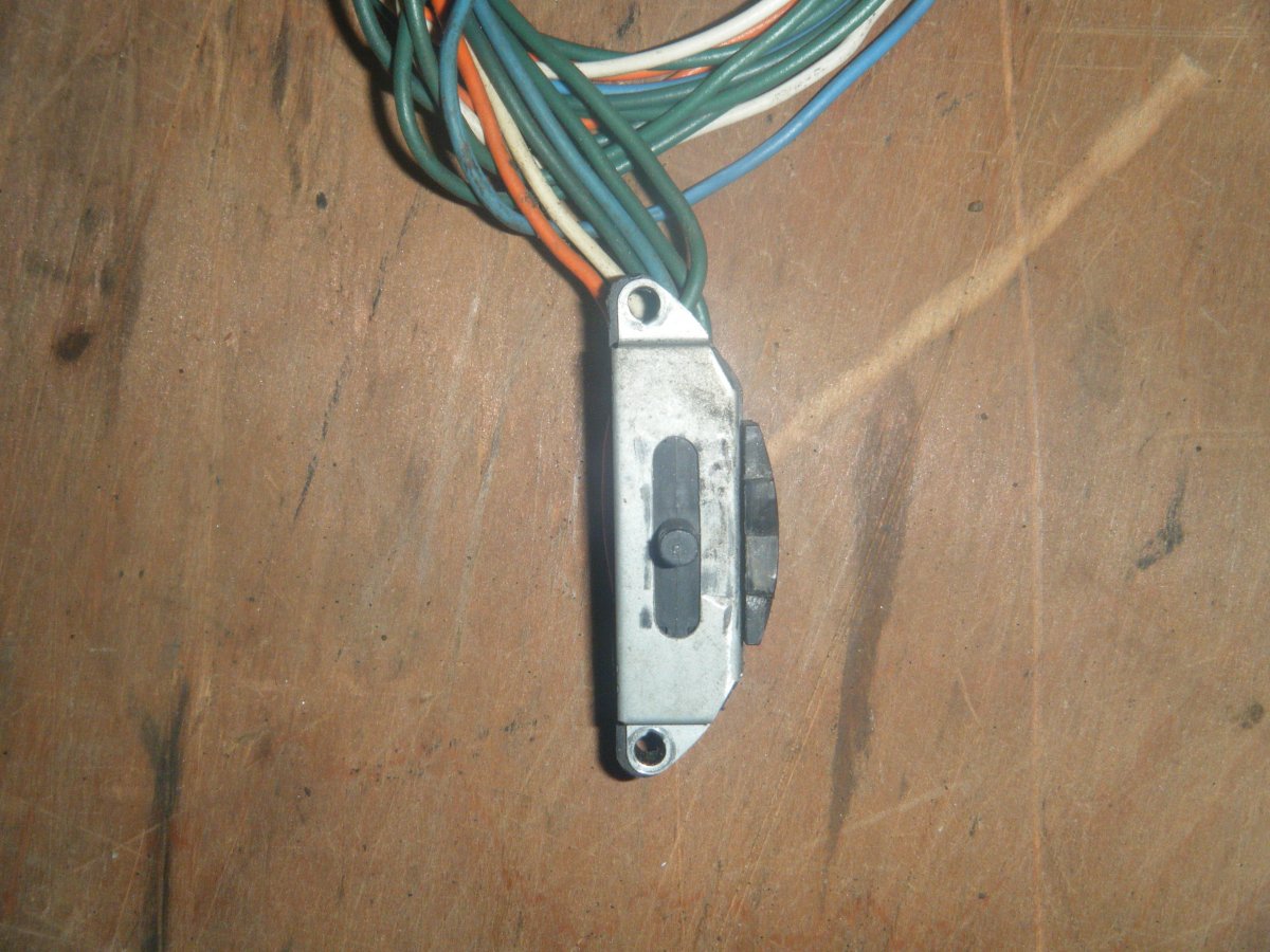

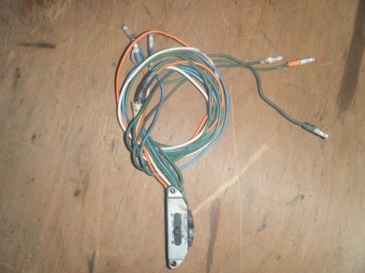

    I removed a few things and this is what I'm looking at. This doesn't look like the one in the second pic that I'm supposed to replace it with so is that going to be a problem? One thing I should mention is on my current steering wheel it says "Edsel Power Steering" in the center of it and my car doesn't have power steering so at least the horn ring has been changed. Could the whole steering column have been changed? If not then why doesn't my turn signal unit look like the one I'm supposed to replace it with? Like I said before, I want to be absolutely positive that I'm buying the correct one because electrical parts aren't returnable at this Mustangs Etc. place out in California and it's going to cost almost $200 with shipping. Thanks again....

    Lebowski

    AAHHHHH , the joys of owning an Edsel
    So heres the deal,what you have is a 59 Mercury steering collum. Standard shift vehicle (didnt know you had a stick car).
    I"m sure that you already know that they threw any leftover 59 parts they had that would fit for Edsels 1960 final year of production into the cars built to get them out the door.
    The necessary t/s switch fits Mercury - 57 and 58 ALL and 59 standard shift only.
    Not reproduced BUT eBay is our friend. Follow the links
    http://www.ebay.com/itm/NOS-1957-1958-1959-Mercury-turn-signal-switch-FEK-14486-A-Montclair-Monterey-/122078457542?fits=Year:1957|Make:Mercury&hash=item1c6c716ec6:g:Yr4AAOSw6n5XqlUV&vxp=mtr
    http://www.ebay.com/itm/NOS-1957-1958-1959-Mercury-turn-signal-switch-FEK-14486-A-Montclair-Monterey-/122076639791?fits=Year:1957|Make:Mercury&hash=item1c6c55b22f:g:STEAAOSwbsBXqAC8&vxp=mtr
    Both of these are being sold by the same person. The second link is a Best Offer situation.
    Offer the seller a reasonable "Best Offer" price and cut a deal.
    The eBay seller offers a 30 day return policy.
    Now,I also have a N.O.S. unit in the box. But I paid more for mine than what is currently on eBay.
    The t/s switch pictured above is bad and came out of my 57 Mercury Commuter wagon.
    Thats how I was able to identify what yours is.
