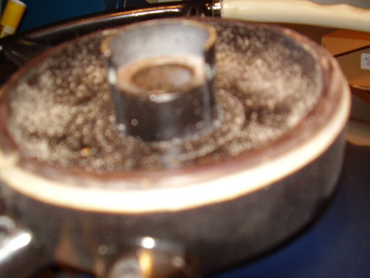

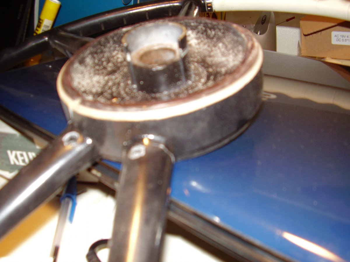

    Yes, there is a piece sticking down on the bottom of the steering wheel. So that's what cancels the turn signals? OK, cool. Now I just need to figure out what holds the turn signal lever up or down. I think it has something to do with the piece with the 2 small springs that I posted yesterday. Any ideas? Thanks....

    I checked the Lowe's, Tractor Supply and Ace Hardware websites for C clips and none of them showed anything. Is this the spring and "little cup" that you're referring to? Am I supposed to put the open end of the spring in the cup and stick it in the little hole in the steering wheel to make the horn work? Also, what is the piece with the 2 little springs for that I posted yesterday? Is it supposed to hold the turn signal lever up or down somehow? Those springs are just sitting there doing nothing. Thanks...

    The spring and little cup were in the steering wheel before I started. Is that what you mean? So I guess all I need is a little C clip and someone to tell me how to get the turn signal lever to stay up or down. I was thinking about putting the steering wheel on and taking it for a drive since it's sunny and in the 60s today. If I need to use the turn signals I'll just hold the lever up or down. At least I finally have two brake lights. Thanks....

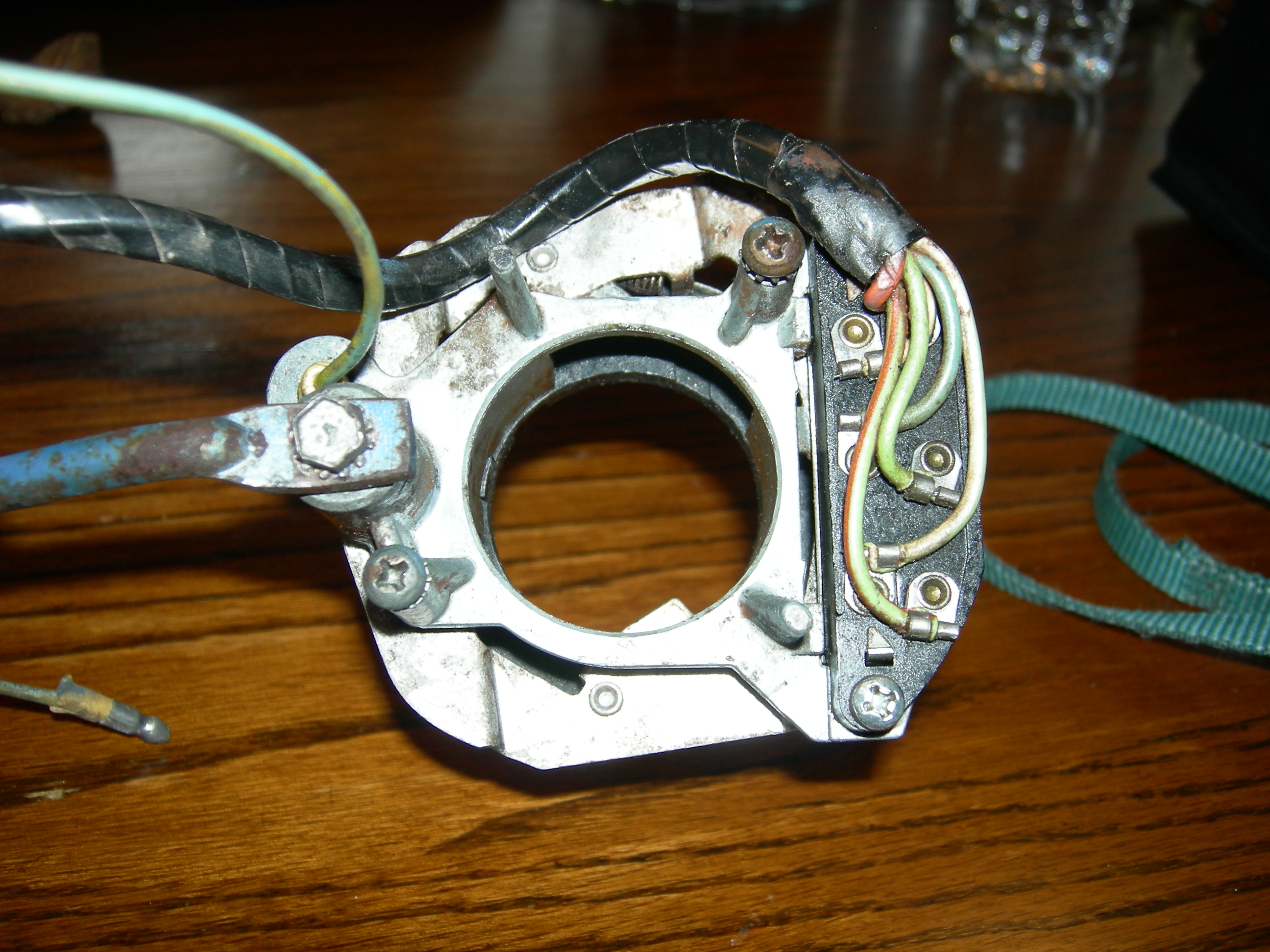

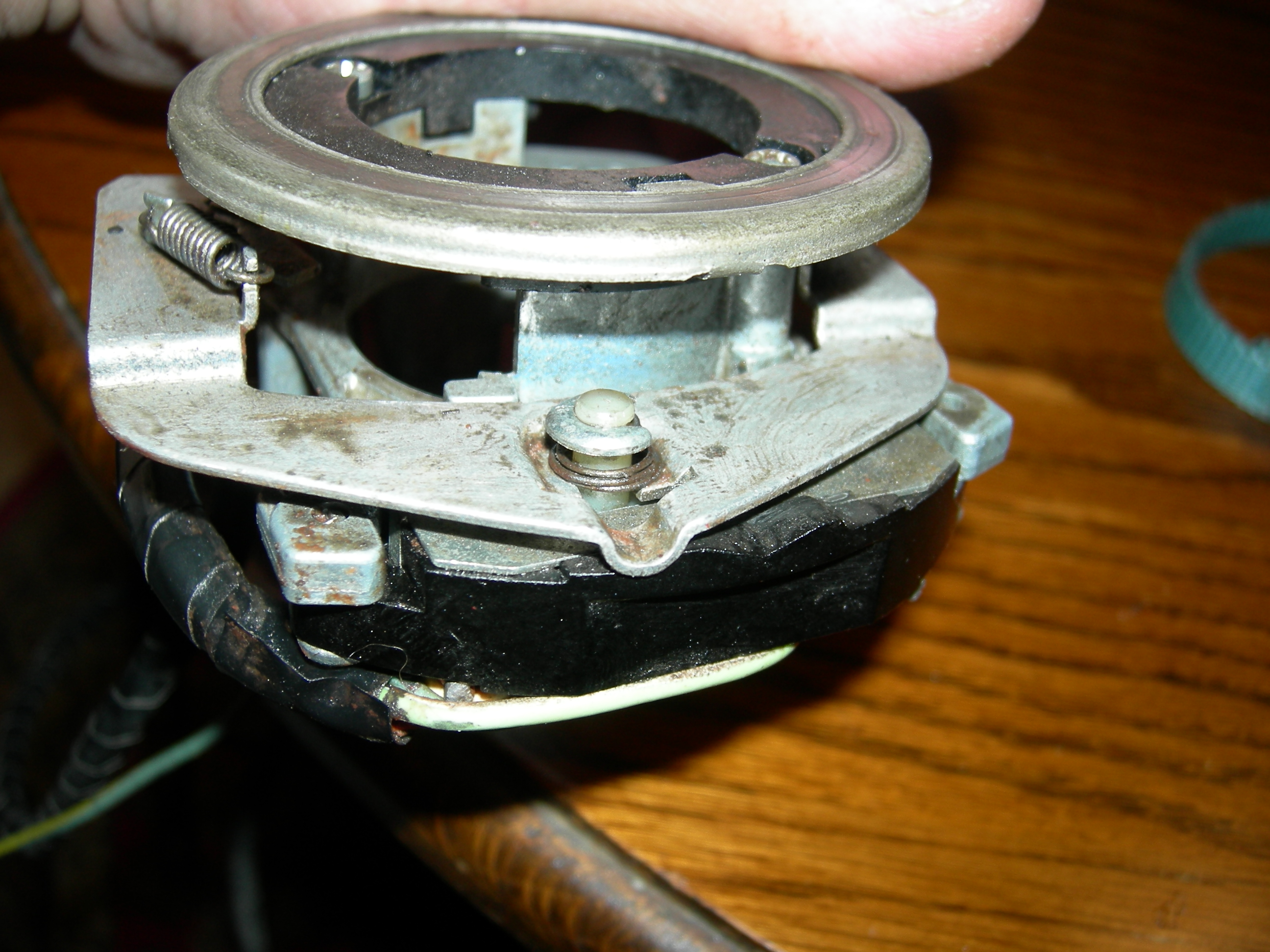

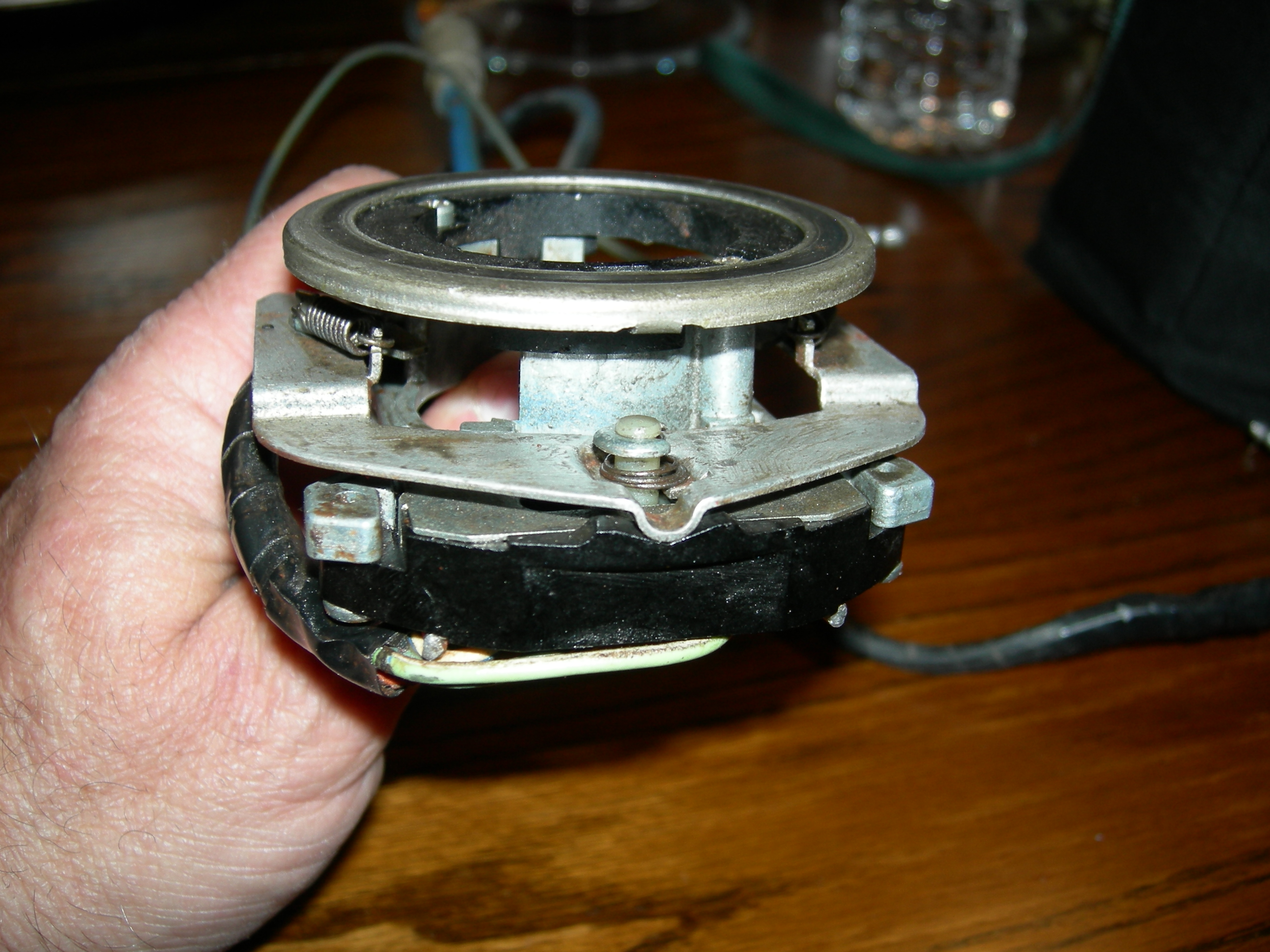

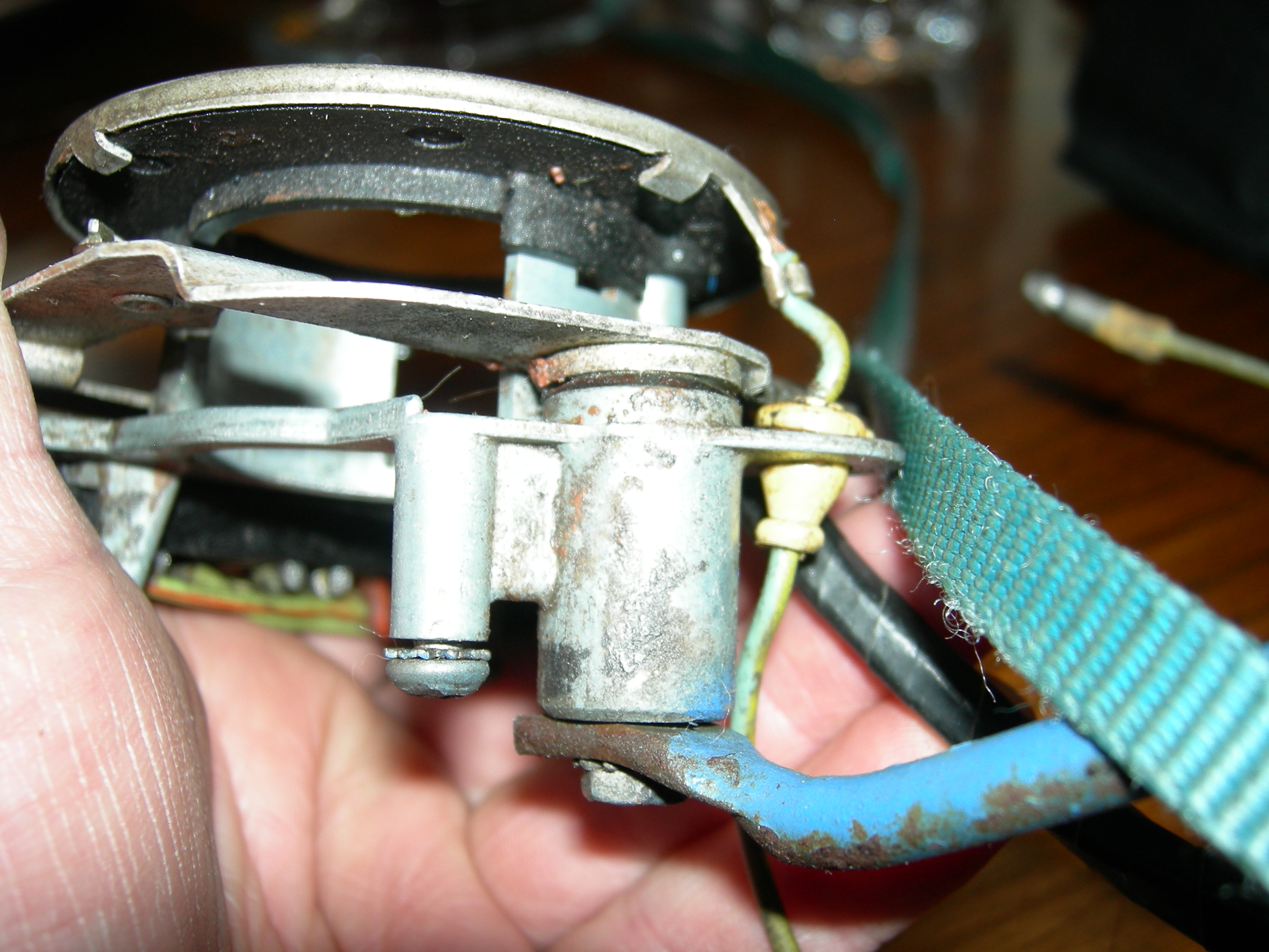

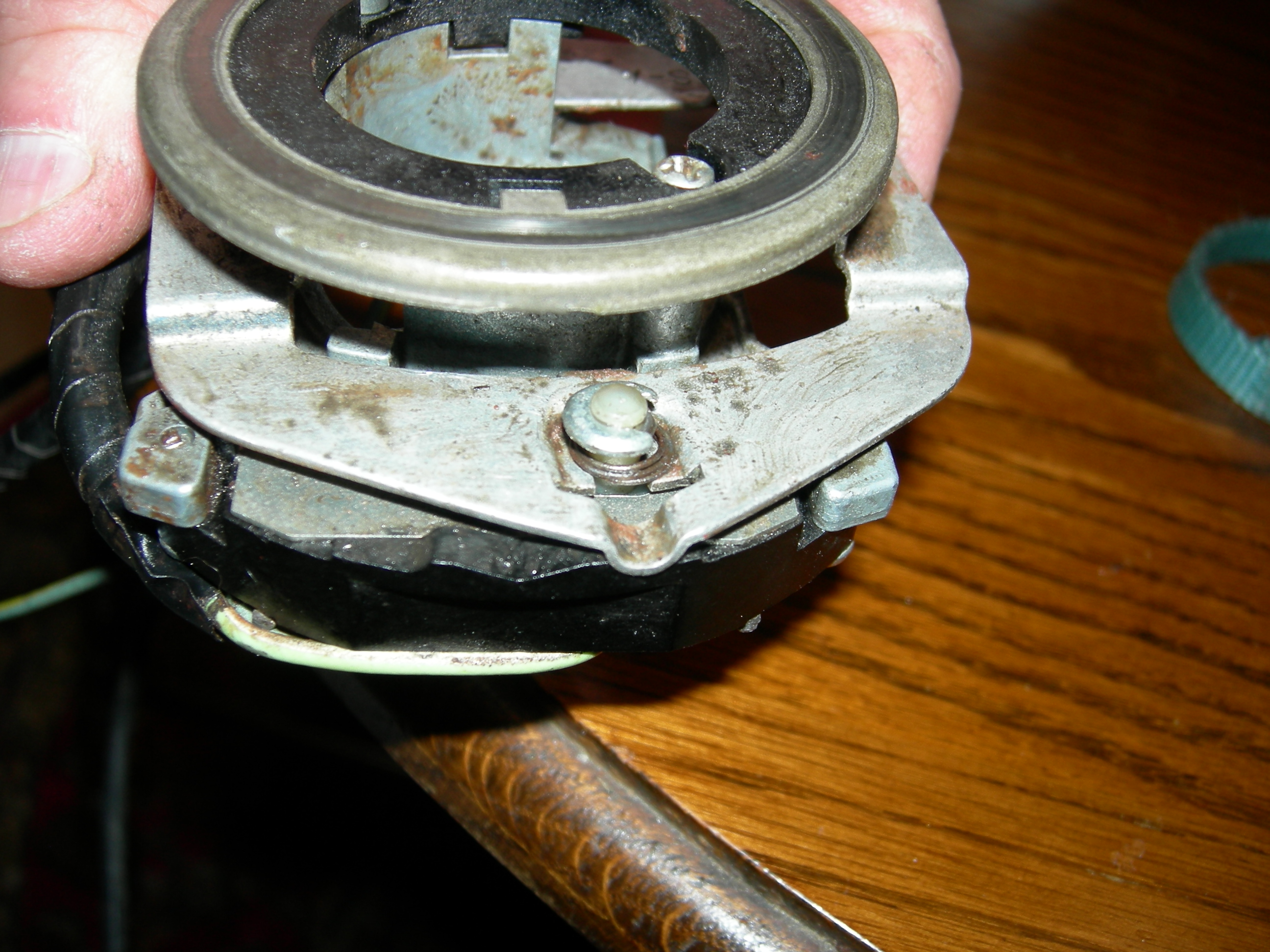

    Your right, your last pictures the spring and cup go under the steering wheel to operate the horn. I took some pics of a spare assembly I have that I think is like yours. As luck would have it, my left brake light has quit so I will probably be putting this switch in mine this week end.
    The left side with the spring-washer:
    a shot of the lever centered with the spring and circlip in place:
    Left turn:
    Right turn:
    Wiring colors:
    Hope this helps. Now I have to fix mine again.

    Thanks for the pics. In your 4th pic from the top with the spring on the left side can you see if it is attached to anything or serving any purpose? Those two springs probably have something to do with holding the turn signal lever up or down because why else would they be there?
    I'm going to stop by the local Ace Hardware store tomorrow and see if they have a C clip or if not if they know where I can get one. Is it called a C clip or circlip as you call it? Thanks again....
  15. bedwards
    Joined: Mar 25, 2015
    Posts: 280
    bedwards
    That is one of the two springs and levers that catch the cancelling ring as it rotates by. When the signal lever and plate is off center, (right or left signal flashing) the cancelling cam turns with the steering wheel and catches one of the levers and pushes it back until the whole plate and the turn signal lever is in the center.
    Its a C clip, I am calling it the wrong thing. I guess a circlip is like a snap ring that you need special pliers to remove. A C clip just snaps in place.

    So that's what those 2 little springs and levers are for? Thanks for explaining that to me. So can you tell me why the turn signal lever won't stay up or down like it's supposed to? If I find a C clip and put that little spring on the plastic piece will that solve the problem or is it something else?
  17. bedwards
    Posts: 280
    bedwards
    I should fix it. It holds the indentions in the plate to the indentions in the switch to keep it in place until the cancel moves it or you do.
    I hope you still have the two levers that go with the springs and the collar that goes on the shaft to make the whole cancelling thing work. =]
  18. Lebowski
    Joined: Aug 21, 2011
    Posts: 1,564
    Lebowski
    Are you referring to the piece pictured in post #101? If so then yes, it's still in there. Hopefully there aren't any missing pieces. So if I find a C clip and put it in along with that little spring then the lever will stay up of down? I'm going to stop by my local Ace this morning and see if they have them....
  19. bedwards
    Posts: 280
    bedwards
    I would think so. That should provide enough friction to hold the lever in place when you move it.
