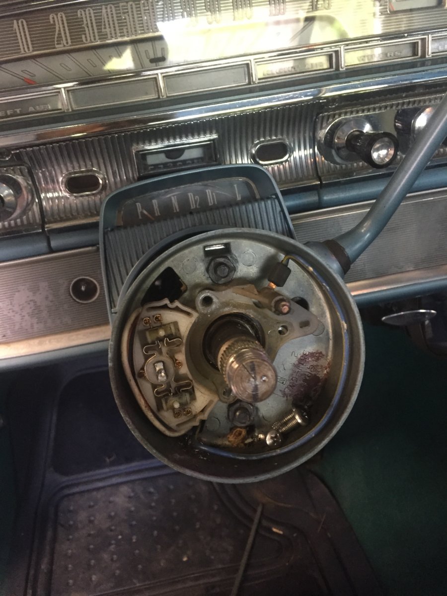

    That is an broken/incomplete switch. That is why it does not work, at all. It also makes it harder to ID.
    Your cancelling cam, which has the electrical contacts in it, is missing.
    Try: C3OZ-13341-BR

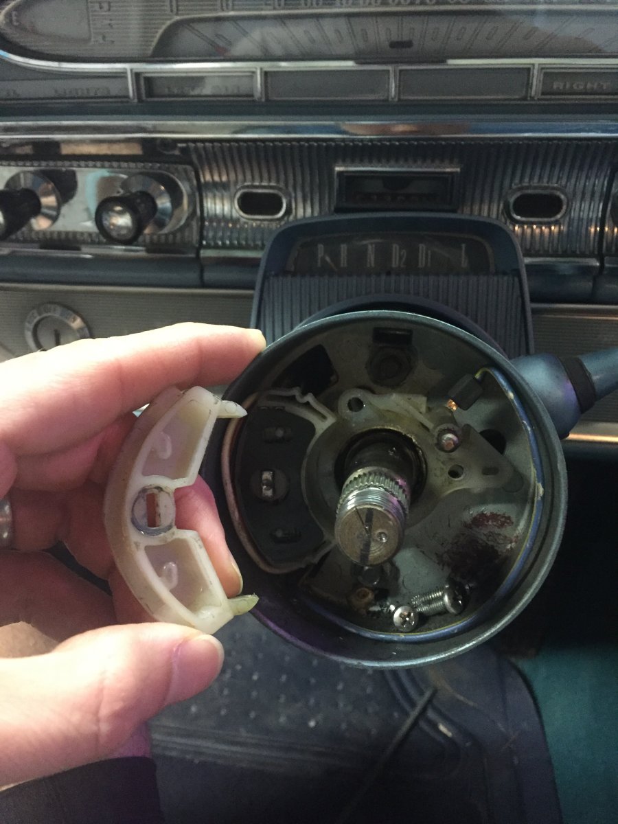

    Thanks! i took the canceling cam off to take the pic. The cam doesn't have any contacts in it. Underneath the cam was a thin black plastic ish piece. I put it back in place for this pic... Does this help with ID?

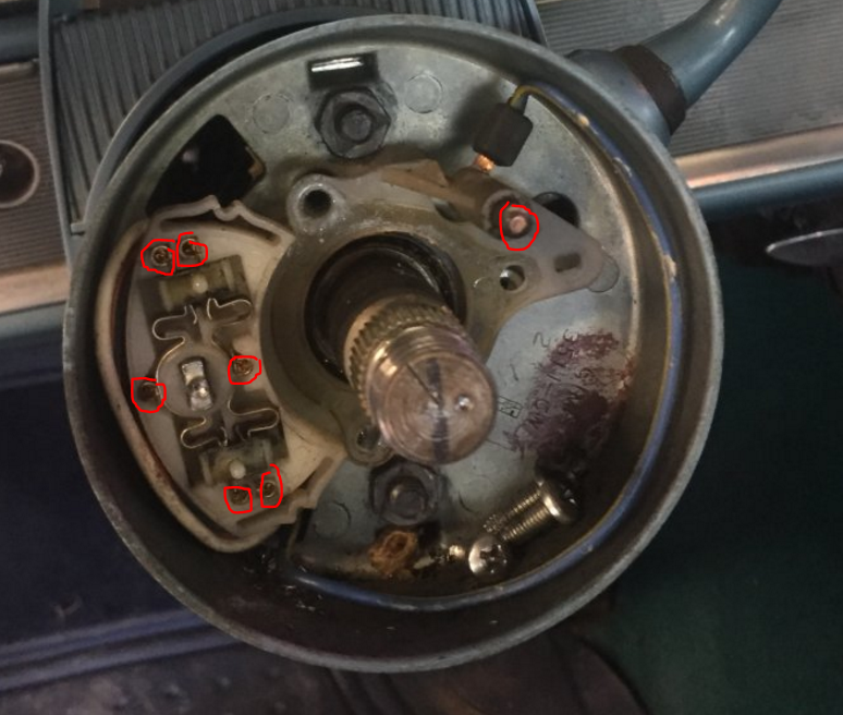

    I count seven wire terminations:
    The part number that I gave you is a revised number. I believe that, despite its slight physical difference, it should work for you.
    I think the original part would have been C1MF-13341-A.

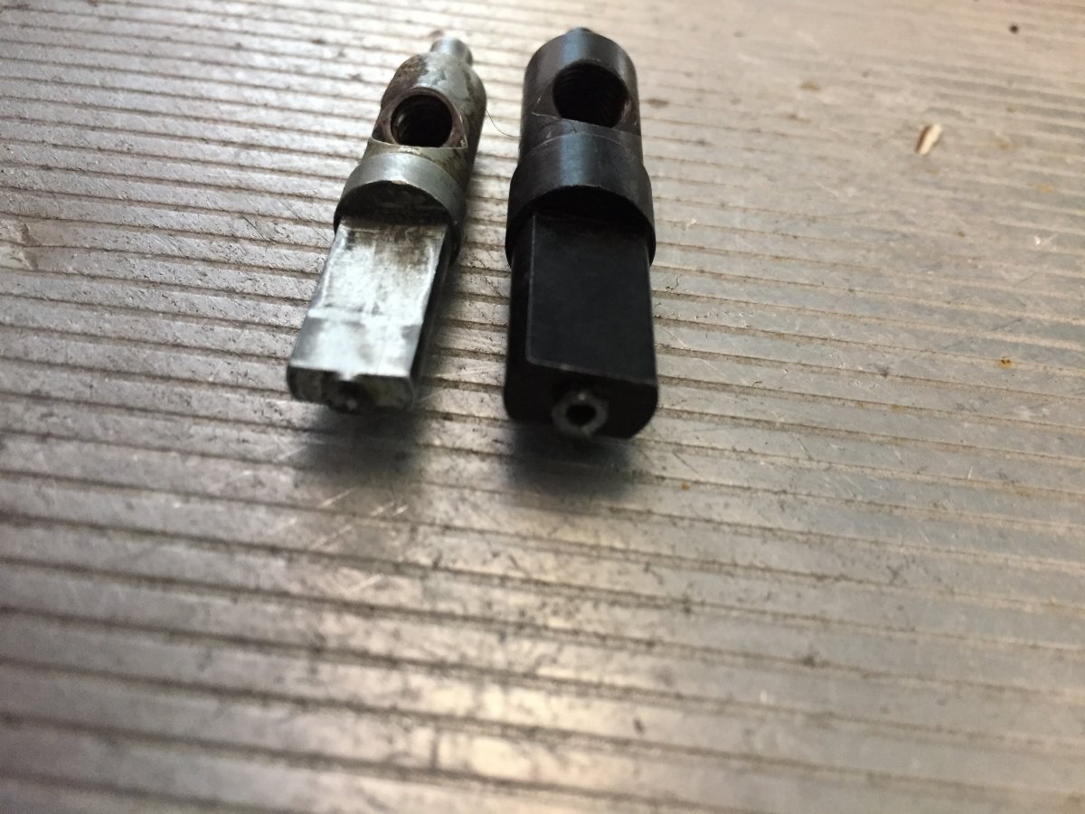

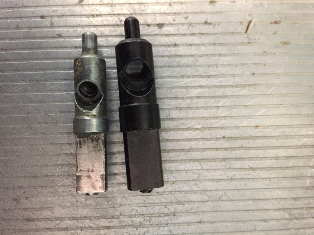

    Gimpy, the turn signal lever connects to the machined shaft of the switch. Unfortunately the shaft on my mercury is smaller than the mustang switch you suggested. I'm going to talk to a friend with a mill and lathe and see if there's anything he suggests. might have to end up cutting them in half and trying to weld the halves i need of each together. Dang! I really do appreciate the help though! it was going so smooth until the very end...

    You just need him to put a Helicoil in the threaded hole of the bigger one, to accept the smaller turn signal lever, and maybe turn down the end of the big one no match the small one. That's simple lathe work.

    no the depth is different on the end with the ****** and it's like 1/8th inch bigger around... the location and angle of the lever threads don't match either

    Can you check to see if the width of the end with the machined flats is the same diameter (on the non-machined area, the part that still has the curved sides) is the same on the two.

    they are different, the batteries in my micrometer just died, but tape measure math says...
    new shaft 3/8ths
    old 5/16ths
    @gimpyshotrods

    I have had a bunch of Fords. Sadly, this is nothing new. I have seen as many as FIVE revisions in a model year....
    My mind goes straight to using the original pin, with the end with the flats ground on it, wrapped in shim stock.

    Figured i should update you... first off, thank you! I have a completely functioning set of lights now. What we did was wake a entirely new shaft for the 64 mustang switch. The new one we made incorporates the (mustang sized) square milled end with the mercury size pointy end. About 20 minutes of lathe and mill time that I a friend help me out with... Took her out tonight and she worked perfect. Thanks again!
