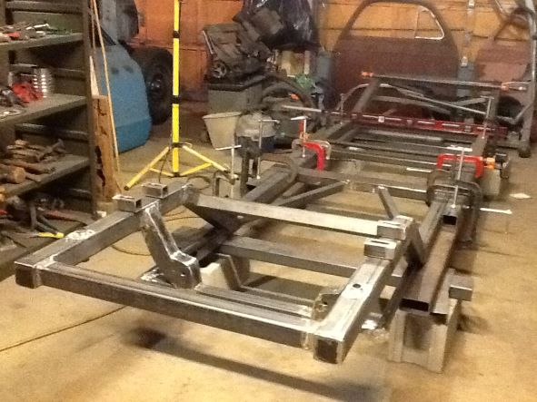

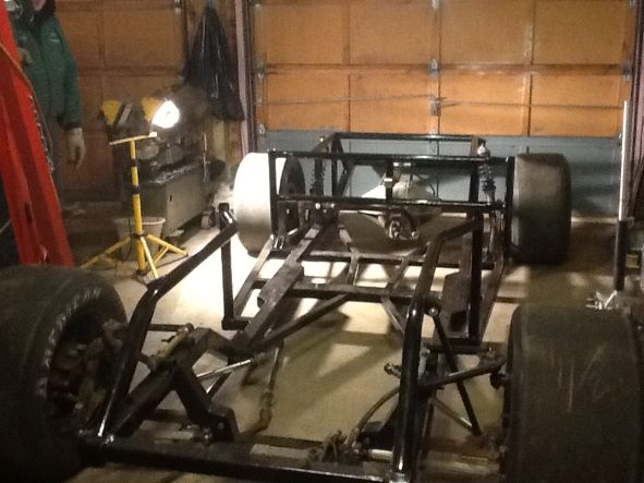

    winr, 1971BB427, Okie Pete and 2 others like this.
  11. gpohl6
    Joined: Sep 22, 2013
    Posts: 78
    gpohl6
    Scratch built ch***is copied a pro stock and eliminated driver offset (frame rails are "straight up" and the roll cage hoops and body mount are attached via "outriggers" to the ch***is. So far (5-6 years driving) all is working out okay. Unfortunately, it works best to do a pic at a time. I removed the coupe body (40 Chevy Master coupe - I could not source one of the smaller ones...and glad I got the larger one for the extra room). I cut about 9 inches off the bottom and rebuilt a floor, door bottoms, inner and outer rockers and firewall. I "squared up" the body at the A and B pillar after stiffening both with 16 ga steel. I used square tubing welded to the jambs at exactly the same height so when fitting the body, I cut garden timbers to blocks 7", 7.5" and 8" to adjust the height while test fitting to check what I wanted for body installed height. It is low, but little if any problem on the road.
    winr, hfh, Okie Pete and 2 others like this.

    I built on a couple of lengths of 2" by 4" steel tubing leveled across each other and about every way I could. No concrete floor is exactly level, but I selected the best area to use as my "build area". I built my frame in two sections front to rear. When I was all done, it might have been 1/16" off end to end and the suspension compensates for that. I clamped everything down tight and kept it that way until all the cross members were pretty secure and I joined the front and rear halves of the frame rails. Look...this was my first build ever. I worked 40 plus years in an office and although I could weld, I had no real ***ulative shop time. So...if I can do it, anyone or nearly anyone can do it! Just take your time and whatever you do, think ahead. I also bought an old "pro stock" ch***is and copied the front end design but eliminated the 17" driver offset and elected to employ "outriggers to locate and support the roll cage hoops and body mounts. Above all else, look ahead and make sure you don't "paint yourself into a corner" and saw off the limb between where you are sitting and the tree's trunk if that makes sense to you. Be bold and have at it. And yes, lots of very forlorn looking body shells are perfectly usable for projects like this! I'll locate some more pictures but am going to be away for the next couple of days so it will be a while. Thanks for your interest and all the kind words.
    Phil P and Budget36 like this.

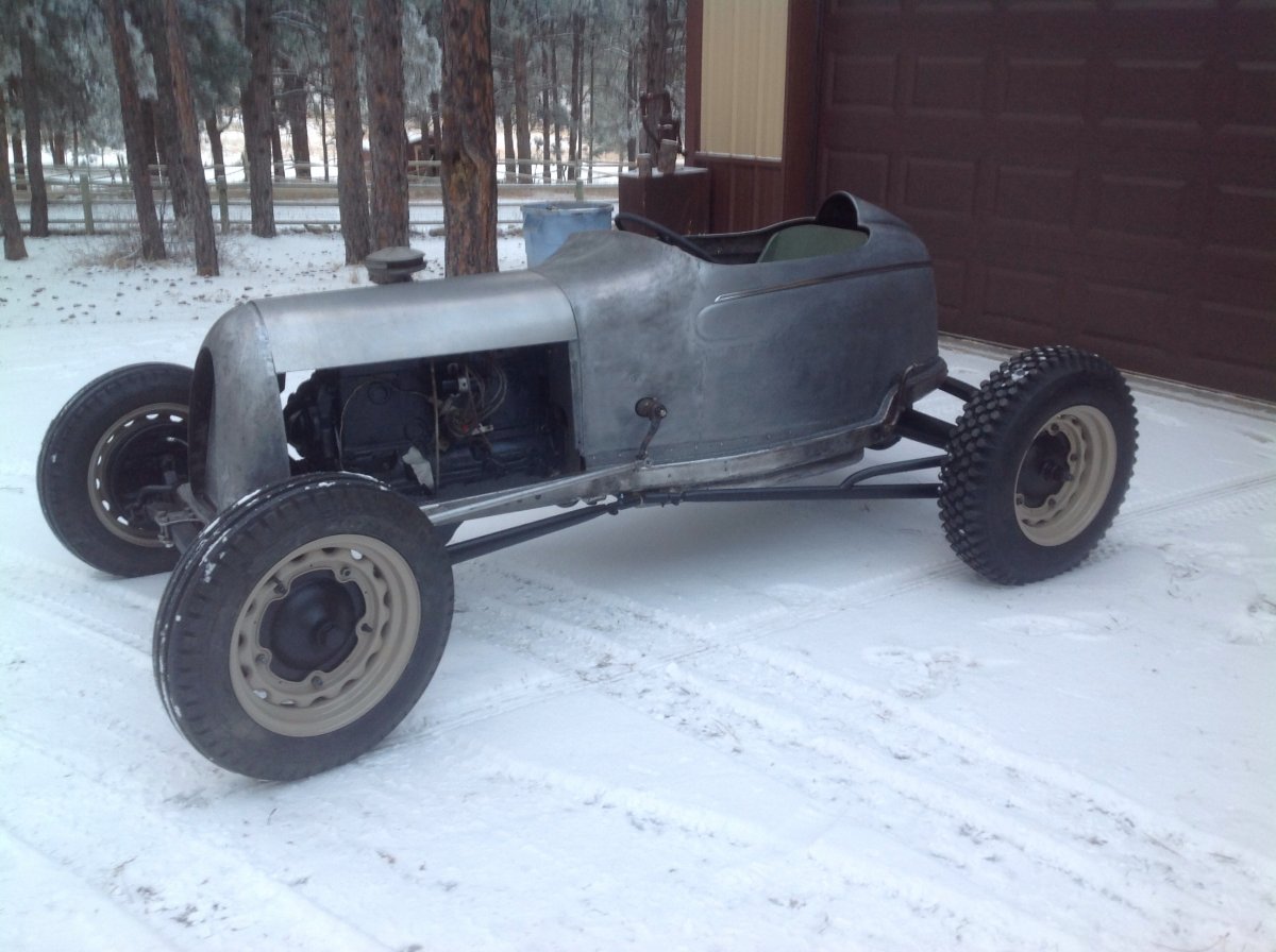

    93C97379-1103-4889-AADA-15D39E63D565.jpeg Looks very kool!! This is a picture of my single seater, I don’t know if I could get in it at 80 years old. You must be in fine shape sir.
    Jet96, AHotRod, aussie57wag and 4 others like this.

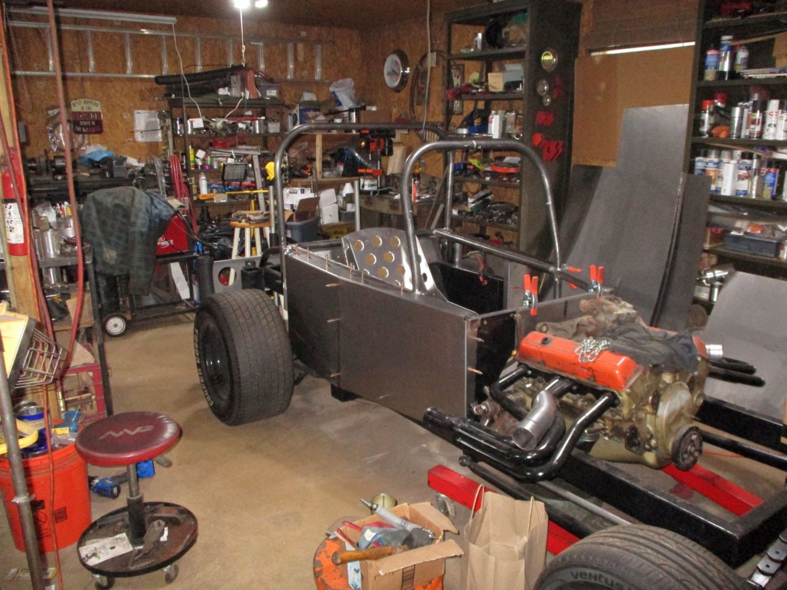

    Love the single seater. I have made a bit of progress lately. Started building body p***enger side. Having trouble creating compound curved sheet metal for the turtle deck/trunk lid and rear body enclosure behind rear roll bar verticals. But I blunder along anyway!
    AHotRod, Just Gary and bobss396 like this.

    Thanks for the kind words. I am tackling building the rear turtle deck and just did the p***enger side compound curve to form the shape transitioning from the slab sides to the rounded, sloped rear deck lid. I have to build some "structure" to support it all and to ***ure that both sides are more or less well matched and even in height and length. Had to cut a lot of slits that I will endeavor to TIG as best I can without warping the piece. That work is "not ready for prime time" yet, so pics will come a little later. You would not believe how rare sheet metal has become. I bought up what I could find 6 months ago and may have enough to complete the body. Same with the needed DOM tubing for a small amount of additional structural work. My supplier (before COVID) had a lot in their steel rack. Now their steel shop foreman told me that his supplier has stopped selling it and they cannot get it either. It is tough for local (here in Maine) racers to build ch***is too. Wow, I'm glad I seem to have most needed to ultimately get finished! I am moving very carefully and slowly to limit having to junk parts made too hurriedly. Anyway, on we go...albeit slowly.
    AHotRod likes this.
