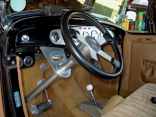

    The pic below covers two things -
    The ignition switch (Ford pickup circa 77-78 or so) mounted in the dash.
    I highly recommend putting it in the dash because if it's hung low on a panel access is too easy for the thieves and their hot wires.
    The only disadvantage I've found with it on the dash is you can't have a ring of keys hanging with the ignition key cuz it'll wear and scratch the dash.
    A single key on a small single ring works fine.
    Note as well the auxiliary gauge panel on bottom left.
    It's hung on a 1" square tubing cross brace.
    This could also be used for the ignition switch if preferred.
    Incidentally, new switches and lock plungers are still available for these switches.
    The switch is a late enough model that it uses the double sided key.
    You can't see it in the pic, but the aux panel is hung far enough back that toggle switches are installed in the longer than required horizontal part that runs from crossbrace toward the back.
    The toggles hang down and are easy to reach.
    Such a panel would help you keep your dash clean.
  13. Below is a pic showing the initial layout of an underdash panel I made.
    It's cut out of an electrical 'pass-through' box that's used to bring cables through a cement wall.
    They're about 2' long when uncut and as you can tell I've made quite a few panels with it.
    It's 3/16" thick and the ones I've dealt with will finish up nice. Buffed or brushed.
    The one shown is powdered, but paint & primer works fine.
    The panel shown laid out is as mentioned for under a dash, but to make the deeper panel you go back approx to the two small holes just above the panel so you'll have the longer horizontal run for mounting.
    Not shown in the pic is a cast in rib on the inside that makes for a good locating device when the panel is hung from the 1" square tubing crossbar.
    As long as the aux panel is in my 32, it doesn't vibrate.
    Make the horizontal run long enough to clear the mounting surface - dash or square tubing - so your toggle switches will fit.
    (Make a point to buy DC rated toggle switches - AC rated toggles don't last long in a DC environment. That's because a DC arc is harder to break than an AC arc.)
    Another nice part with using these aluminum boxes for dash panels is you can make very long ones.
    I made one that took four 2 1/8" gauges, a big pushbutton for the winch as well as ten switches, eight pilot lights and nine panel fuses for a 4 x 4 I had.
