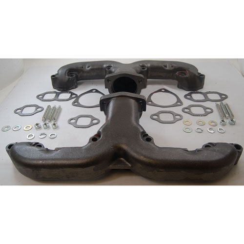

    Hi all,
    Looking at getting a pair of the repro SBC exhaust manifolds sold by JEGS and others on EBay for my wife's '46 Tudor. They are the 2-1/2" "Rams Horn" style without the accessory attachments at each end.
    Has anyone had any bad (or good) experience with them please, ie. do they crack or distort etc, this car will be driven regularly.
    Thanks.

    The specific ones I'm interested in are RPC brand (Racing Power Company, see my earlier attached photo) and are being sold on EBay and at JEGS in the $90 - $130 range. These ones are without accessory attachments which suits me anyway, I was really looking to see if anyone has had any bad experiences with this particular brand.
    I've also seen the Dorman versions too, these will need trimming and aren't as "clean looking" as the RPC ones.
    Thanks for your help.
