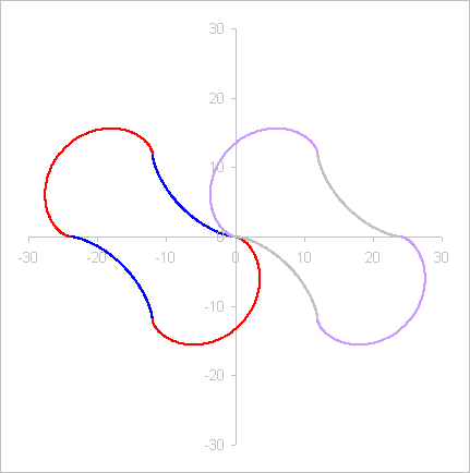

    I found this on the Ford Barn, SCOT rotor to case clearance is not adjustable like GM blowers
    It's a straight two lobe design.
