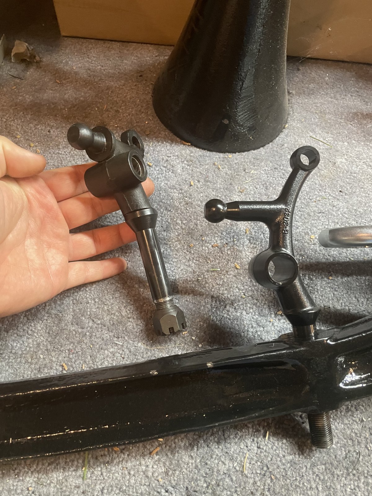

    I bought a set of model a reproduction perch pins that look identical to the one sold by Macs autoparts, however the shank does not fit my 1932-1936 axle. I have a 1932 bob drake perch pin that fits well. The model a reproduction pin seems to be oversized by .003” on diameter.
    Is this normal to have to chuck the part up between lathe centers and turn the O.d.? I guess in the end I didn’t save any money going with the cheapest set.

    An A perch should be the exact same diameter on the shank as any other perch through 1948. Different lengths and top configurations, but the shank should be the same.
    If I was shopping for a new perch I'd make damn sure they were forged, not cast. Usually the cheapos are cast.

    it would have been helpful if someone had the dimensional difference between a model a perch axle hole and that of a 32-36. I doubt that ford would have a reason to change them.
    and in this hobby parts are interchanged quite regularly. I’m using a model a frame with houdaile shocks so why would I not choose model a perches.

    thanks!! That all I needed to know. The set of pins I bought on eBay are forged and they look like a nice product. The seller said they were surplus, he’s sold many sets, maybe I just got that set that slipped through sample inspection. I’ll turn the o.d. Down to match the bob drake set that I bought prior.

    I see your axle is nice and shiny. Could the perch hole have paint buildup in there?

    No it is clean. I used a pencil grinder with a scotch pad to clean it. I also measured the pin with a micrometer. Its definitely .003” larger on diameter than the bobdrake pin that fits
