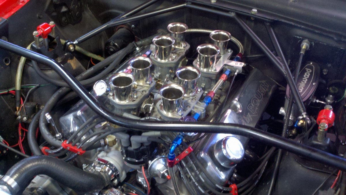

  10. These are the 44 IDF's I'm running
    big duece and rooman like this.

    What intake manifold are you using?

  13. I bought it from a Mustang specialty shop - It was New Old Stock, they had it at least 30 years, brand unknown. not the same as the Redline one, but close

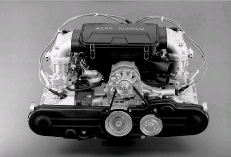

  21. The Alfasud (as mentioned above) was a boxer with down drafts
    Ned Ludd likes this.

    ah, ok. Never even seen one before. This is what I think of when I think Alfa.
