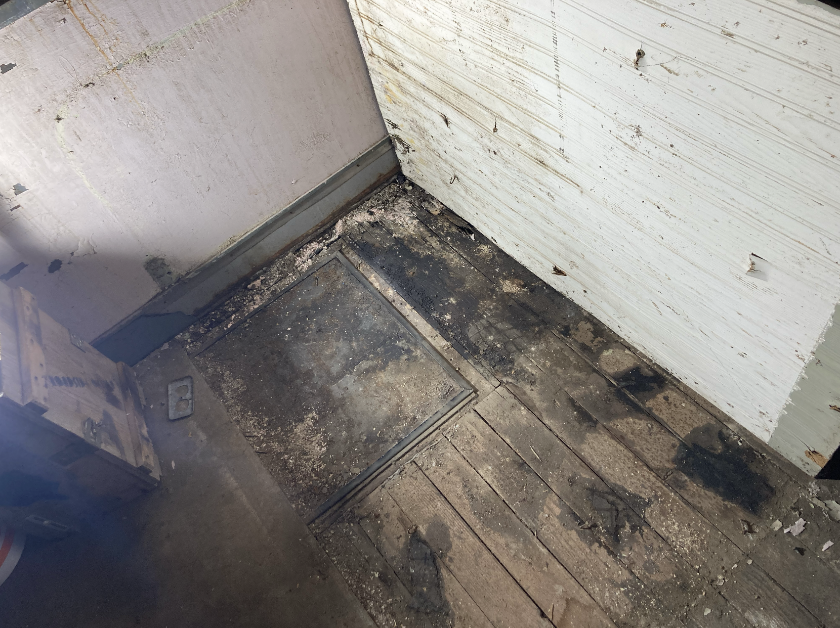

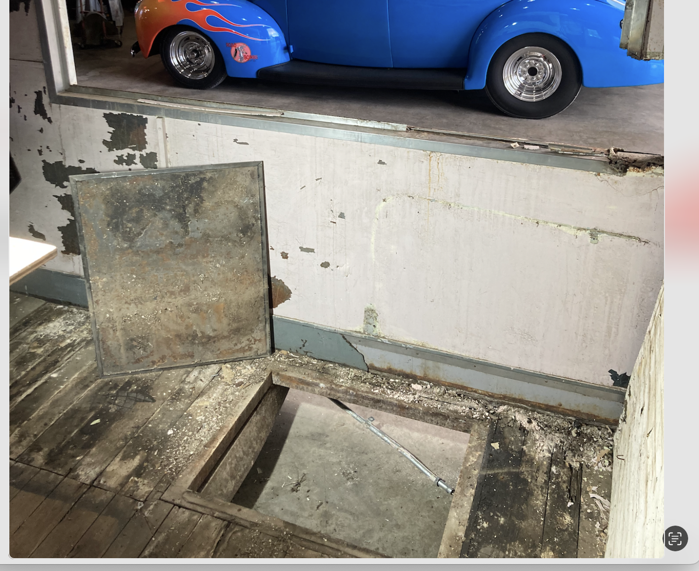

    Felt great to finally spend some time on hands-on restoration instead of just research. I started cleaning the walk-up window wall and front corner. At some point during its time in Winfield, KS, the front gl*** was cut and the window frame was torched out to install a window A/C unit. The wiring for that setup was also piped to the front — all of which needed to go.
    Next, I decided to pull up the plywood under the front windows. There had been a loud metal clank every time I walked over that area, and I ***umed the floor or support beams had rusted out or collapsed delaying progress. Turned out I got pretty lucky — underneath the mess, I found a trap or access door in the floor! That instantly reminded me of a poor scan of a salesman’s brochure showing an outline in that exact location. I believe it was for water or gas shut-off access. Apparently, it didn’t last beyond the first builds; I even found a construction photo of a later model showing the same hatch. The hatch cover itself was the source of the noise. There was also some stainless trim that once bordered the opening. A cool find — though I’m not sure if I’ll replace it or just remove it and floor over the space.
    I also noticed one support beam was bent but still secure. The top is flat, and the welds are holding. I spotted some shiny marks underneath and realized that’s likely where chains were hooked to drag it off its foundation during salvage. Definitely repairable

  25. Squablow
    Joined: Apr 26, 2005
    Posts: 18,498
    Squablow
    I wouldn't blame you for flooring over the little trap door if you do, but it is kind of a neat little detail that's original, and yours might be the only surviving one to still have it, it might be worth keeping it, even if it's not super functional anymore.
