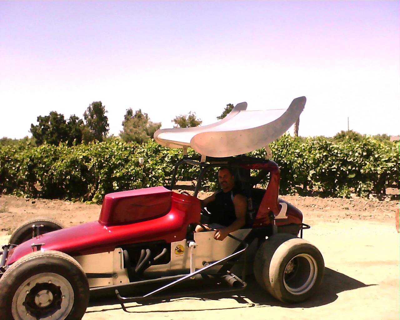

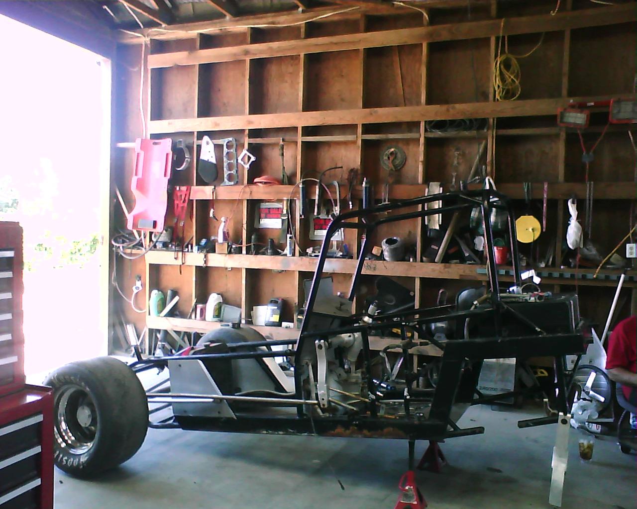

    So my buddy finds this old San Jose Super in a field and talked the guy into trading for his Sprint Car. This ol' car had been in that field on and off for around 15 years. I say on and off 'cause the guy would, every few years bring the car in, sandblast the frame, paint the body........and then push it back outside. So, it's in pretty good shape for something that's been sitting that long. These cars are making somewhat of a comeback down here in the Valley and there was an exiibition at Madera a couple weeks back. 11 cars showed with maybe 10 more coming out for the next one, July 24 at Chowchilla which means this car is not in a restoration mode. It's more like, wegotamonthandwe'regoin'fuckin'racin'!! :D The brakes were locked up so we had to drag it on the trailer and by the time we got it off we just kinda stood around and checked it out. I'll post pics as we go so here's some from day one.

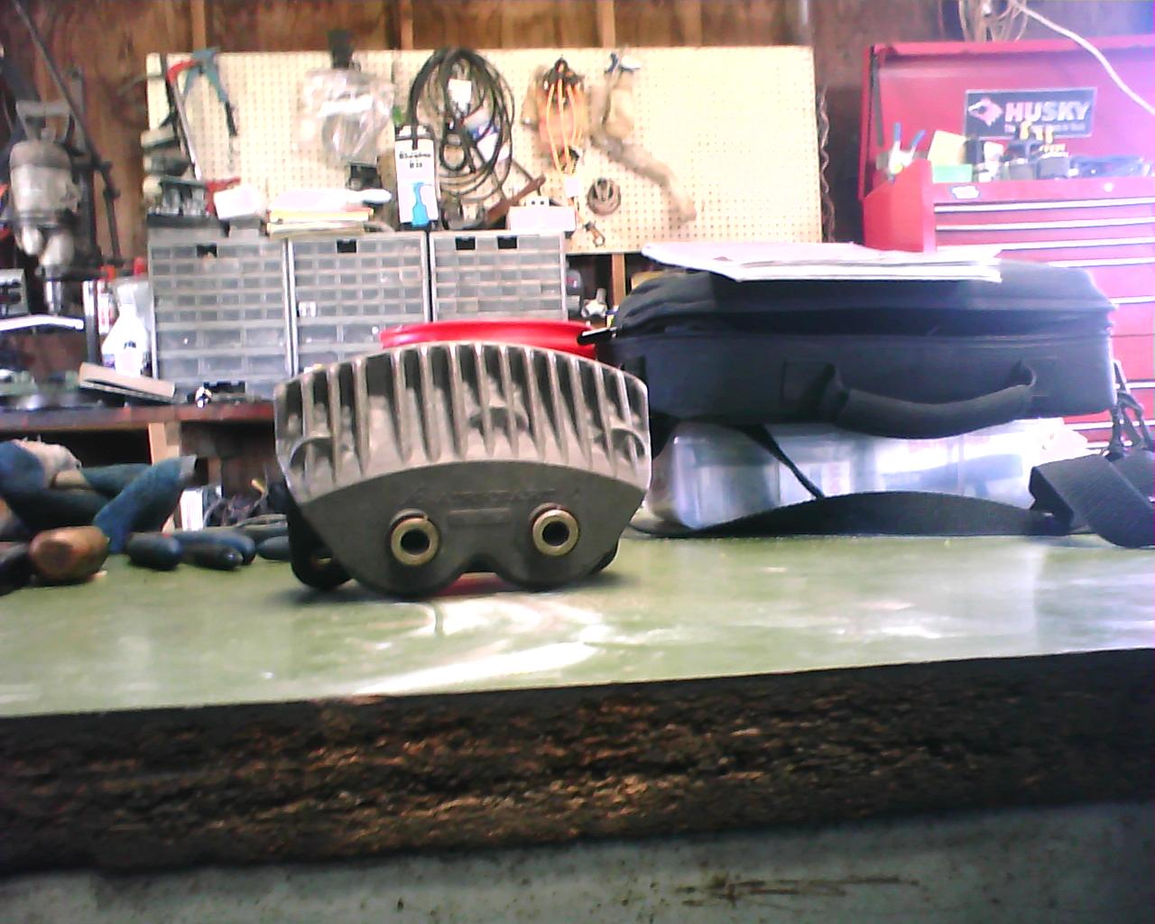

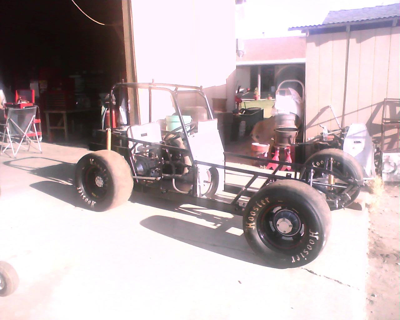

    Day 2. Pried the Calipers off it. Whadda know, IT ROLLS!!:eek: About 45 minutes with the steam cleaner and it became more apparent that this is a good find. Pulled the Rad. cap, clean as a whistle inside. New fuel cell that hasn't been out there too long and looks great. The body is cherry, the side panels and tail are hand formed aluminum and believe it's a Bob Allinger piece. The hood is glass and there's not a nick to be found anywhere. The previous owner is a real good body man and he painted it candy apple red before he pushed it outside. It's faded but a little elbow grease and a paint gun........Shocks are a different story,we chucked 'em all but Joe has plenty of good steel shocks. We all know what happens to aluminum calipers when they set for years with brake fluid in them so it was no suprise that they are pretty bad. They are however ol' school Airhearts and Joe would like to use them so I called Airheart and was told I needed to send pics so they can tell what they are. Did so and I hope to hear back from them Monday. All in all, it was a good day 2.

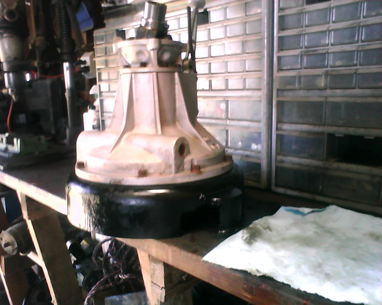

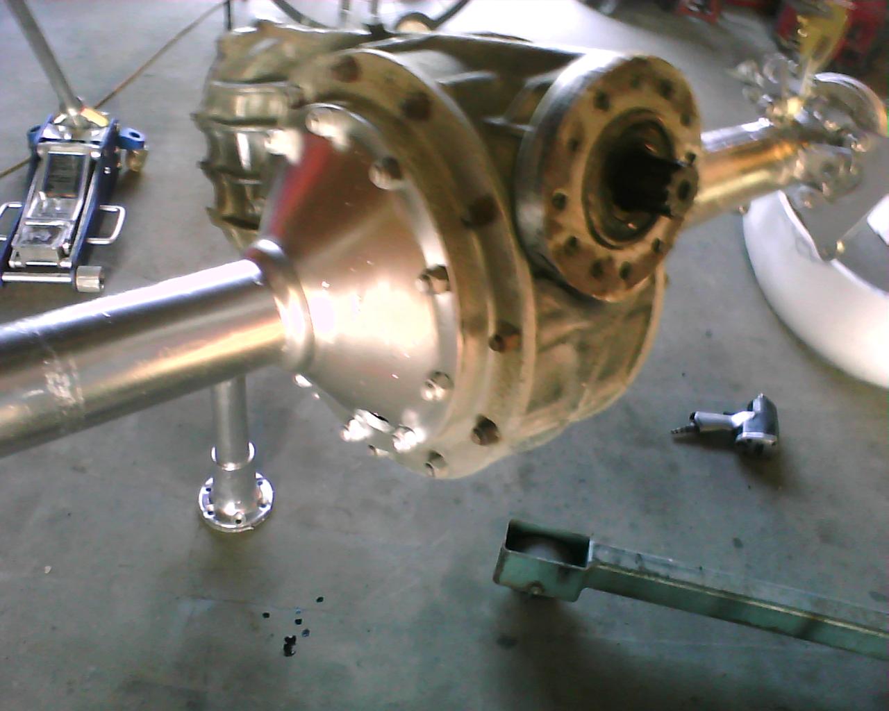

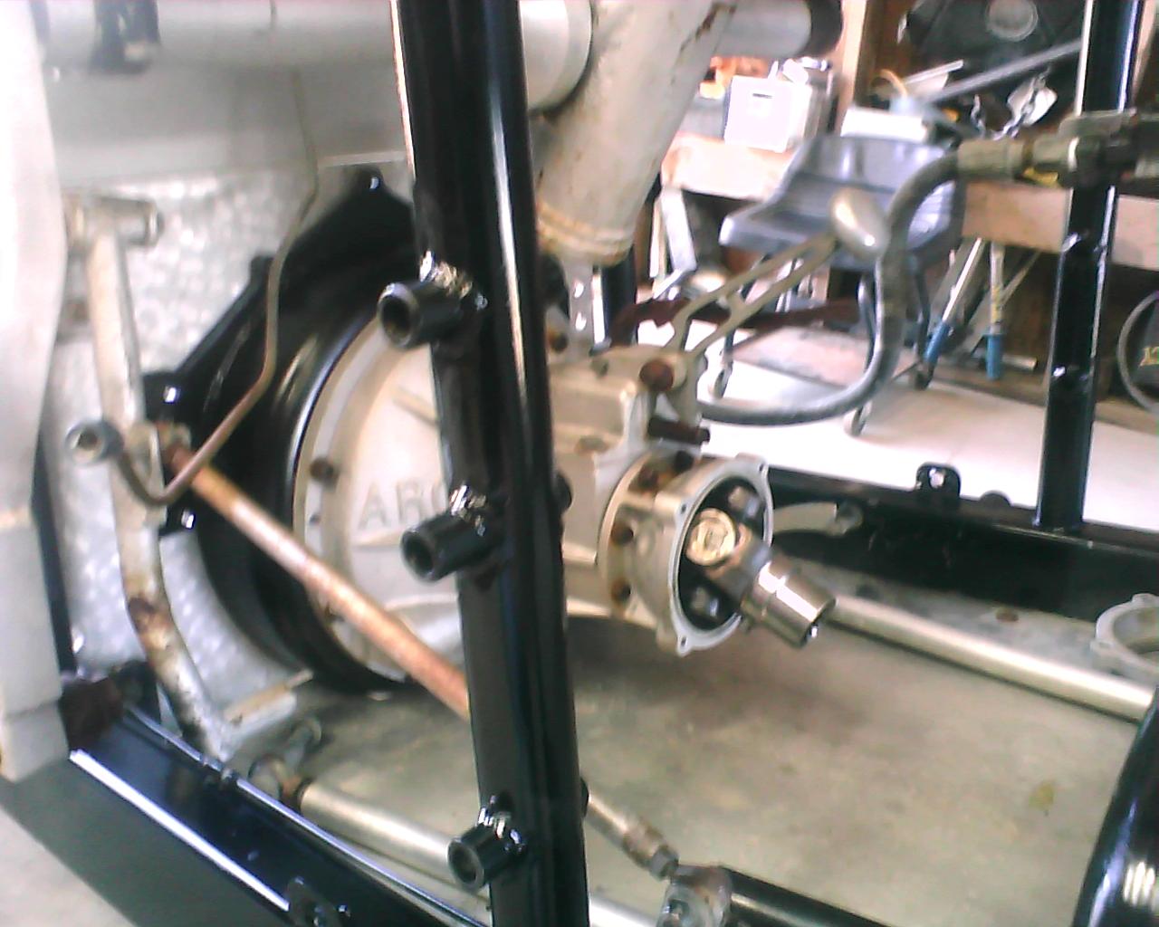

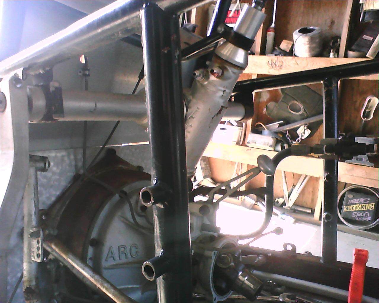

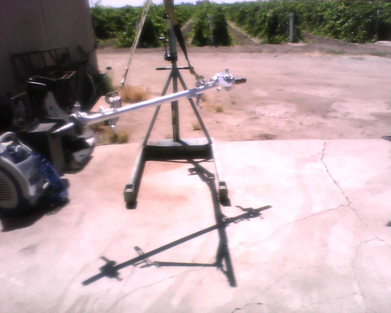

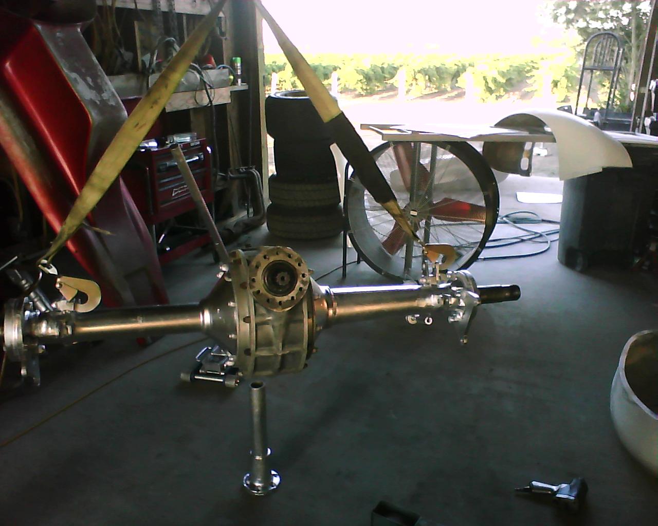

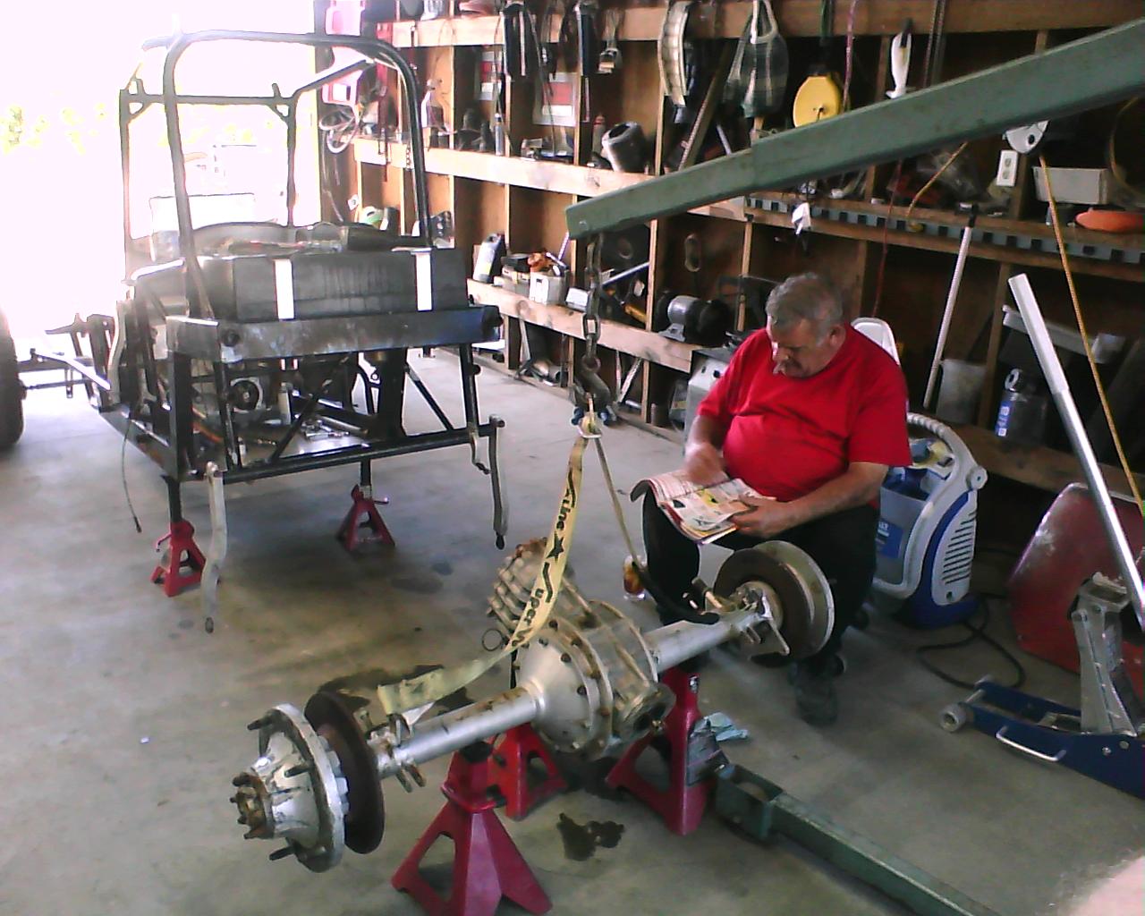

    Day 3, Out with the Q/C, Pulled the cover and found a gear set, but no top spacer. Joe thinks he's got one in another Q/C. Checked the pinion shaft and Joe was happy with the lash. He's done that a few times, I'm sure he's right. We pulled the hubs off and the bearings look like new!!
    I hand packed them while Joe painted the axle housings, hubs, tourque tube and ball. On the eighth day God created KRYLON:D No powder coating here. He also spray bombed the back part of the frame, looks great!! We also pulled the in and out box. Tight as a drum and there's a new U-Joint. Tomorrow, we'll put it all back in

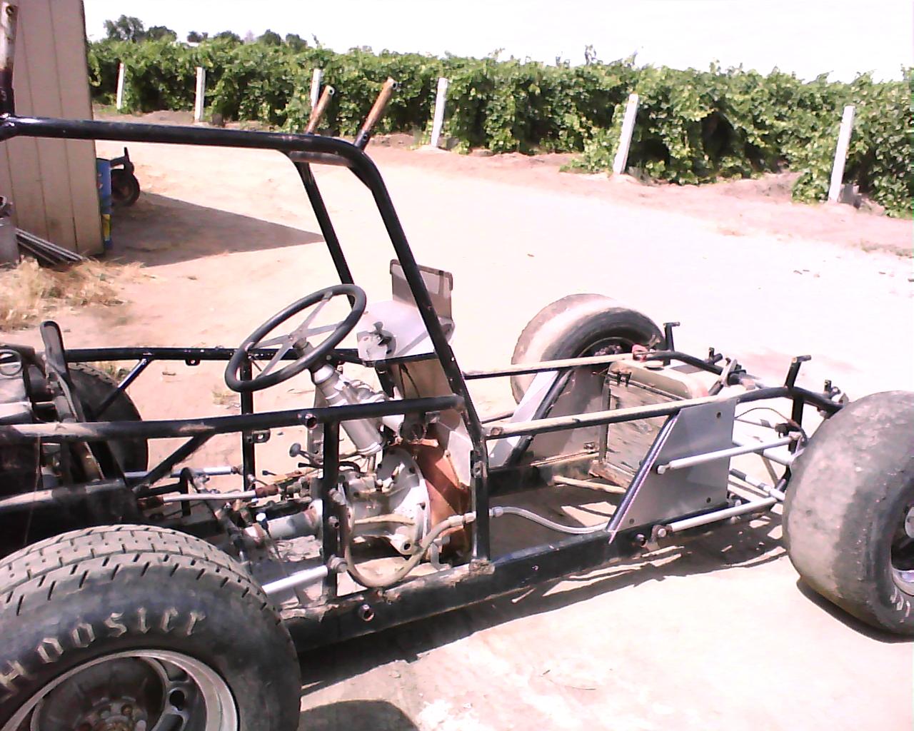

    Looks great Louie, but ya need to put 'er on the track bro'.....lol. BTW, you're a good artist. Joe's car is around an '81 Sargent. We think it was Marks Car #14 but not sure. Mike's #7 wing is still out in the field along with a couple of identical frames.

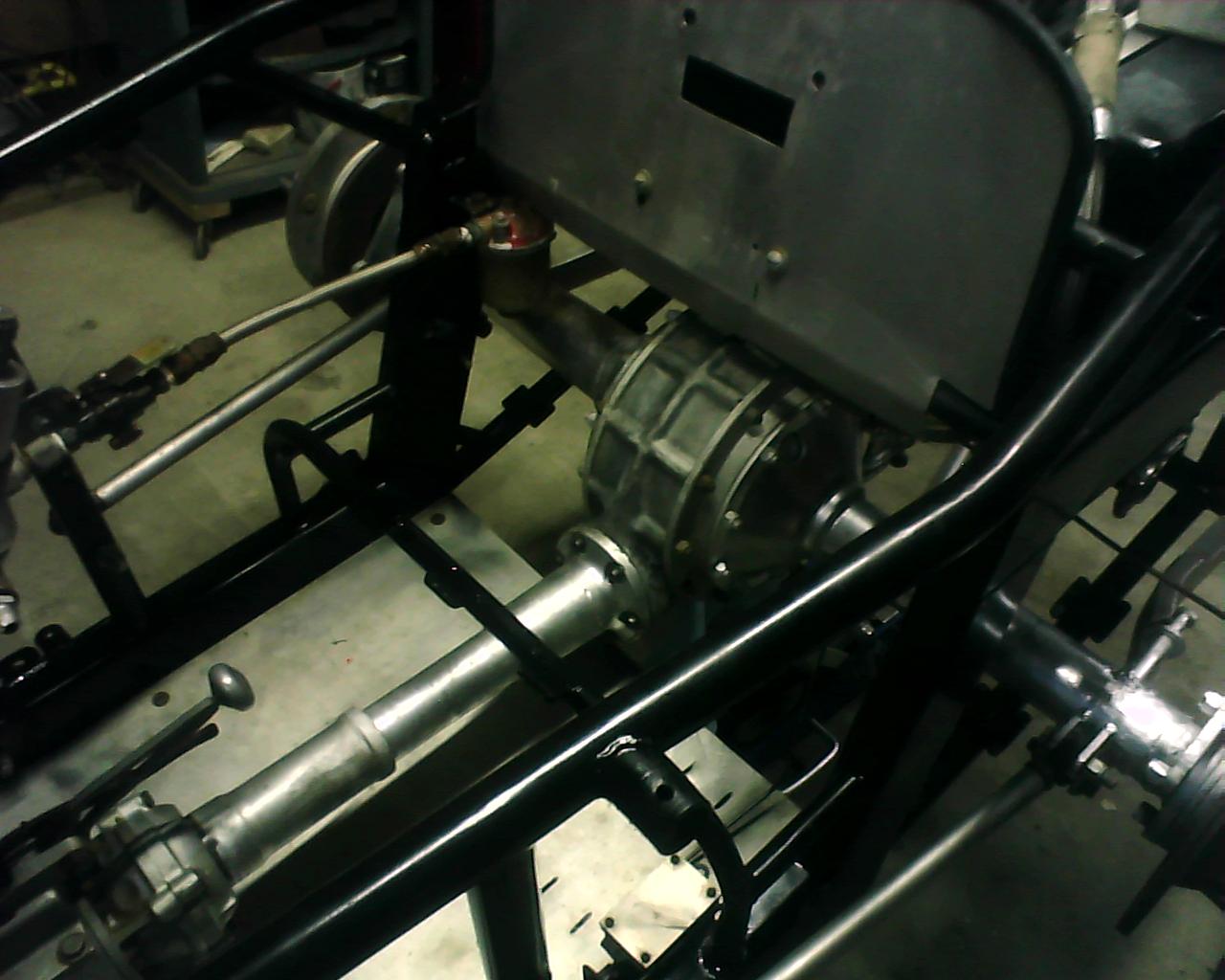

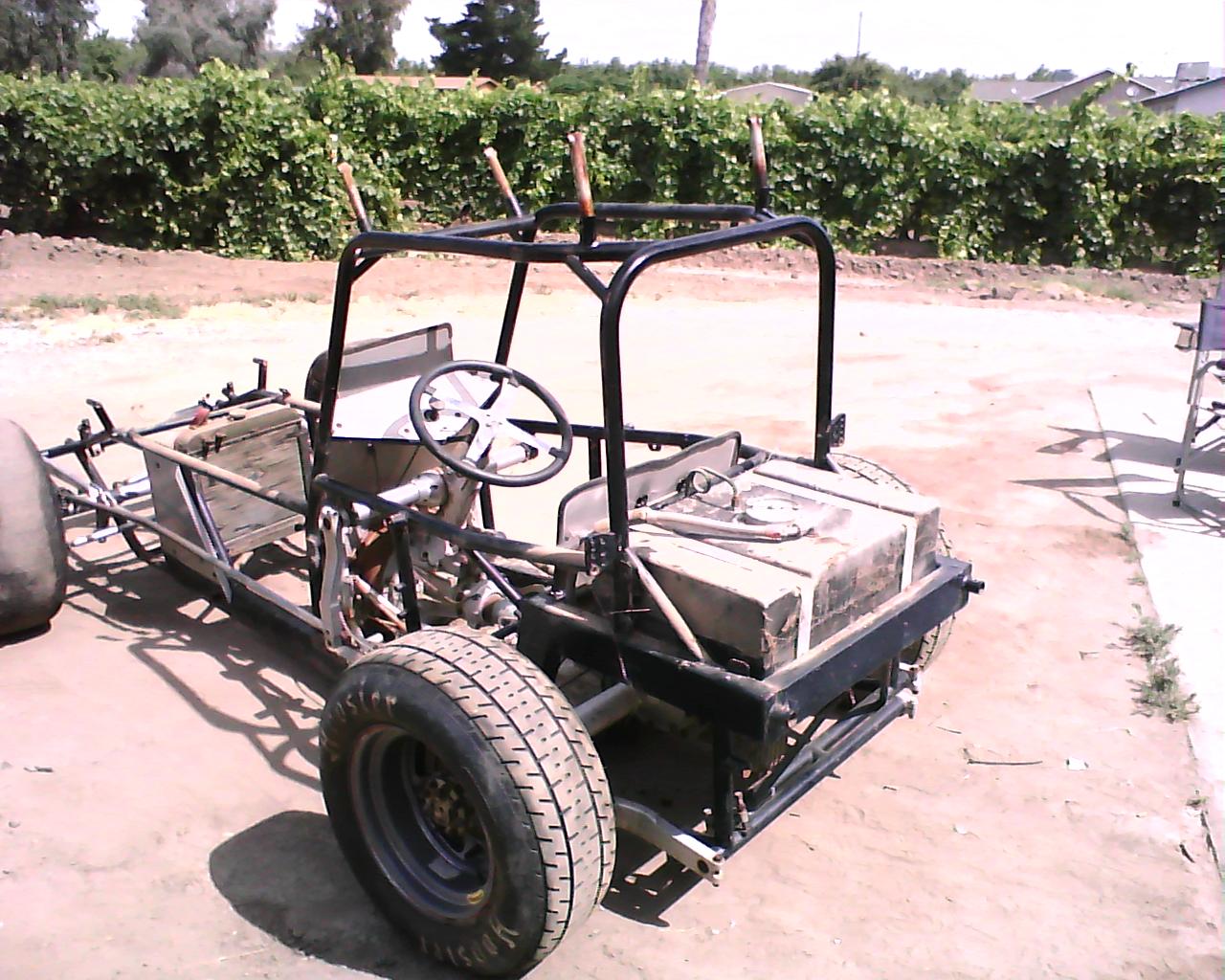

    Day 4, Drivetrain goes back in. We cleaned up the torque ball and tube, greased them up and in they went. Pretty easy,just the usual pushin'/shovin' ect but everything bolted up fine. Had to adjust the torsion arms a bit but everything is pretty free. For some unknown reason,the previous owner cut off the Jacobs Ladder mounts. No clue as to why and he didn't know but we got the ladder and that should get done this week.
    Put the rear hubs back on and the axles in and the drivetrain's pretty much done. Tomorrow,we do the front end.

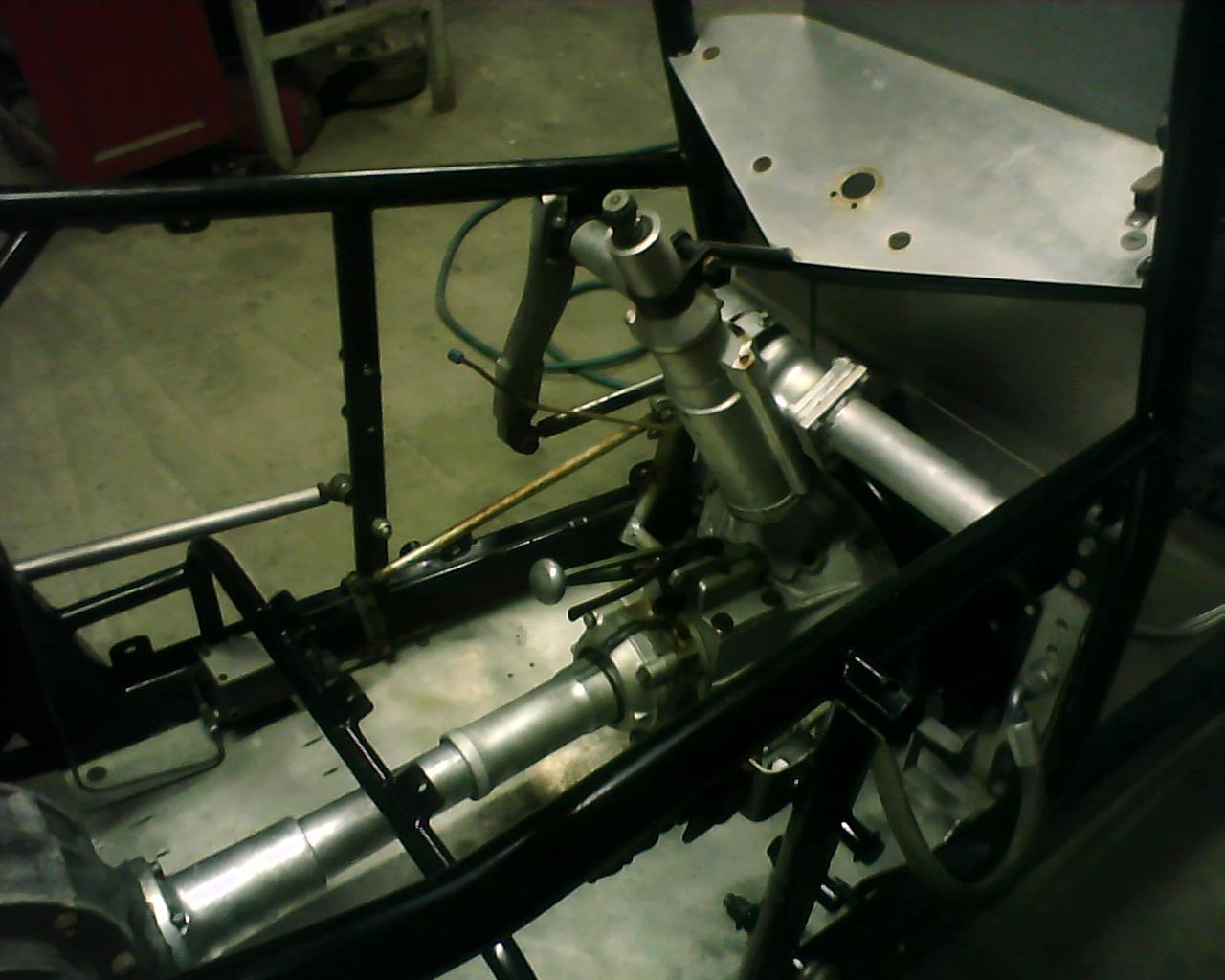

    Day 5. 103 Degrees in Chowchilla......ugh. So things slowed up a little but we still got the front end off and painted, cleaned up the radius rods, tie rod and drag link. Another hot day tomorrow but we hope to get it on all fours. Somehow some pics got deleted, musta been the heat......:confused:

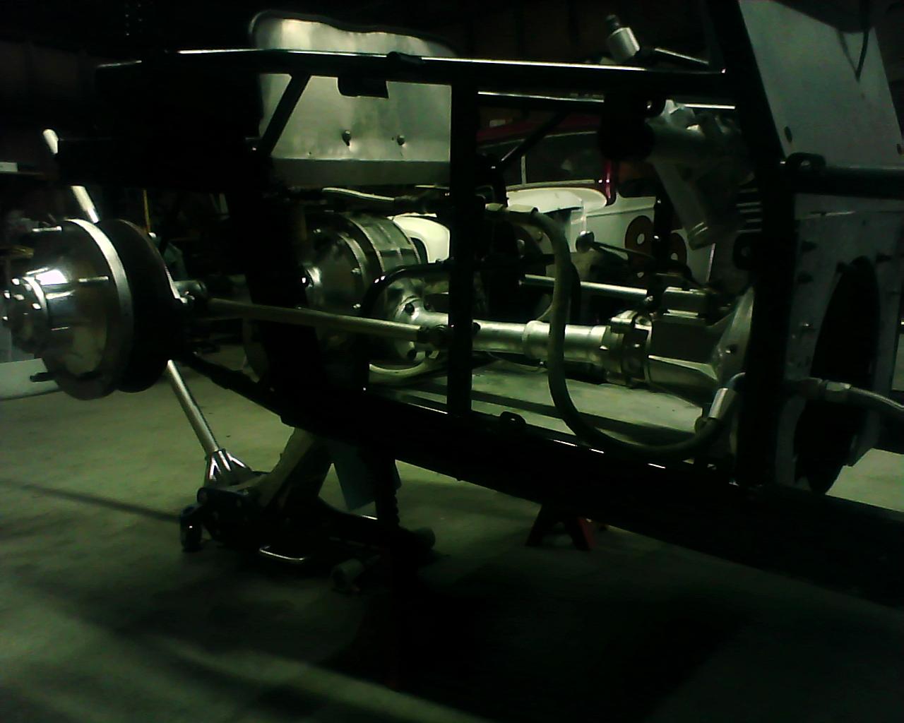

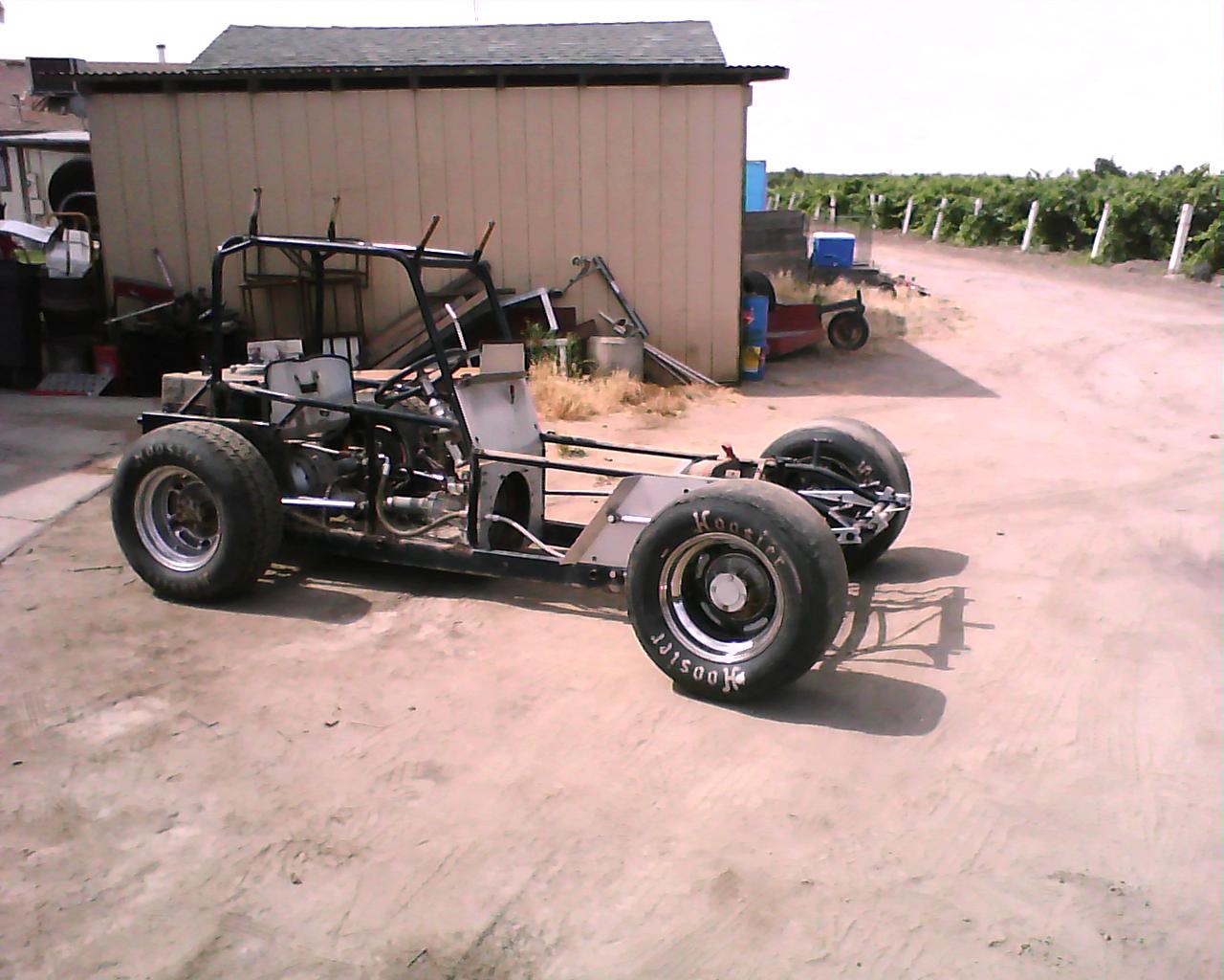

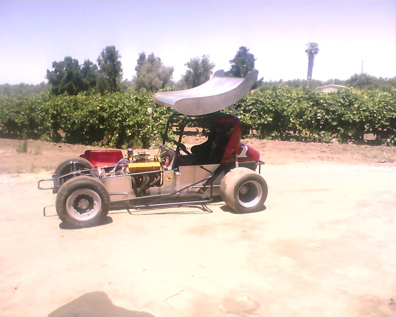

    Day 6. Still Hot!!! Got it back on all fours, set the bars where we thought was close,went inside the AIR CONDITIONED house:D and drank lots of ICED:D tea.Next up is stabbing the bullet and we have some parts on order. But there may be another racecar showin' up. Stay tuned.........

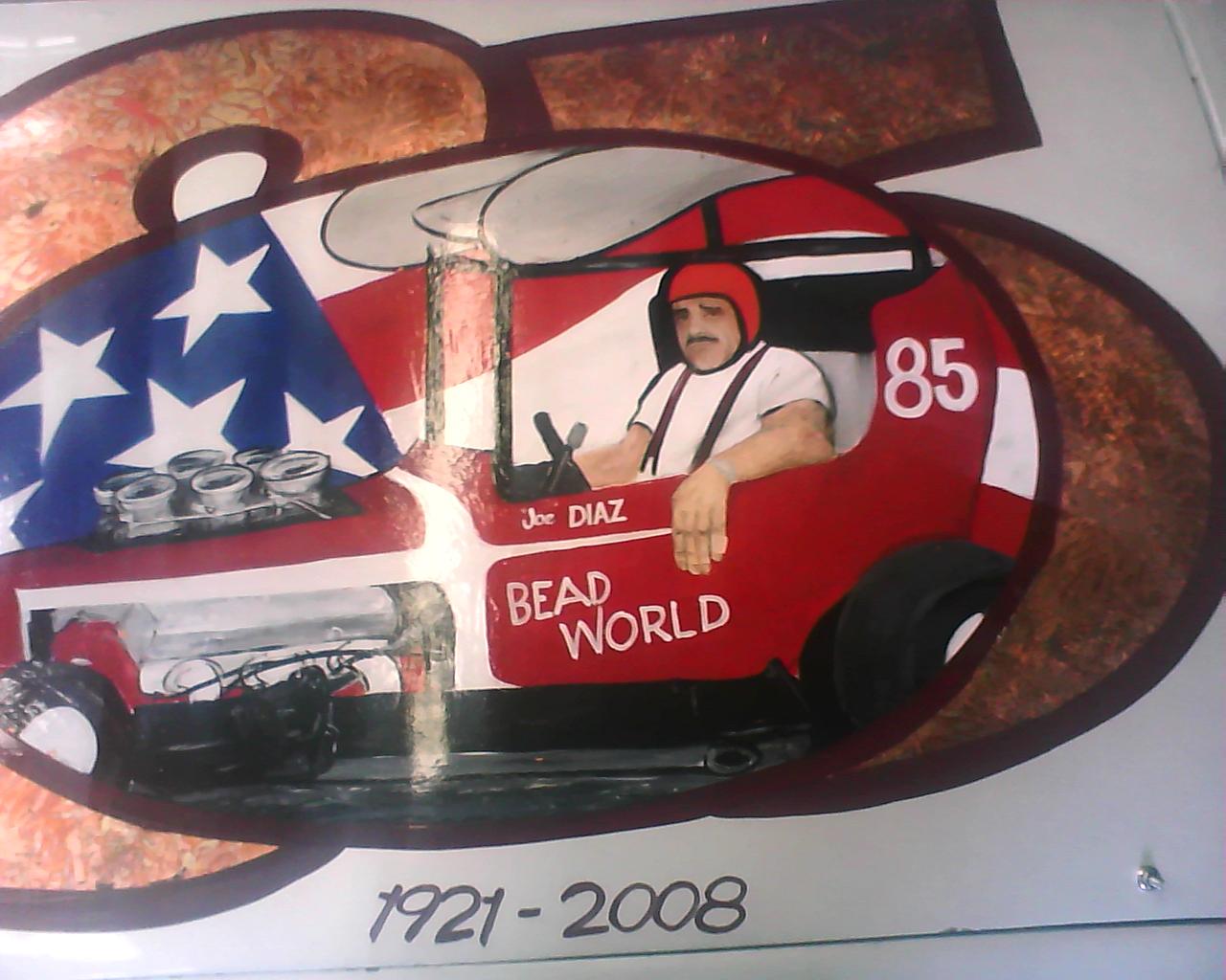

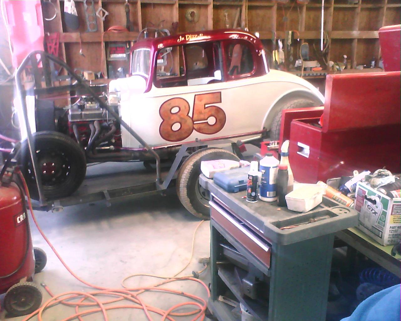

    Day 7. We hit a snag,but a very cool one. Joe's son,Joey WAS the proud owner of a 34 Chev Jalopy. Another buddy of mine, Bob Filippi WAS the proud owner of a 1975 Tognotti 4-Bar Super. I'll bet you can fill in the blanks:cool: So I got some pics of the Super and the Deck lid of the '34. The painting on the back is Joe's Dad, Joe Diaz Sr. It was painted from a picture taken at San Jose in the mid 60's. It and the rest of the car was hand lettered by Joe's longtime friend Bob Walls. That's the best about what we all do. Our Hobby/Passion/Way of life forms bonds and TRUE freindships that last a lifetime.
